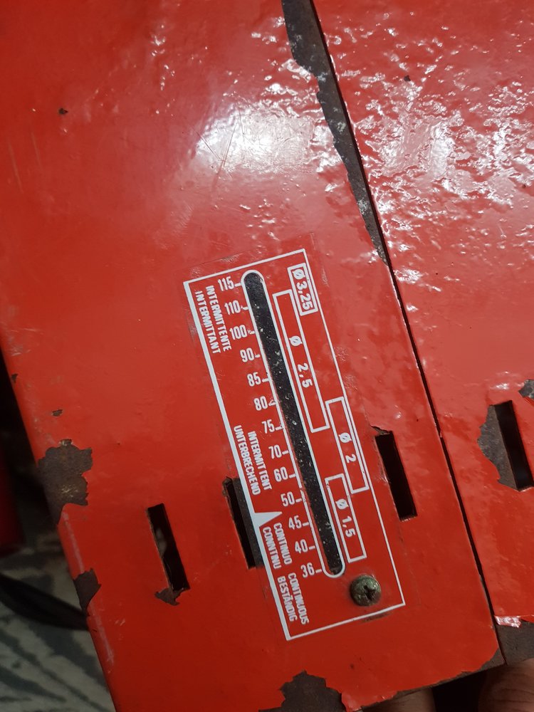

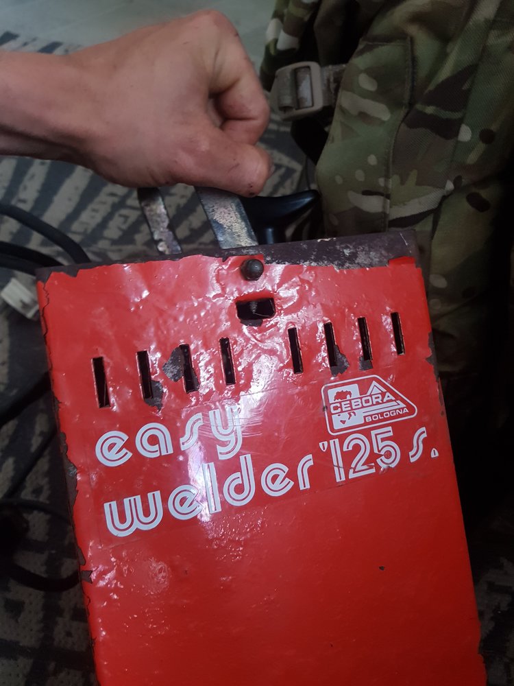

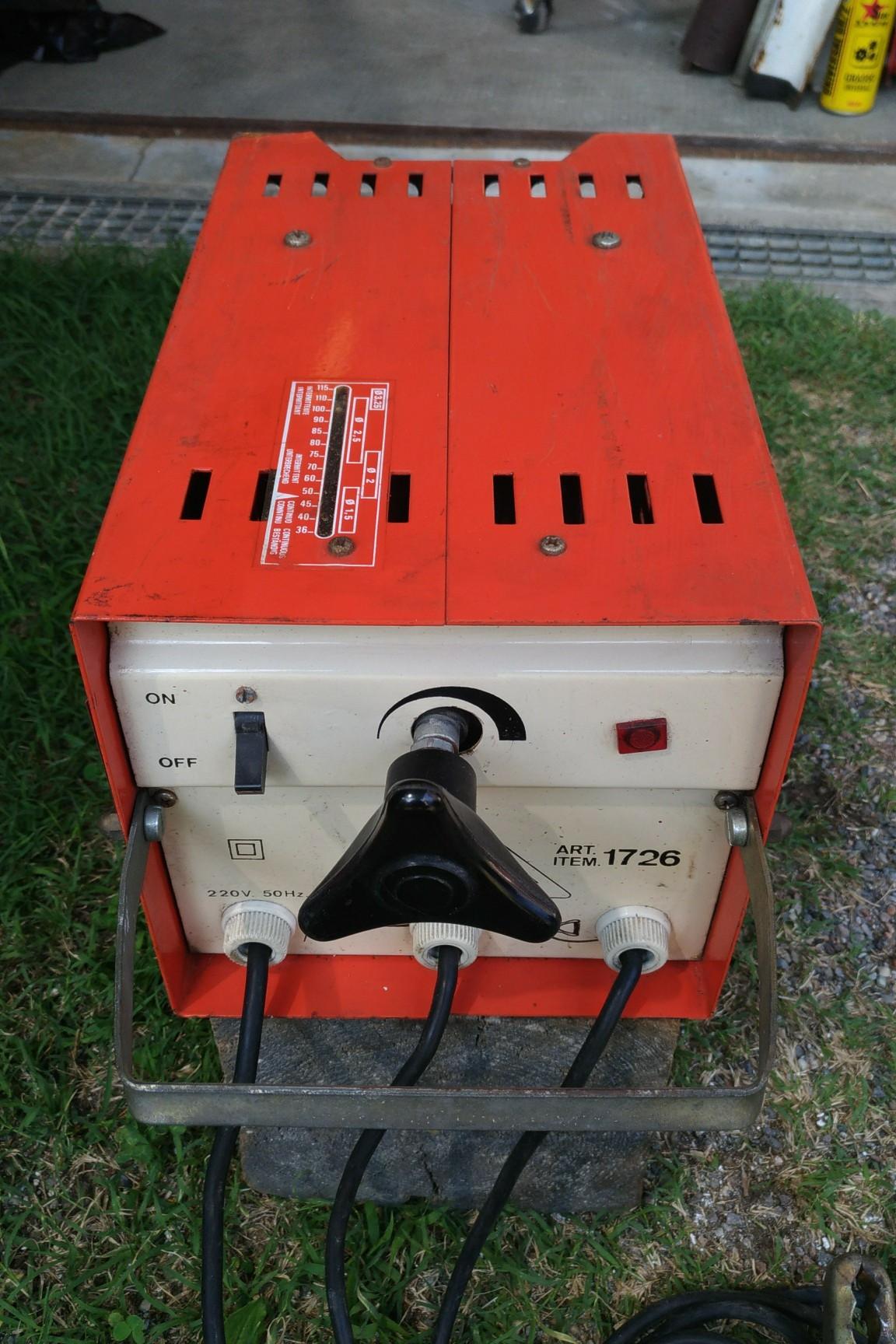

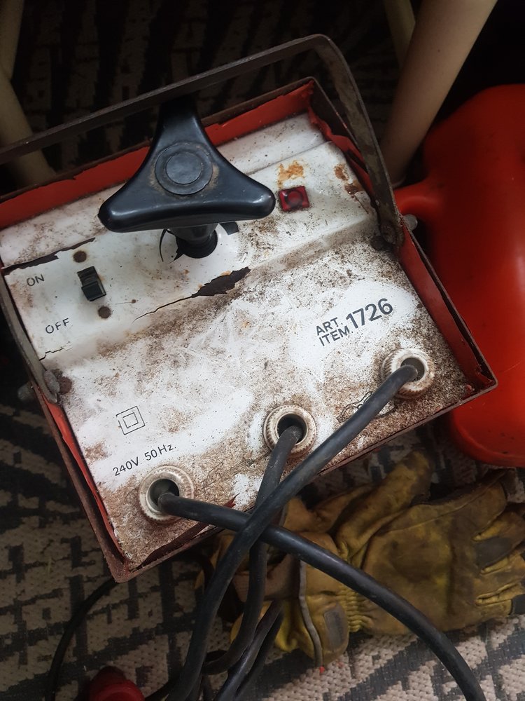

Quite a simple ask realy what is this machine how good is it/ can it be and anything i need to watch out for when using it. I cant seem to find alot of info on this machine anywhere can anyone help. For reminder it is a cebora easy welder 125 s
Cheers do you any more as that shpock add is all i could find online about it tooYes, it is an air-cooled arc welder with AC output, also known as a "buzz box".
It has 50 volts AC output, adjustable from 36 to 115 Amps, suitable for electrodes ( arc welding rods ) up to 3.25mm diameter.
