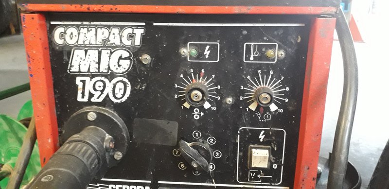

I own an old Cebora Compact Mig 190 (3-phase; art. 833) bought for peanuts some time ago.
Not so good looking but runs well.
Both buttons missed their round covers, and I thought it would be nice to find replacement ones.

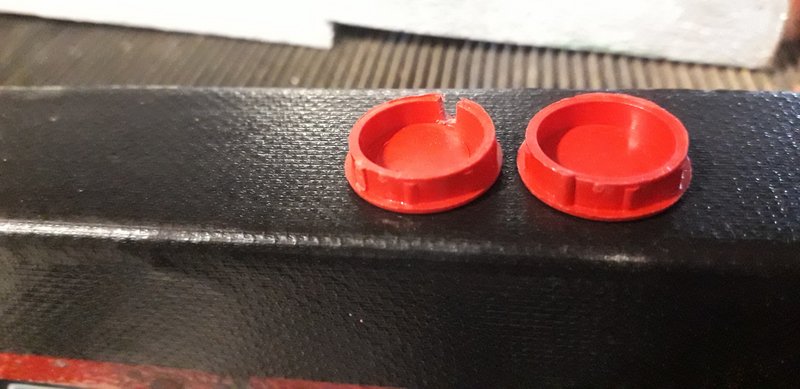

Hopefully, browsing the Net brought me to theses references : DK21R and DK28R.
Seder Group, sold by Velleman and other reseller, quite cheap.
Arrows (in case of) wear reference PL21R and PL28R, but I ordered only the covers.

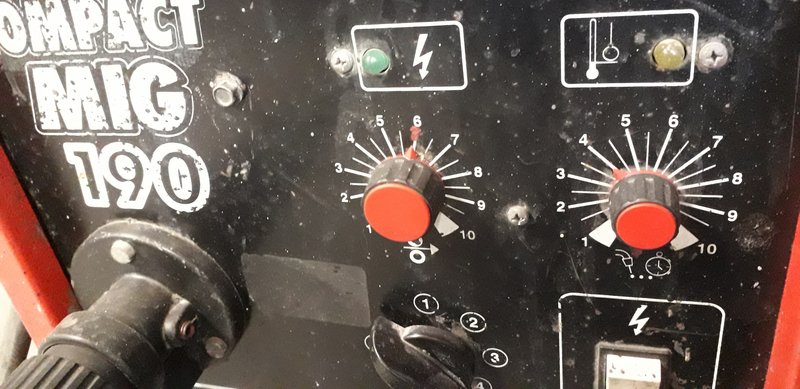

It was not a direct fit, I needed to cut a notch and reduce the .... well, check the pictures !!!!
Now, it fits perfectly and wouldn't fall easily !
