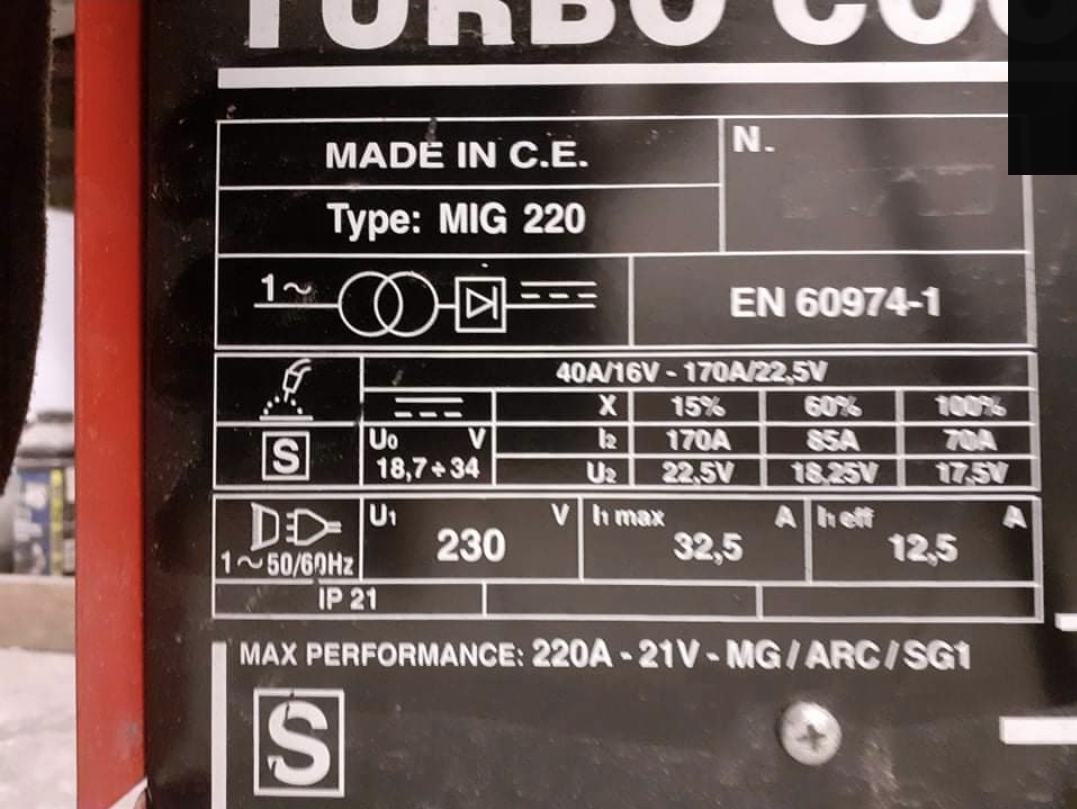

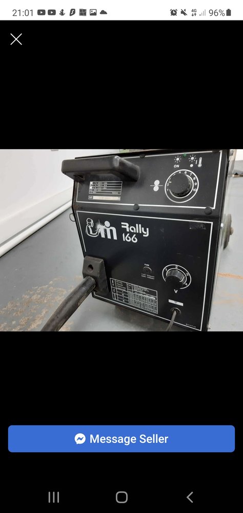

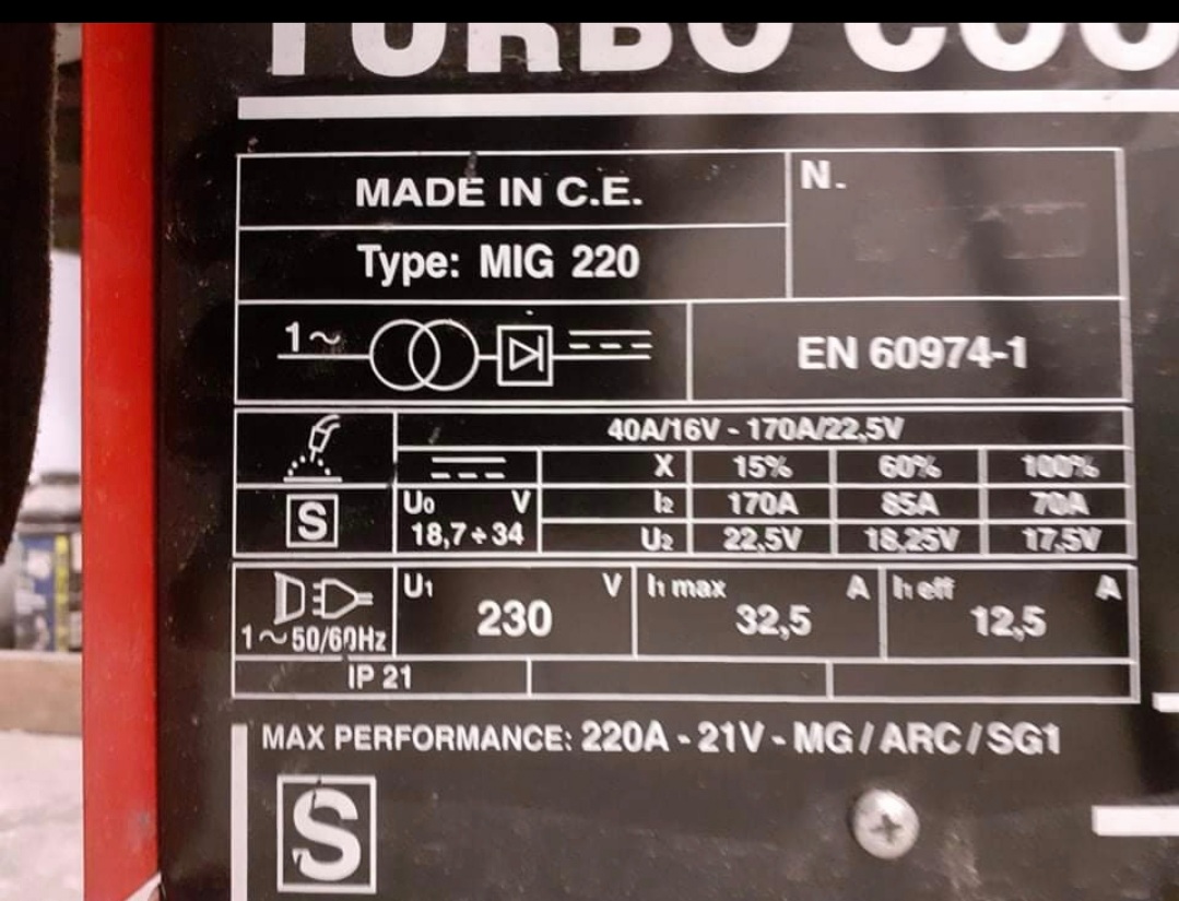

Yes im unsure which. The cebora is more powerfulcebora welders do weld nicely , well any of the ones Ive used do . Ive never tried a migatronic though .
Many thanks. No they are both heavy transformer types. The migatronic is the rally 161 but older one not inverterIs the Migatronic that you have been offered the Rallymig 161i ?
If so, then it is a small, light, modern multi-process inverter, quite different to the traditional transformer-based Cebora.
The small size and light weight and MMA ( Arc ) function of the Migatronic may be advantages for you. The downside may be the method of control - digital push-button synergic menus, and also the chance that if it fails, the complex modern electronics will be costly or impossible to repair.
