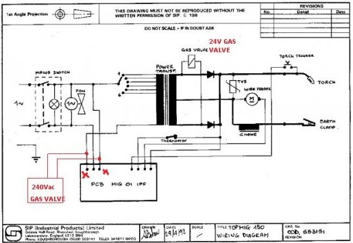

Sip topmig 150 turbo.
Looking on the schematics the only rectification I can see is in the PCB board.
Secondly I've read that first there was smaw and gtaw and gmaw came later and originally used a constant current power supply, it was until later the they realised CV was better.
So is this mig CC AC?
Regards
