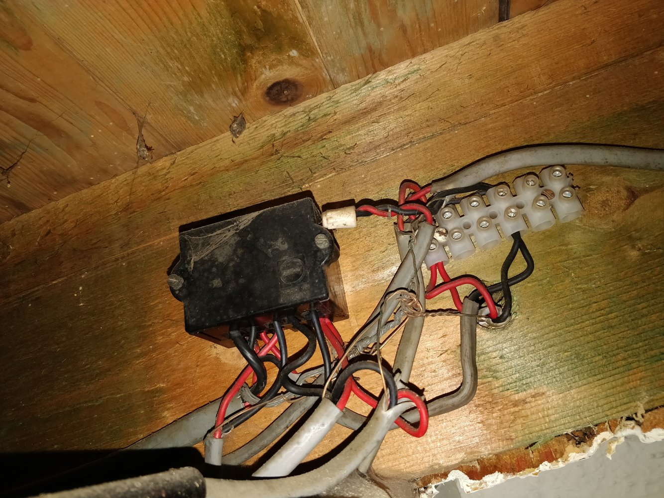

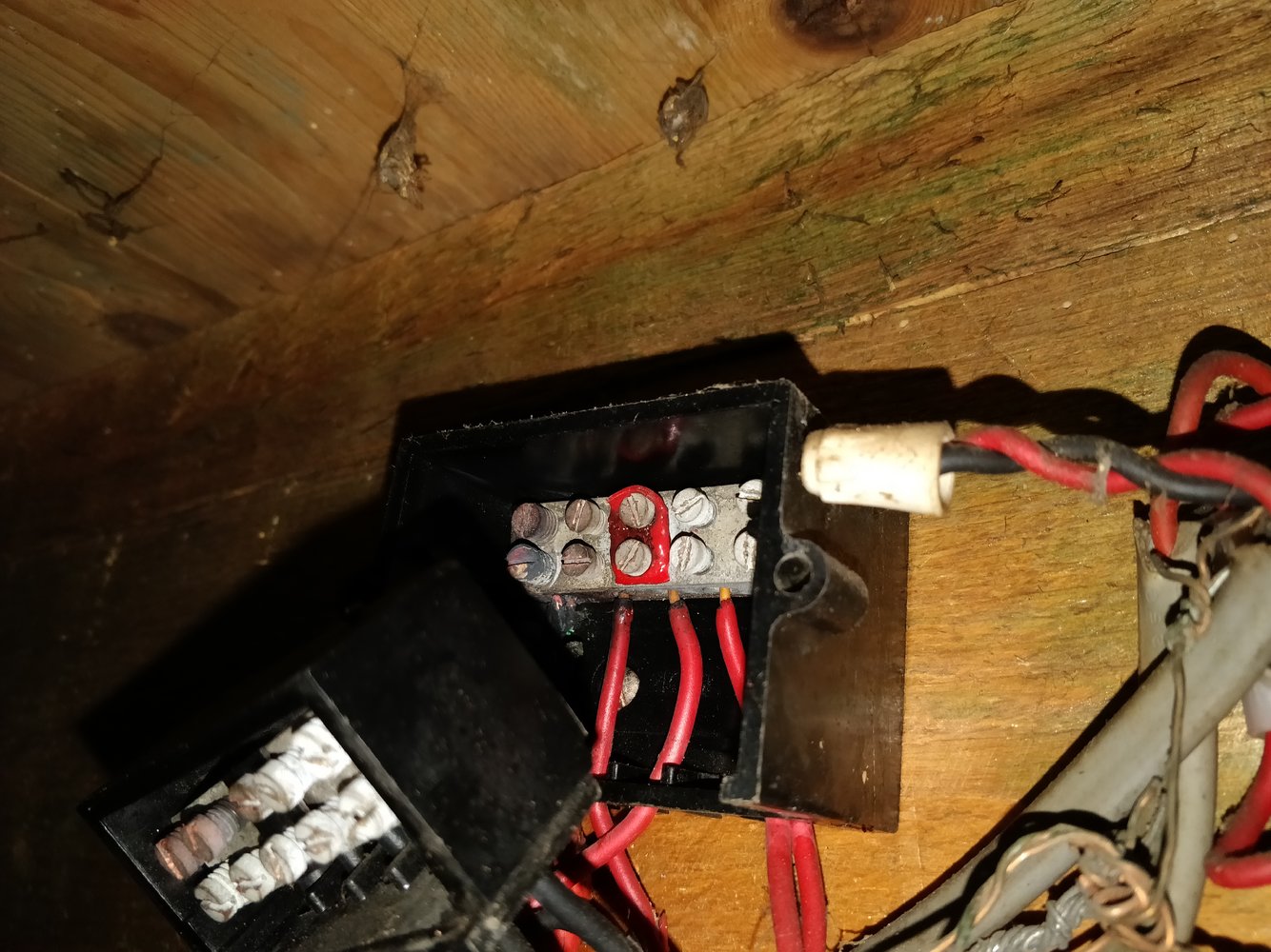

Previous owner of daughters terraced house was a bodge expert. Last night she rang me to say the power point that fridge and freezer plug into doesn't work. Checked it out today and it's getting just 166v. Tried changing breaker in fuse box but made no difference. 240v coming out of the breaker so there is a problem between it and the power point. The wiring in the fuse box is black and red however the power point had the later brown and blue wire so assume there is a junction somewhere under the upstairs floor. Told daughter that she will have to get an electrician but am still intrigued at what would cause a 70+ voltage drop. Any suggestions ?
