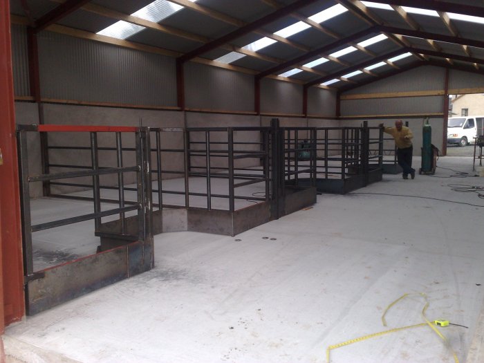

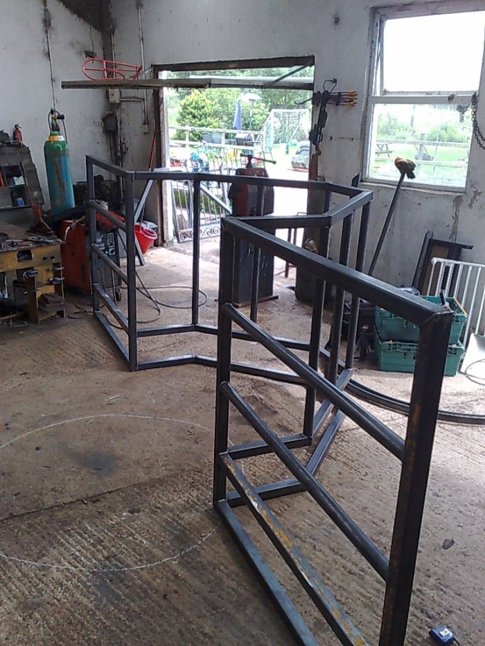

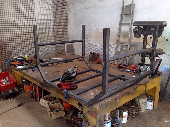

A friend asked me to make him some barriers for his rare breed cows. The only problem was that he is only going to feed them round bales of haylage, which are awkward to use compared to silage.
It was an easy solved problem though. We made cutouts in the barriers where he can just push in a full round bale with the tractor, the cows can then reach through far enough to eat the lot, and he still has enough room to drive the tractor through the shed
but I would be inclined to strengthen the joint where the round section meets the rail as cows can get a fairly hefty push on. the top and bottom bars on most silage barriers are 3 in. pipe but then there would be about 8 to 10 feeding at a time
