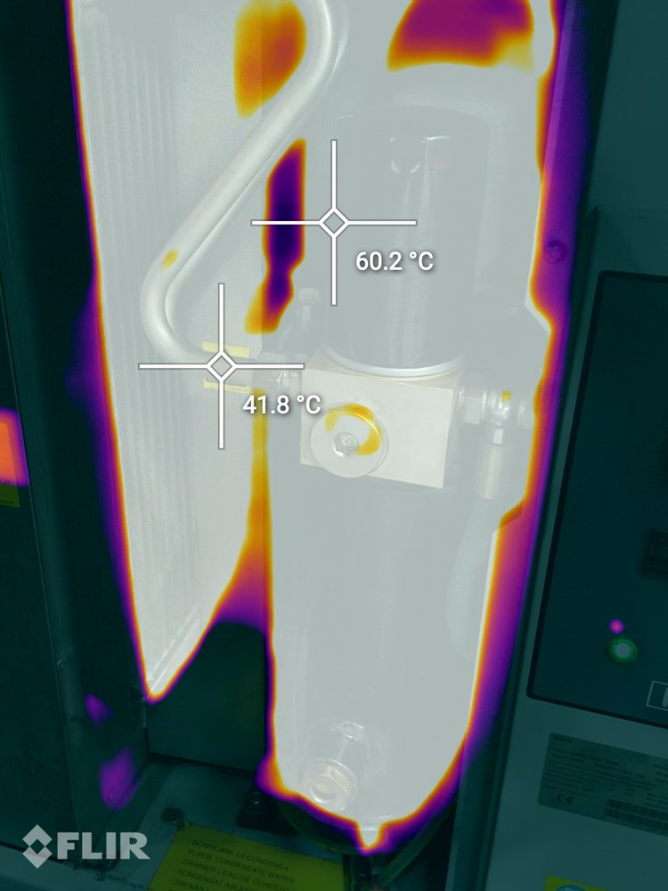

Before and after oil stop valve

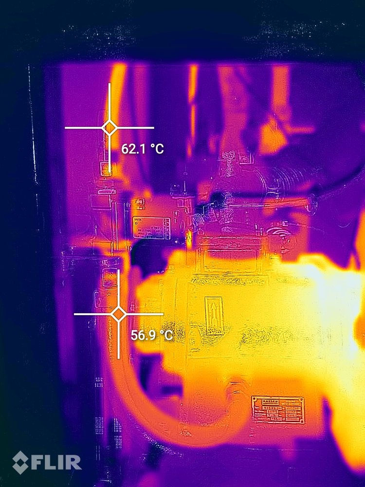

******** motorbearing

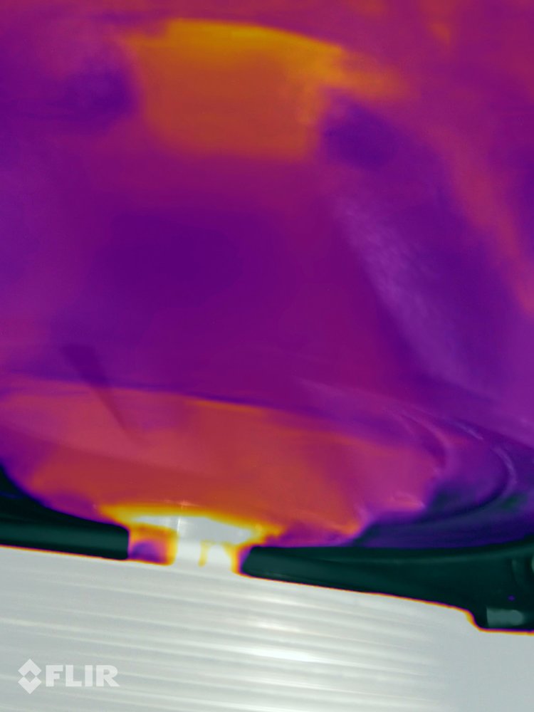

Failed thermostat

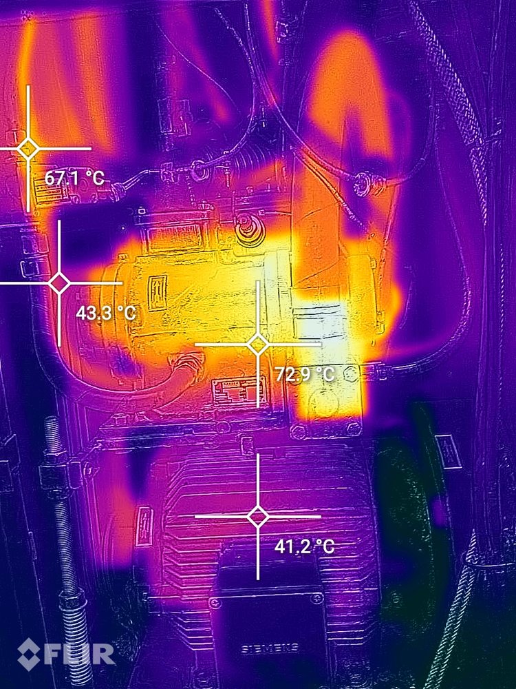

Bodged open stat

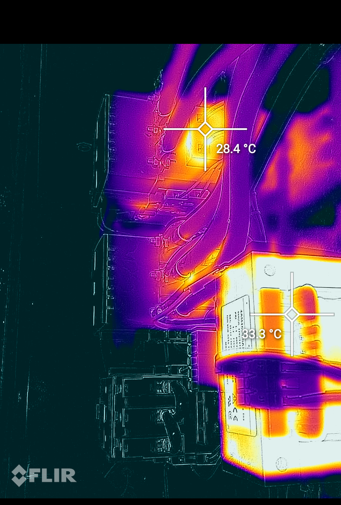

Checking electrical cabinet as shutdown was not an option on this routine check
