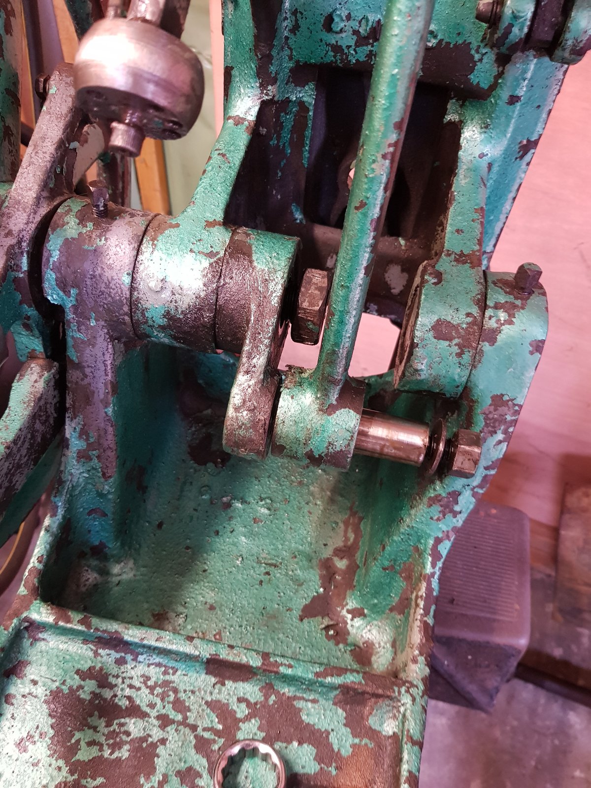

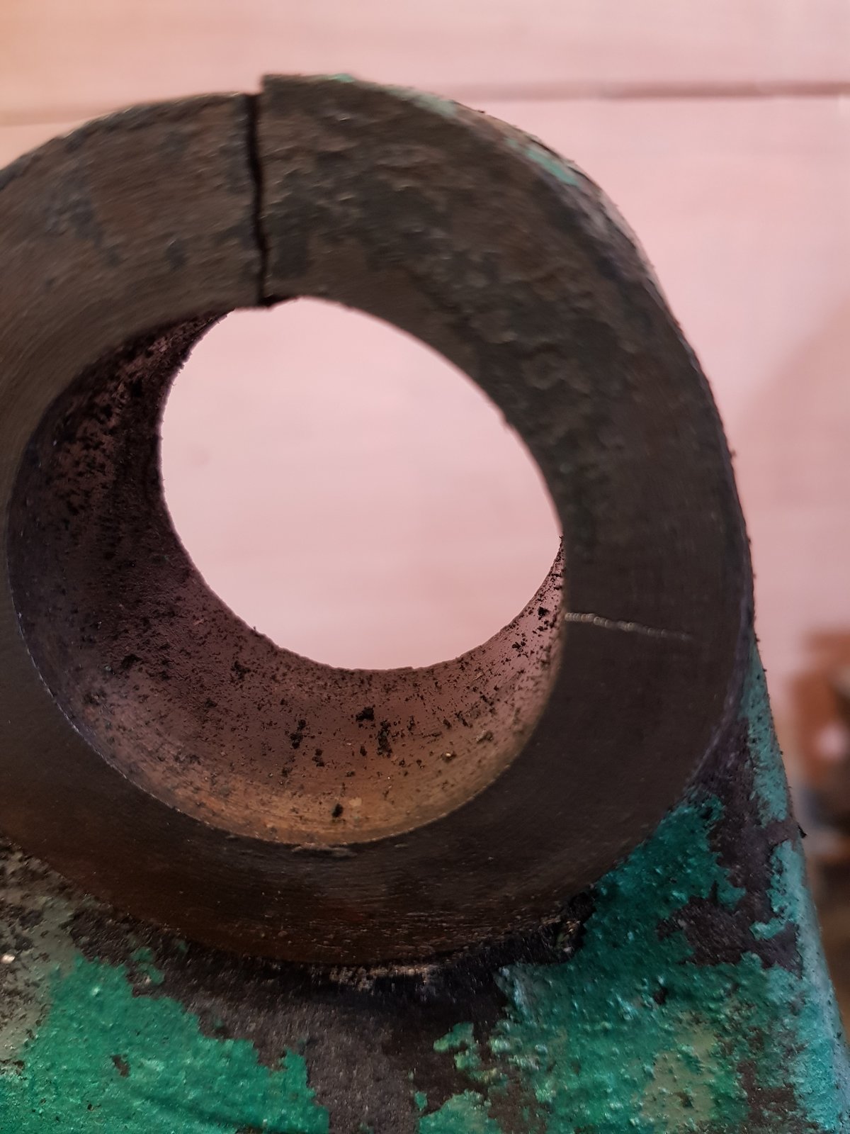

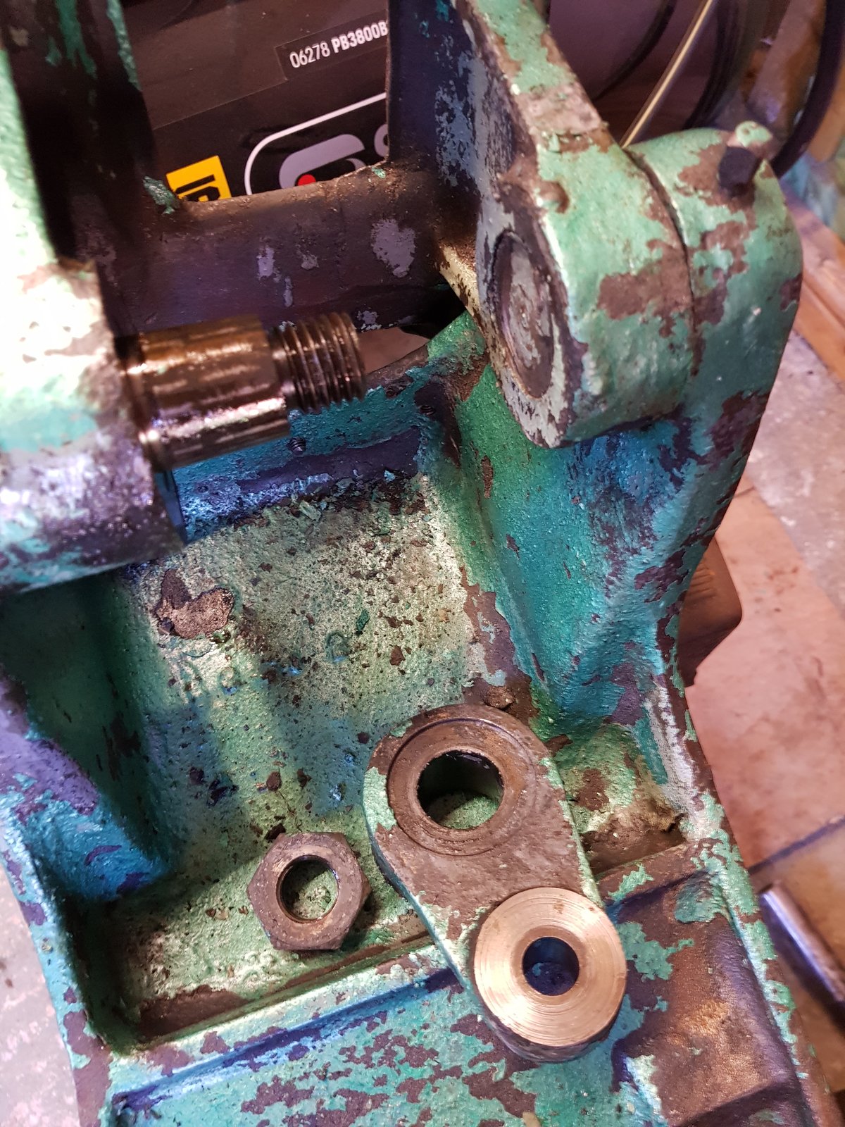

I have some cast stick welding to do on my Manchester power hacksaw because some tool broke it...now I have stick welded cast before with nickel rods. But used a lot of heat...granted I am no expert with cast..but what is the correct procedure for cast...heat...no heat.
just braze or weld it up other than that as I said drill and tap and bolt it back up to the pin
