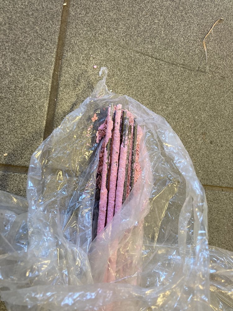

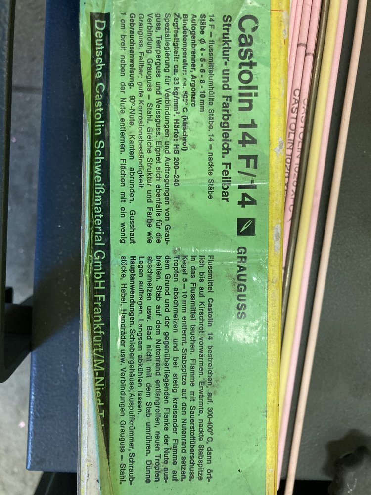

I have made repairs similar to this but I certainly would not proffer my services as a professional. I am a Master Bodger. Here's one I made earlier: #50

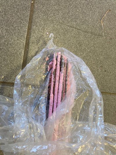

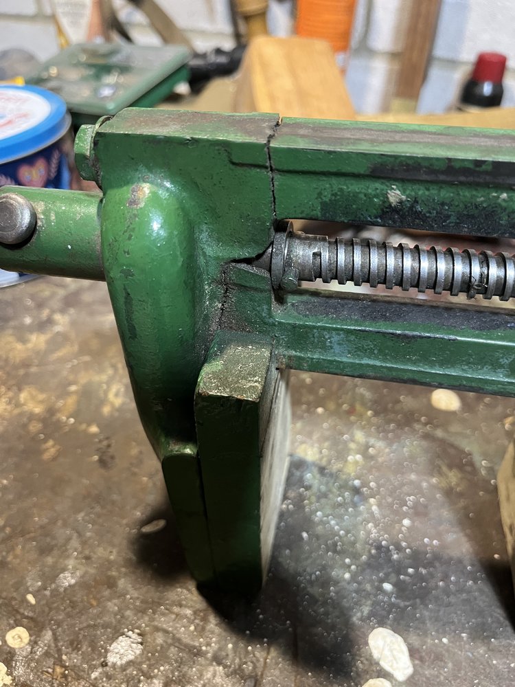

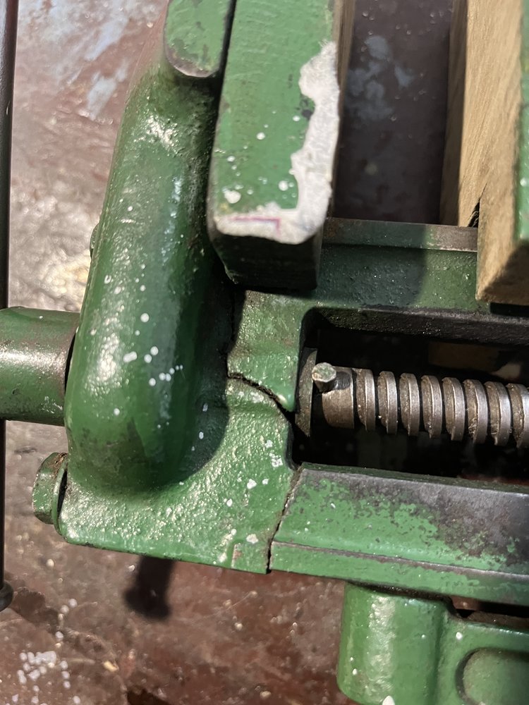

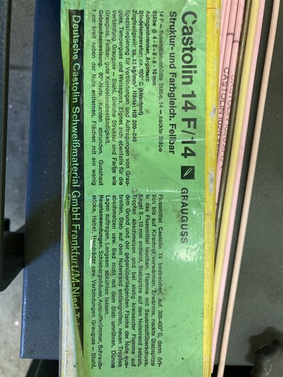

If no one else steps in, I'll have a go at it though my solution would be to V out the break and braze it up.
