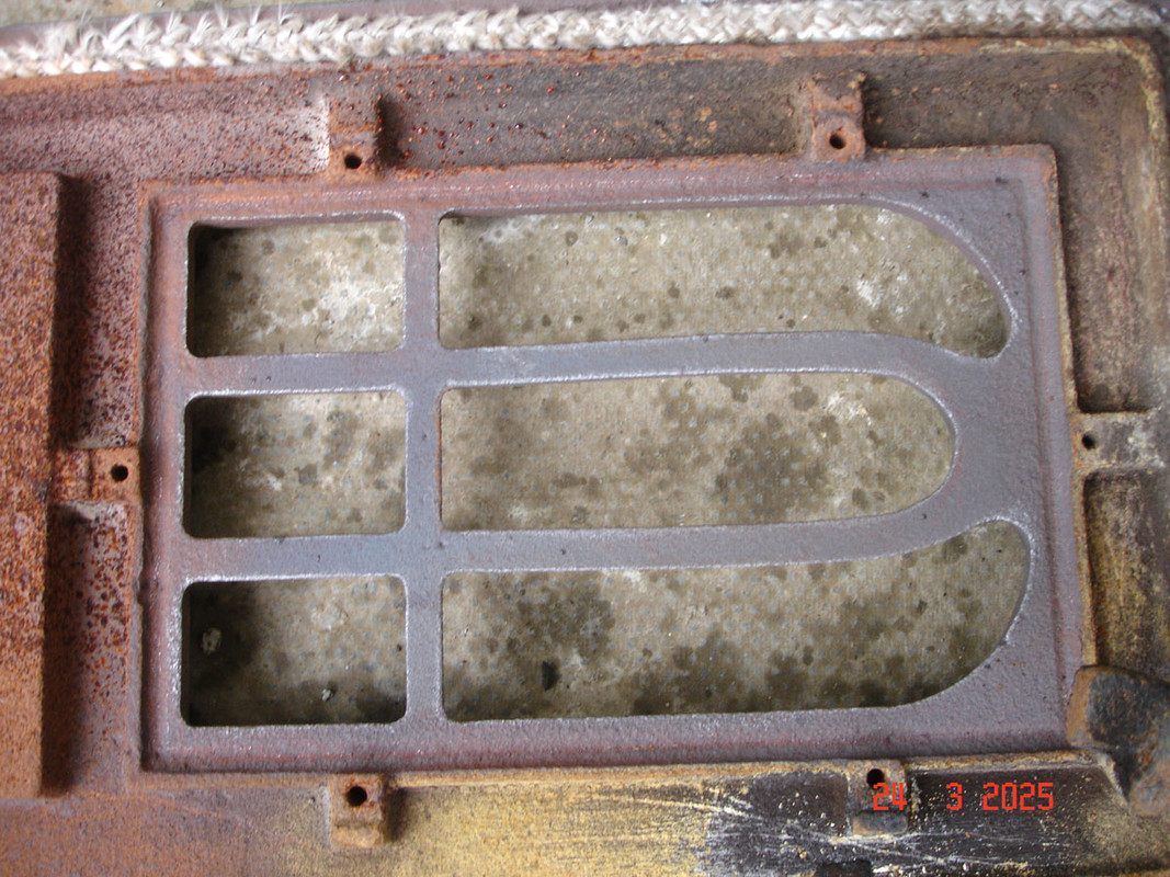

Does anyone have any ideas, other than take the thread up another size, to repair the worn threads on this stove door? They are M5 threads and they hold the clips that retain the glass. They are very close to the edge and I am worried of breakout if I take the hole up to M6. Is there anything anyone can think of that could be used to fill these holes so they could be re-tapped to M5? Is there any type of filler rods that could be used to fill the holes? I have oxy/ propane torch if that's any use. Cheers.
