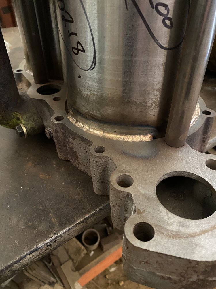

Im welding cast iron to steel in a heat exchanger in a Terex rock truck . Using Silicon Bronze got started no problems moved to the other side again no problems . But then the first side got a big old crack down the middle . wanting ideas
I can't see the crack.
Is it in the bronze, the cast, or the steel ?
As above, need a tighter fit, you've got allot of cooling strains/shrinkage going on.
The "starved horse" weld bead is not helping if I am seeing things right.
