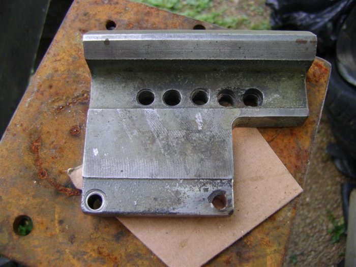

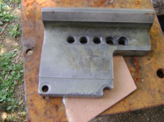

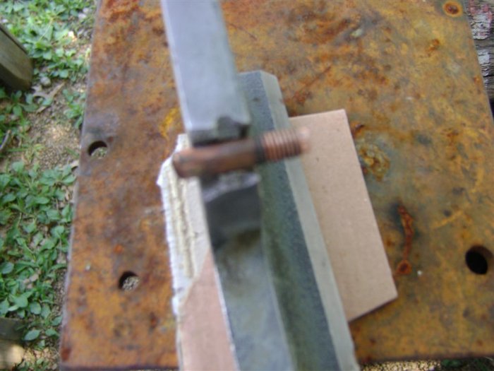

A guy sent me this part with the corner busted out. I layed a mig tip in the hole and mig welded it up with cast iron wire. Total welding time 30 seconds. then ground it flush on all sides and drilled out the copper slug. Less than a 5 minute fix...Bob
