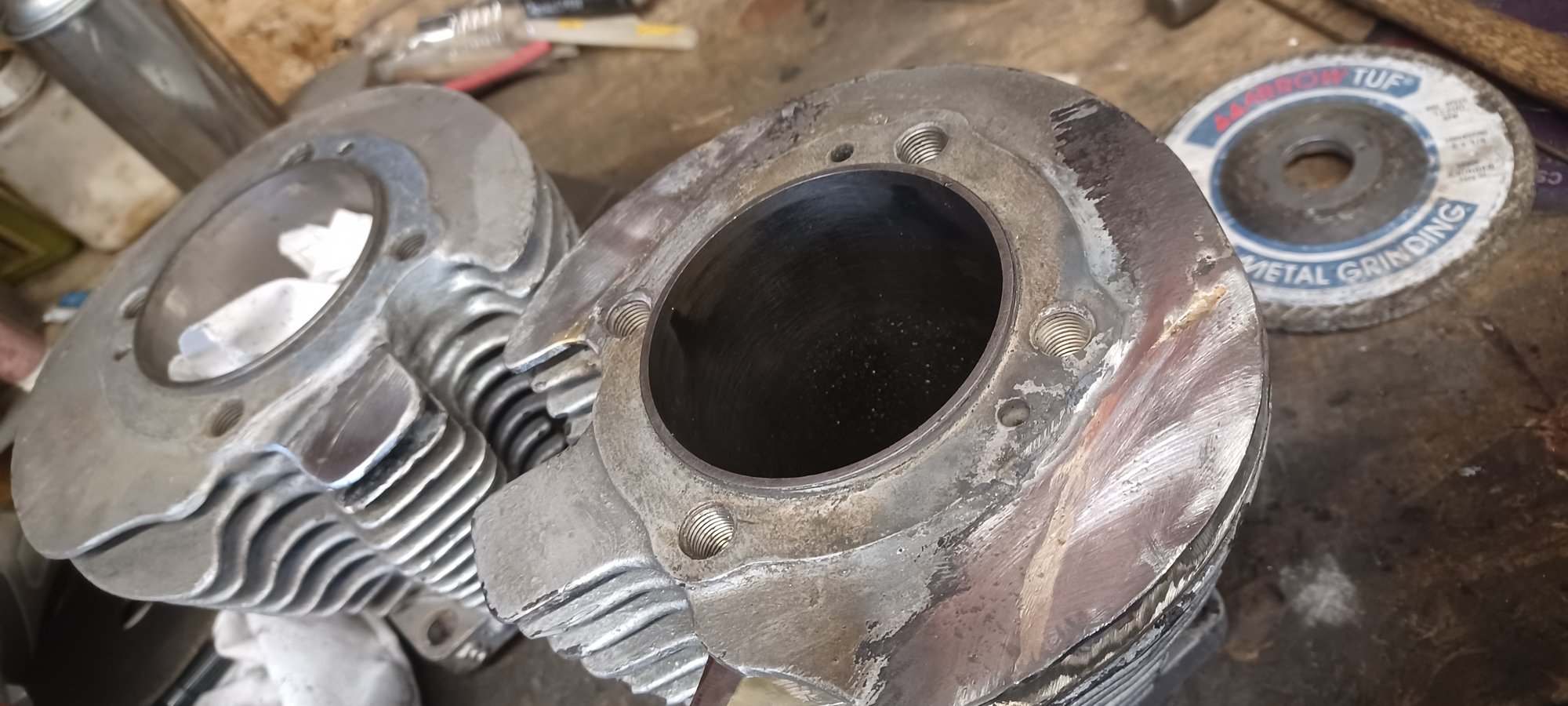

got a couple of old harley barrels
"Knucklehead" i think ?

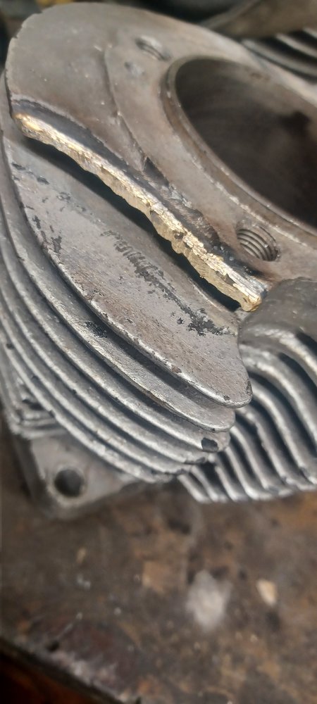

in the effort to keep the heat down and avoid cracking i laid down a buttering layer with mig bronze then shaped steel plates and silver soldered them
it worked well and no problem of the casting not wetting
