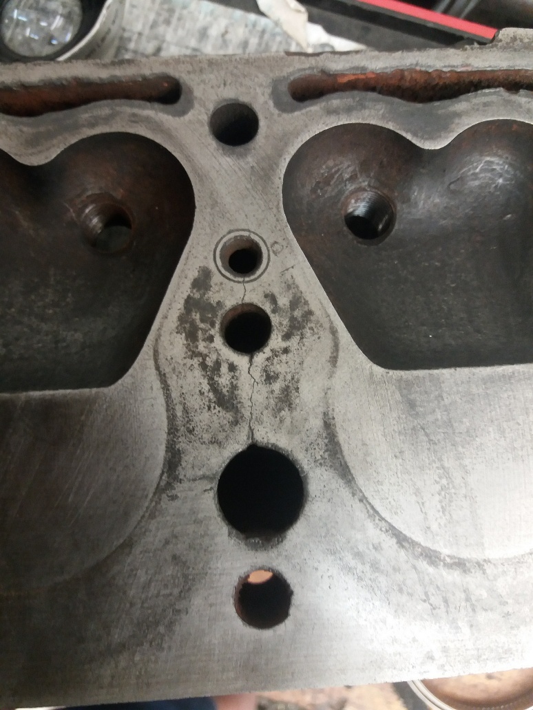

I have been asked to weld this
I was thinking of milling the crack out then
Preheat 100 deg C (just to take the chill from it)
use Aluminium Bronze filler wire (TIG Braze)
The main crack goes between 2 water passages
The hole in the middle is a head stud hole
I could do with buying a few filler rods as a pack is a fortune
