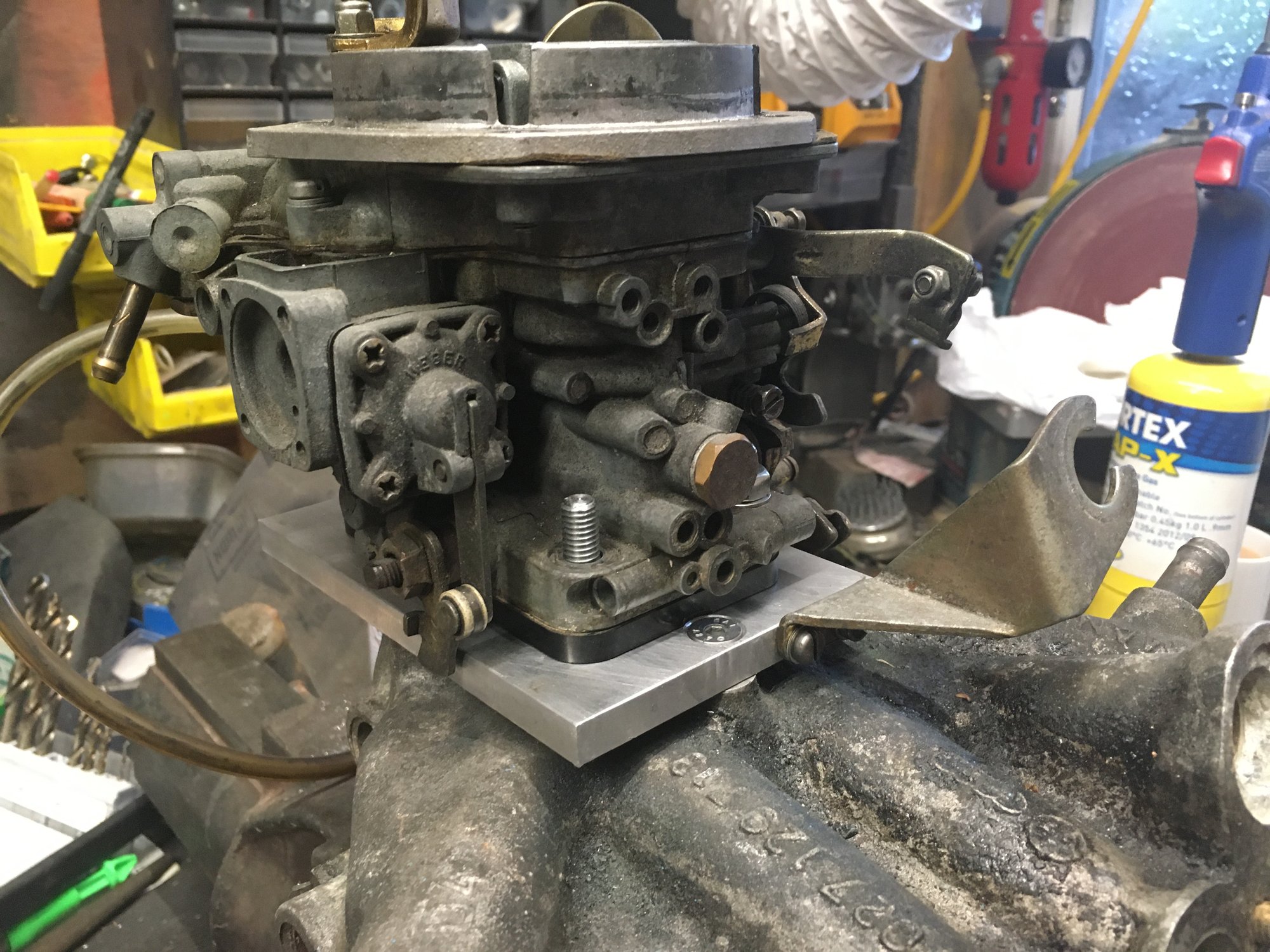

you got itwebber carb onto a vw 8 valve manifold by any chance ?
see youve got a rubbery gasket under therethey dont like it much when you leave that out

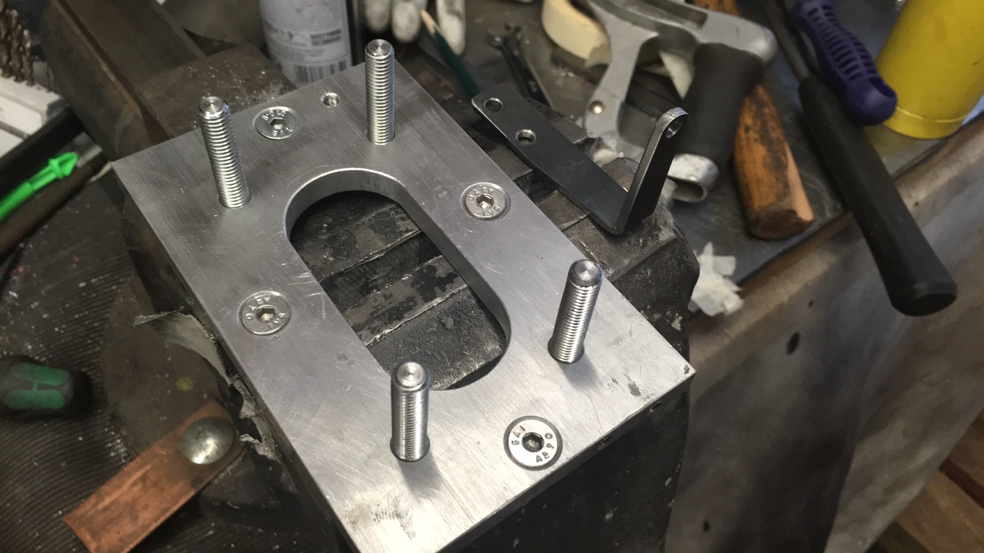

we use that carb on racing 2cv, its quite an easy one to do as the stud pattern is pretty close to the OEM Solex. I just take studs out Tig in some cheap m8 studs face and re drill for the new stud pattern. View attachment 204775
