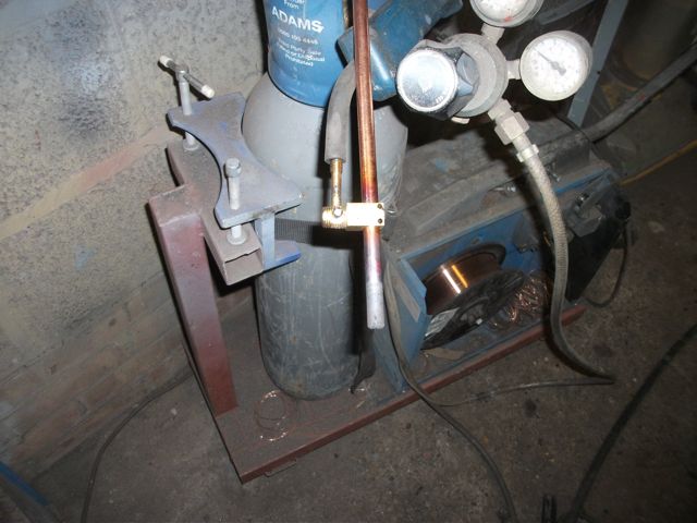

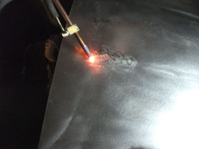

I made one of these to attach to my Mig welder tip. Works brilliantly! You put an earth on the panel to be shrunk and with the carbon electrode draw a spiral shape with the power on onto the area to be shrunk. You may get a bit of sparking. Can also quench with an air line or even a damp cloth.
perfect way to remove a stretched metal dent from a panel.
You don't need an expensive machine to to carbon heat shrinking. If you already have a Mig welder and a lump of brass you can make your own!

Definatly no trigger, however the carbon rods work.. And my god does it work! You place the rod on the panel and about 1/4-1/2 second later it arks and it has what seems like a 3 second timer, no sparks, mess, nothing, 100x easier than the way I've been doing it for years!
