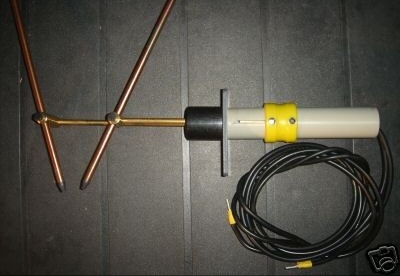

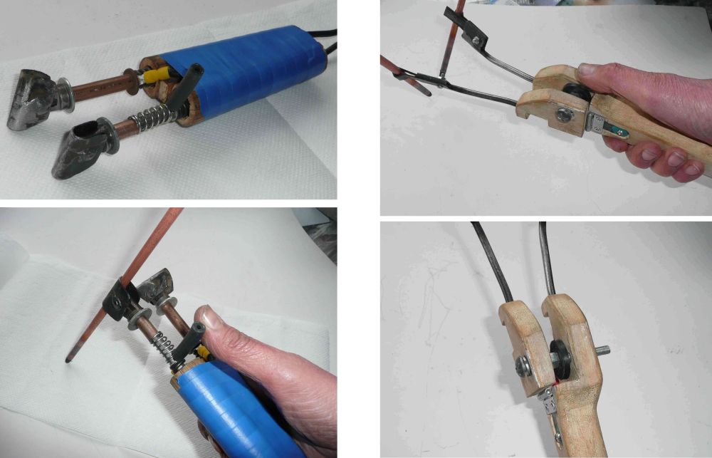

Construction wise I'm searching out for various designs and trying to understand which one would be the best
The clamp holder design seems to be the easiest way to make a torch
This involves a kind of clamp that when is compressed will make the carbons touch together and start the arc
There is also the slide design
This involves to use a sliding element on the handle to adjust the distance between the tips of the carbon electrodes
Another design is the "Lincoln style?" I've seen Lincoln electric arc brazing torches online and those use a mechanism which turns the rod holders to adjust the distance between the rods
This design is the most complex but also the most elegant I might say
Heat shield useful or not?
I've seen some torches use a kind of heat shield between the Arc and the handle ,some others don't .

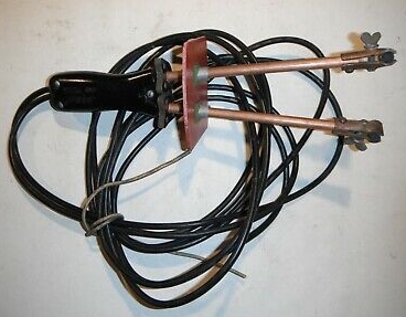

The rod holders
Various possibility here to make them
But what to use?
Copper isn't an option (too much expensive and hard to find here)
Alluminum tubing (I have some) but the parts that hold the electrode would be steel
So steel might be easier to work with , cheaper , and I can weld it .
Steel rods o steel tubing
Steel rods are easier to weld
Steel tubing I could put the copper strands inside of it

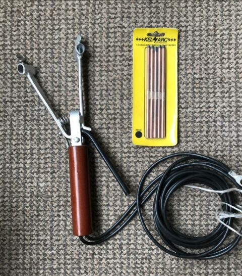

I also remember the ones sold as a kit that could be used straight off a truck battery
