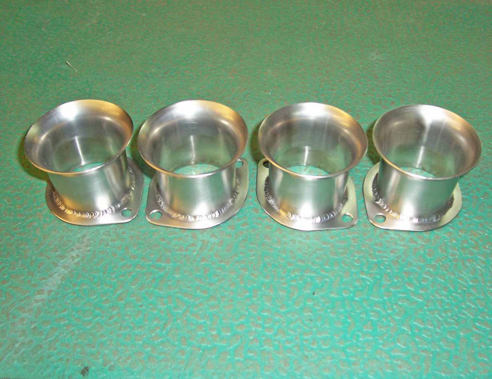

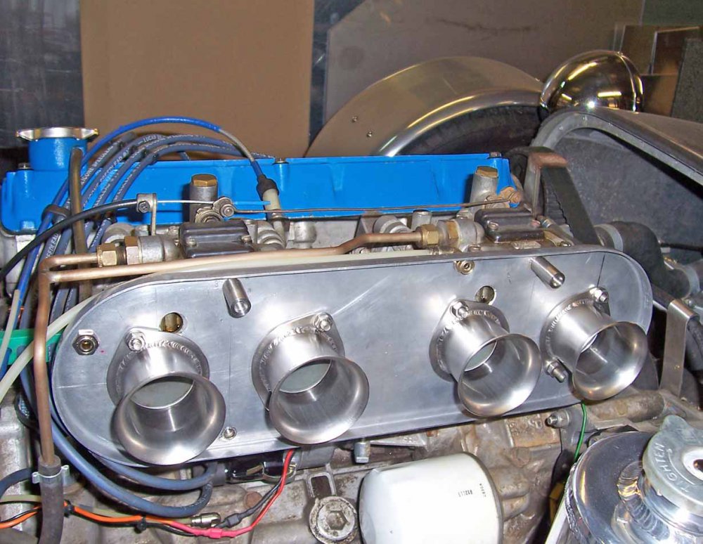

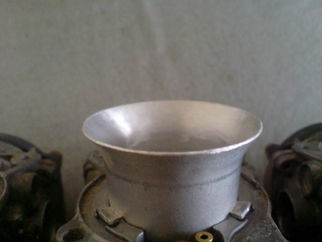

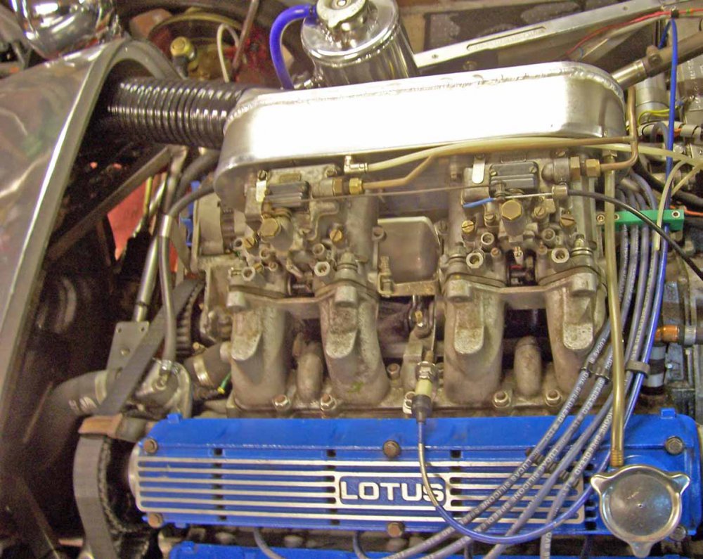

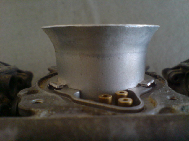

I'm fitting a cold air intake to my Seven at the moment but have been finding it difficult to source the required ram tubes.
Everything was too short, too long, or too damn expensive, so I thought I'd make my own.
They are to fit twin Dellorto 45's on a type 907 Lotus engine.

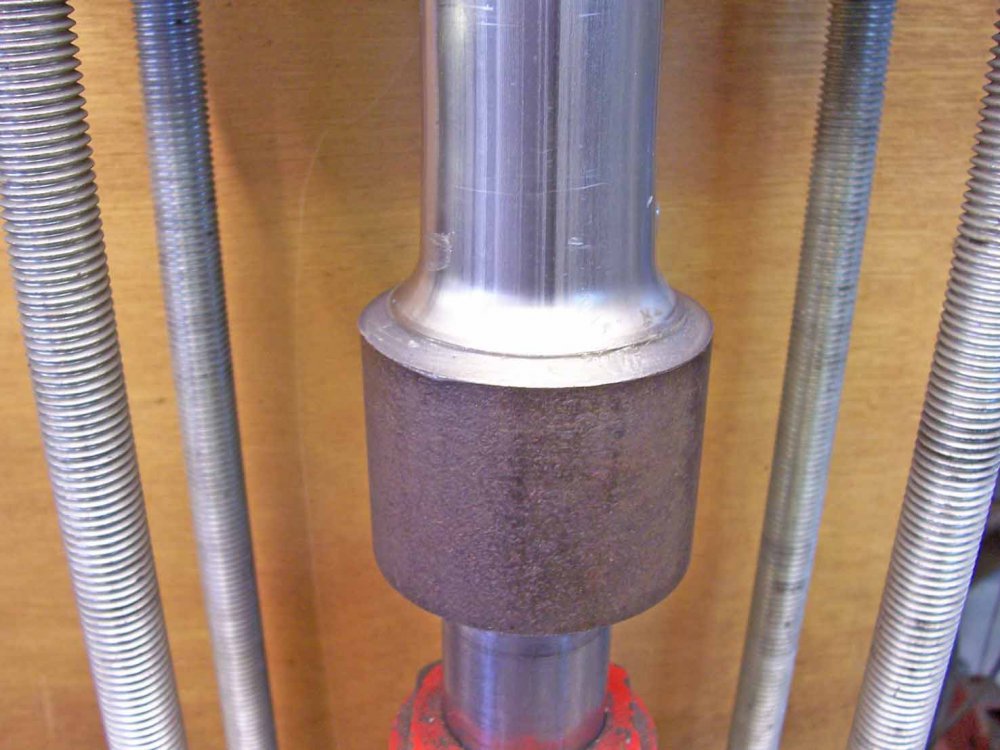

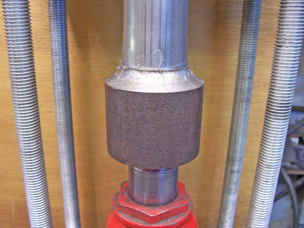

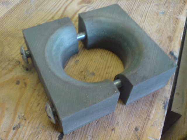

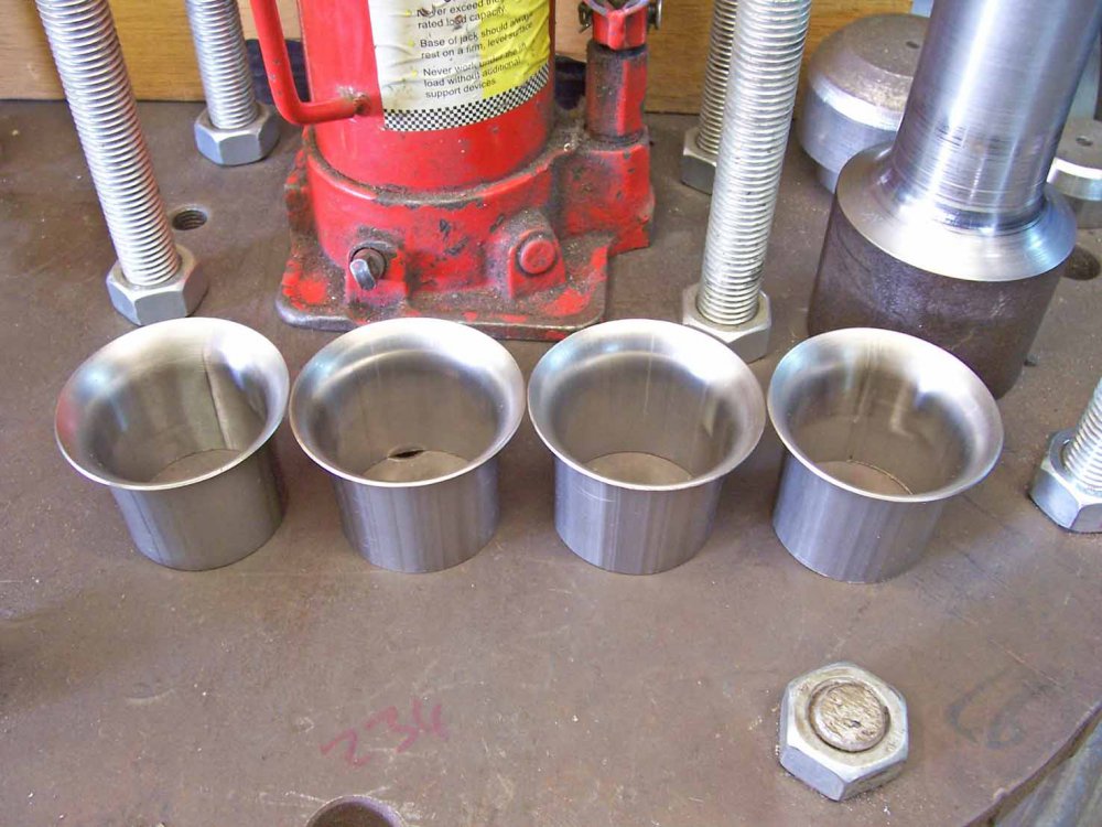

Once again my trusty 12 tonne press comes into use again although judging by the creeks & groans
I was close to the limit. (and so was the press
Still to have flanges welded on the bottoms but coming on nicely.
