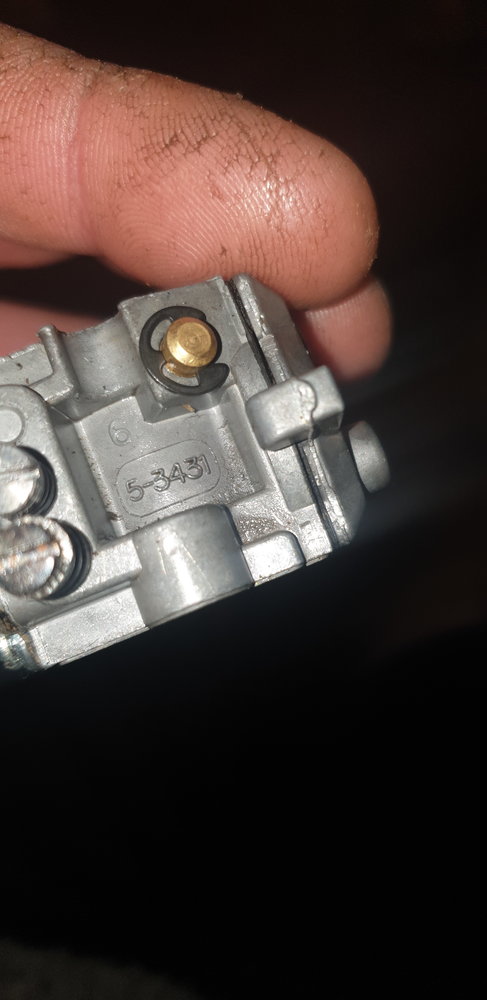

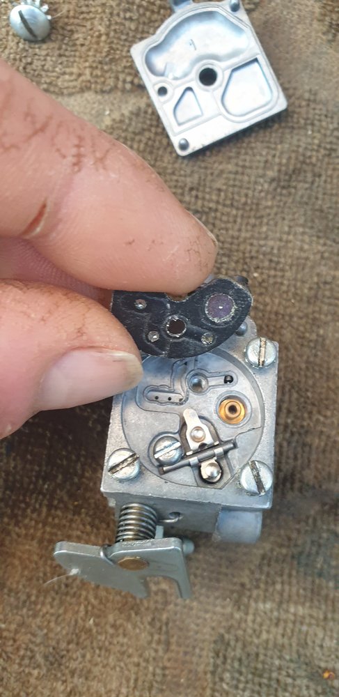

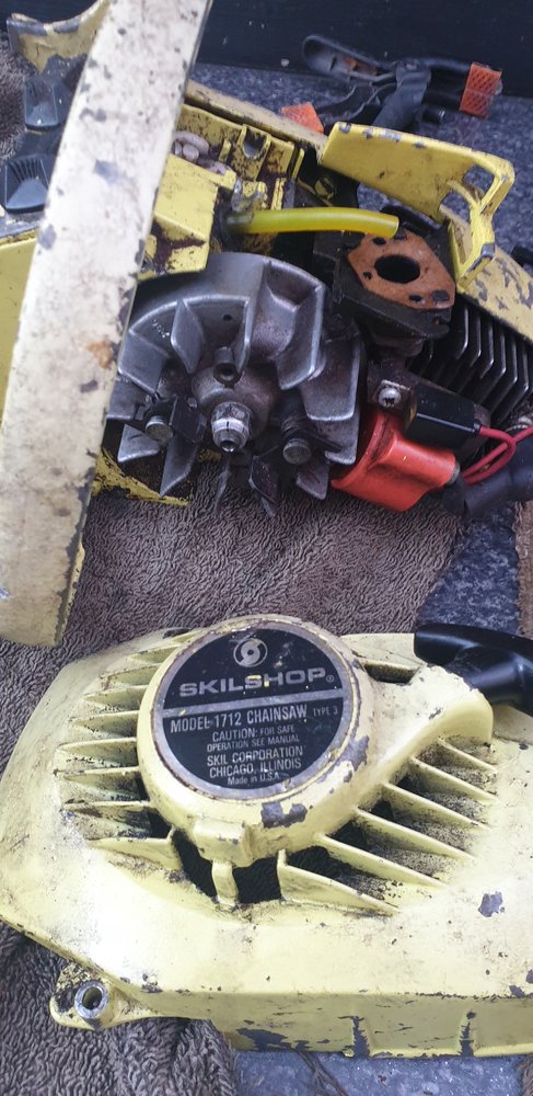

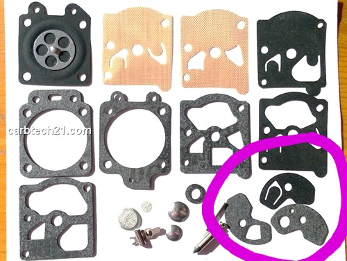

Ok ive got a carb that I can't seam to find a kit for im prob being stupid but thought I'd throw it out to the collective see if any one recognises it or can point me to the right way
What’s it off? Sometimes that’s an easier place to start
also how was the item running as some of the carbs have a 1 way valve that needs to pressed out of the casting.
K20 kit fits virtually all the walbro carbs https://www.lsengineers.co.uk/n-g-c...MI2tul1dH08AIVCIjVCh0ZBgM_EAQYAyABEgJPcPD_BwE
yes went through the kits that will fit most of all of them but its down to the 5 holes in to the small rubber bitBay of Fleas

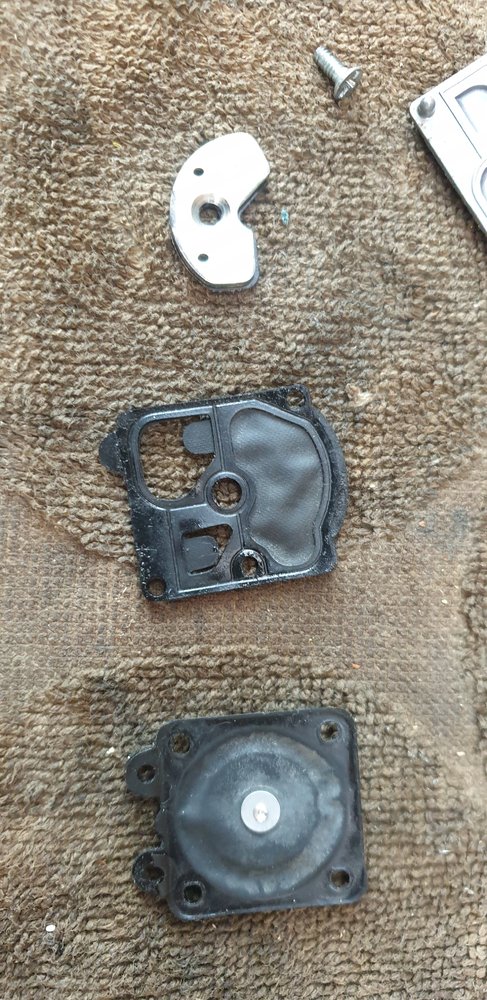

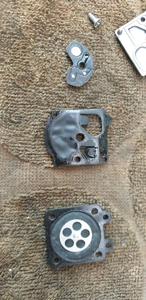

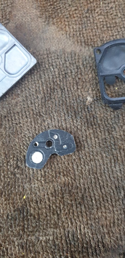

Where in the carb did the small rubber bit come from ? I've done a few Walbro and Keihin carbs and don't recognise that bit.
It's the pump diaphragm.
View attachment 293267here it goes ive never see one either but its supposed to be there

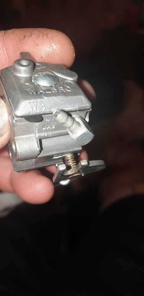

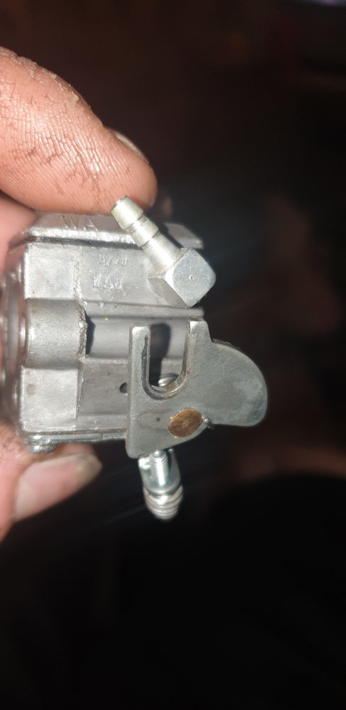

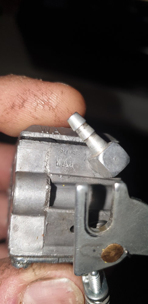

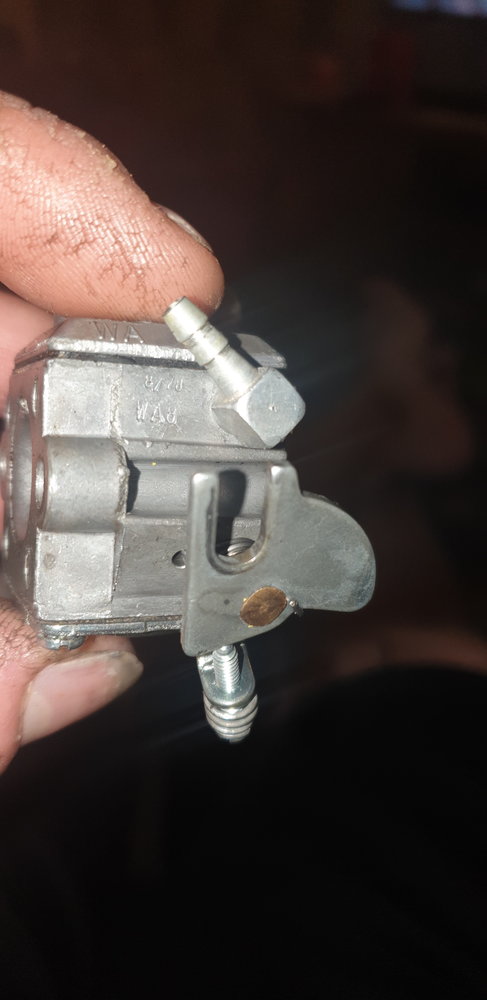

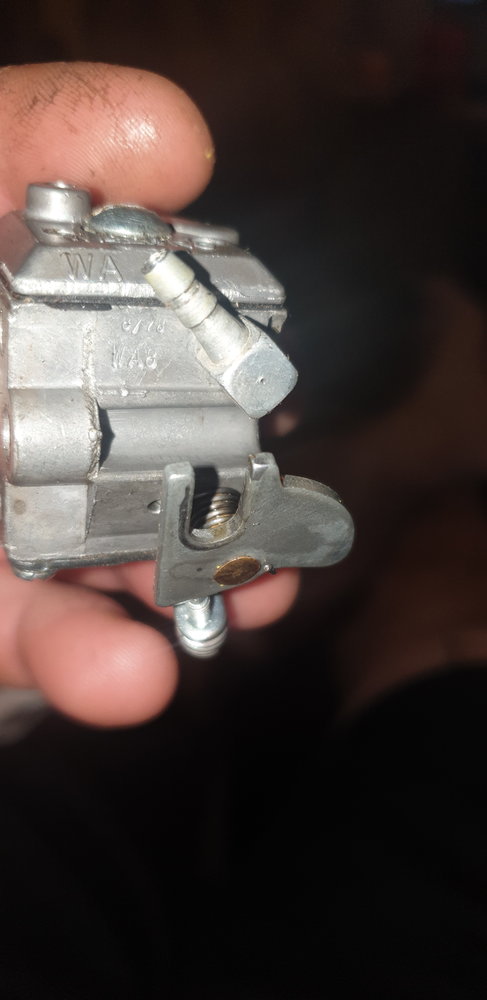

I think K10-WAT is the kit you need for a WA8 carb.
I would go with one of the kits, the carb has cross channels where that rubber sits, they probably superseded that original with one that has less holes and rely on the cross channels to divert to other holes. .

it looks very like the kits on the TKM series karts which had a walbro carb

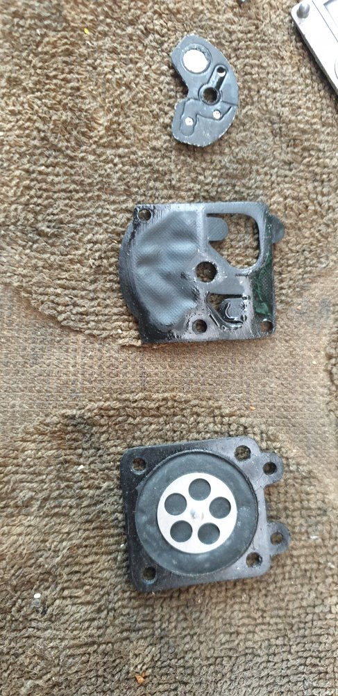

been looking for a another day but still no luck as bob said might been upgraded to a different carb kit but its rare for the carb not to be on there site the number dont match any thing they got
Bob
just had an email back as it happens looks like the wat 10 is the one that fits but as there are 3 of the small bits like that is in pink above what one do i use ?
