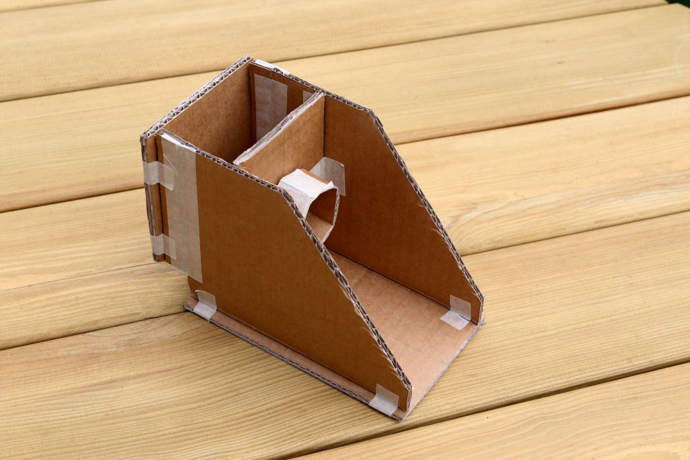

Just wanted to ask you seasoned experts out there if my project is sound from a design point of view, since it will be my first attempt at welding.
The plan is to build a pair of caravan jacking brackets (caravans are trailers right?), which are then to be bolted to the standard position on the AL-KO chassis of my 2011 Sprite caravan.
(Weight of caravan is around 1200kgs when loaded, ready to tow)

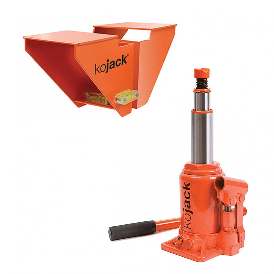

The idea wasstolen from inspired by the Kojack system:

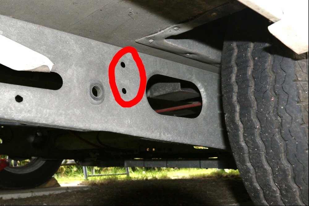

My brackets are to be fitted in the same place (circled in red), as recommended by the makers of the chassis - AL-KO:
(Those that know about caravans, will understand the difficulty of jacking a caravan without these brackets....on a flat tyre it's near enough impossible.... especially on the side of a motorway in Spain!)

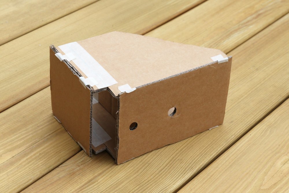

I have spared no expense by creating a very detailed CAD model of these brackets:
Of course, by CAD I meant Cardboard Aided Design!
The brackets will be fillet welded entirely, and cut from a plate of 4mm mild steel.
My welder is a (very cheap) Clarke MMA/TIG 120, and I shall be using 2.5mm 6013 electrodes with the machine set to 80-90Amps.

Does my design look sound?
I realise that access to the top section (in contact with the underside of the caravan floor) might be tight, so I will probably only have outside fillet welds, since it will not be load bearing - merely to act as additional support and to counter any twisting of the chassis member.
The 'circular' piece is a locating boss (anti-slip feature) for the bottle jack (~40mm OD, 3mm wall).
My jack isn't a low profile one with multi-section telescoping pistons like the Kojack.
The height of this boss has been calculated to allow my taller bottle jack under it, when the tyre is flat.
So, what do you experts think?
Am I on the right track, or destined for a spectacular failure?
(I think if done properly mine will be much stronger than the Kojack, simply by virtue of being made from thicker steel)
Any helpful criticism or advice will be gratefully received.
