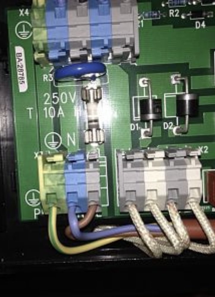

Father in law has a repeated problem with the 1800w combi-boiler in this caravan blowing a very hard to access 10A time delayed / High Breaking Capacity fuse.
My thoughts, and the consensus on a few forums, is that a poor supply voltage, voltage drop from 25m hook up lead and other loads running at same time, causes the hot water heater to pull more than 10A (P=IV) and blow the fuse.
I believe it has blown on us today.
We were running a small convection heater at the time which probably pulls a fair few amps guessing by how hot the plug gets. (I took clamp meter out of van
). We use this to dry towels & boots in the awning.
Went to use the hot water and it started warm then went cold.
Does this all sound plausible so far?
So anyway, knowing this is a problem, i've pre-purchased a quality 20x5mm 16A fuse holder from RS Components, and some new T10A fuses - with the plan to solder two leads onto the original fuse block, and mount a fuse holder on the casing of the boiler, so fuse can be replaced easily.
However, i've had a thought. Perhaps it would be better to install a MCB?
What are peoples thoughts?
Below is attached a photo of the fuse on the PCB which is almost impossible to access without complete strip down and removal of the boiler unit.
