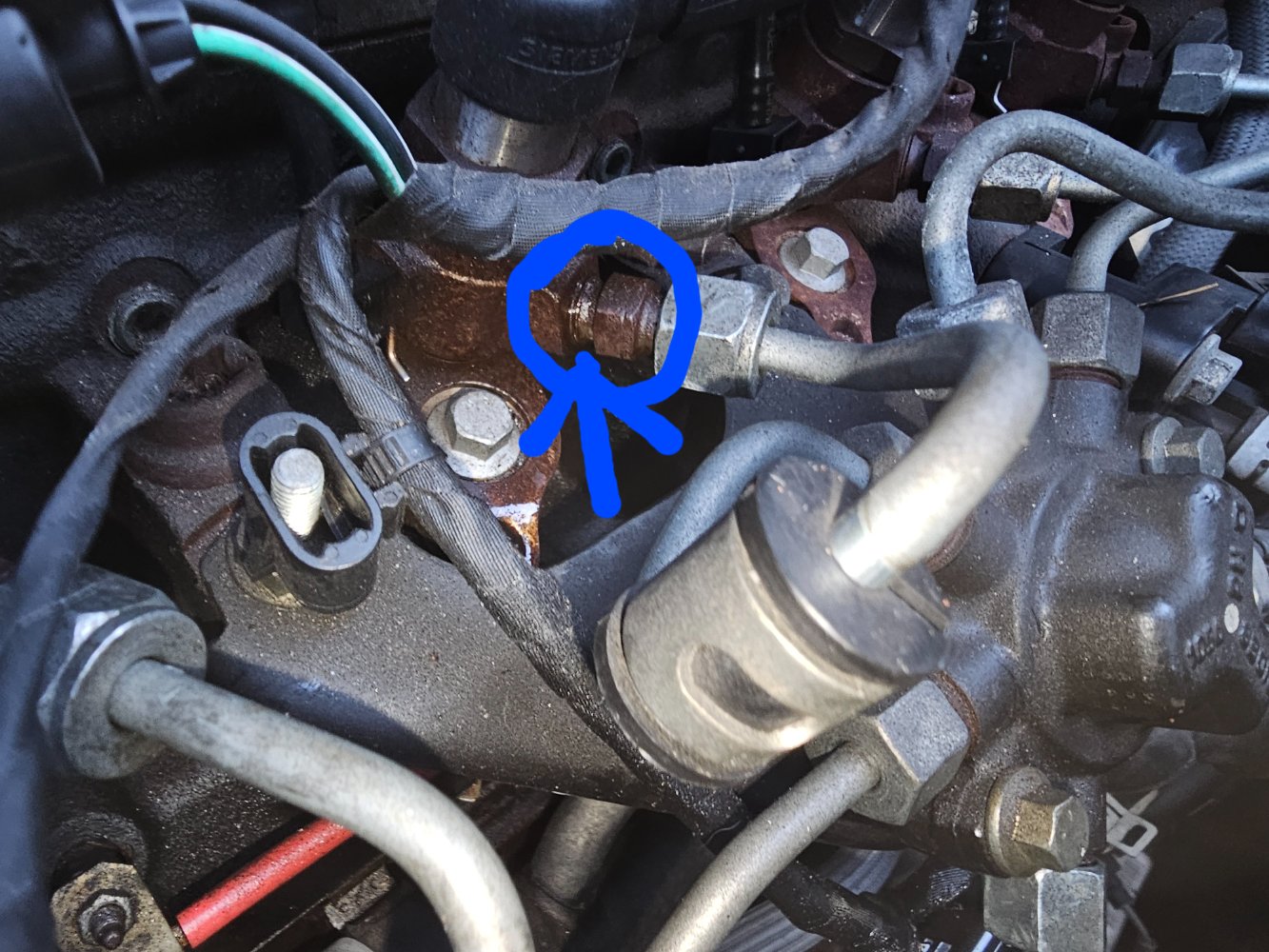

Starts runs seams fine just smelled a bit of fuel so I've found a small leak on one of the injectors what I think is coming out of a common rail injector injection nozzle inlet connector
Pic here
The metal pipe with the silver nut seams to be dry its the screw part that looks like it leaking any one know what seals it this end a washer of what type etc ?
The car is cmax ford 08 year

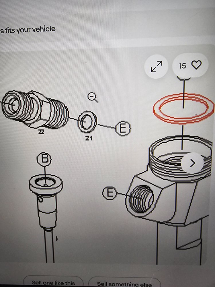

2nd pic ebay pic of an exploded injector that show a washer but made of what I dont know or if mine has even got one
Any help please thankyou
Would this just be a standard seal ? I went to local motor factors but the only thing i could buy is a whole injector at 250 quid while if that what it cost me so be it but if its just a copper rubber cork washer and its 5 quid or 20 quid for a set I'd rather do that
Pic here
looking on the immage there seams to be a washer dought it would be rubber and cork could degrade and block the injector so copper seams toi be the only way unless its a taped thread ?
