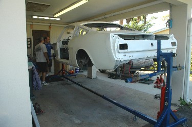

Firstly, anyone got one they want to sell??
Secondly, has anyone made one? There's lots of plans on the net that can be found from people who have made their own ... I was close to buying one but the guy is still using it (after he contacted me last Nov) and will be for a while.
Just wondering whether this would be too big and involved a 'first project' type of thing. Would my Clarke 160 be up to the job? For a novice welder with no metal, 'yes' I hear you all shout but I may have no alternative ... you seldom see them for sale, except in the States (where they cost bugger all really), and I want to put my fastback on one.
Any thoughts, ideas, plans?
This is the kind of thing ...

Knocked it together using a Clarke 150 amp welder from 6 to 9 wall thickness steel. Didn't get complete penetration, but these things need to be stiff more than as strong - all they have to do is hold a car up.
