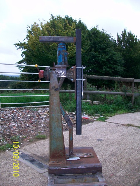

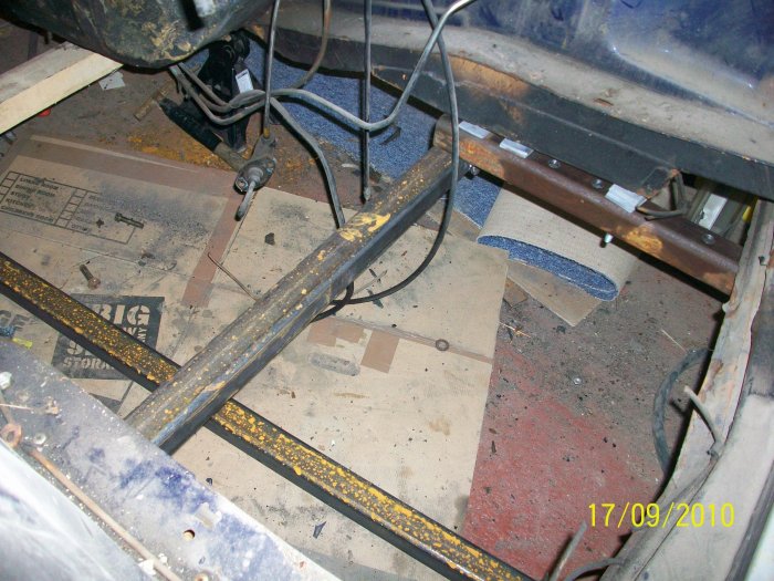

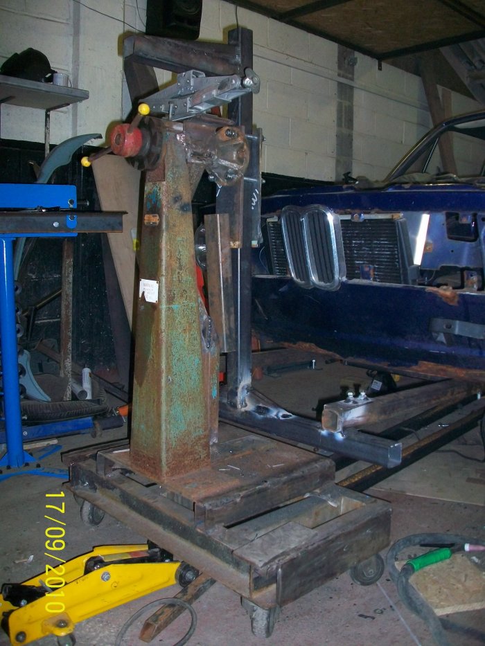

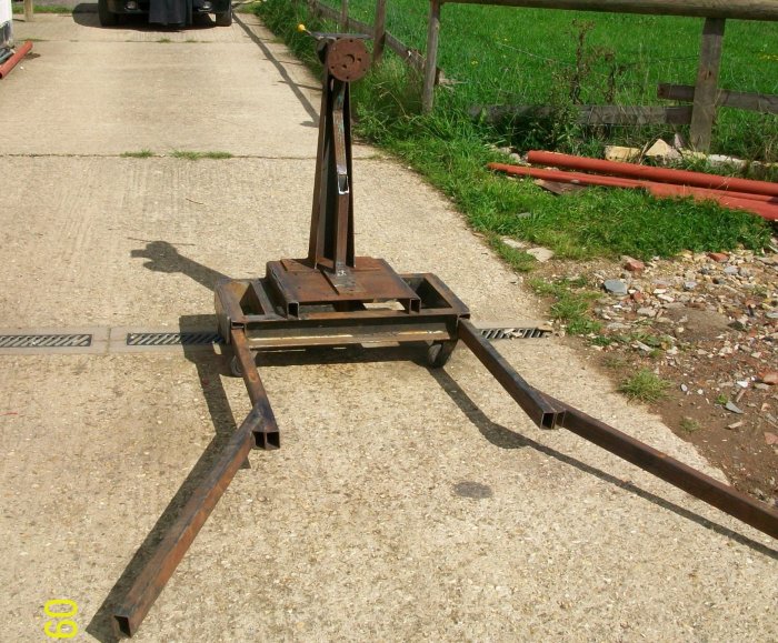

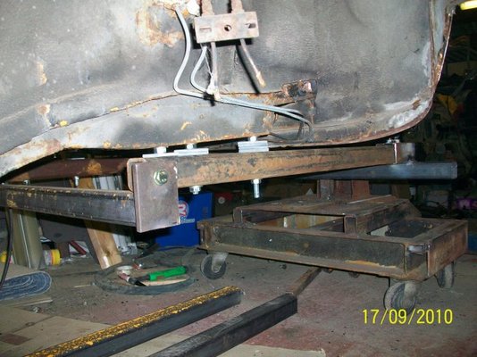

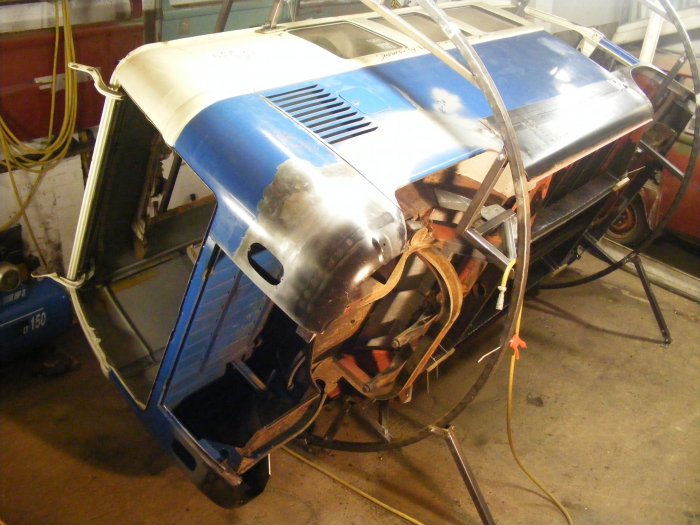

I have started to make a car roller for my bmw project , just to make it easier to work on the floor, frame rails and sills . I have used an old heavy engine hoist and a heavy duty engine stand that i had laying around the workshop

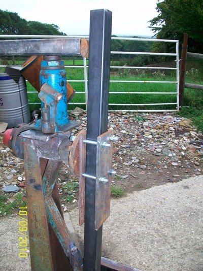

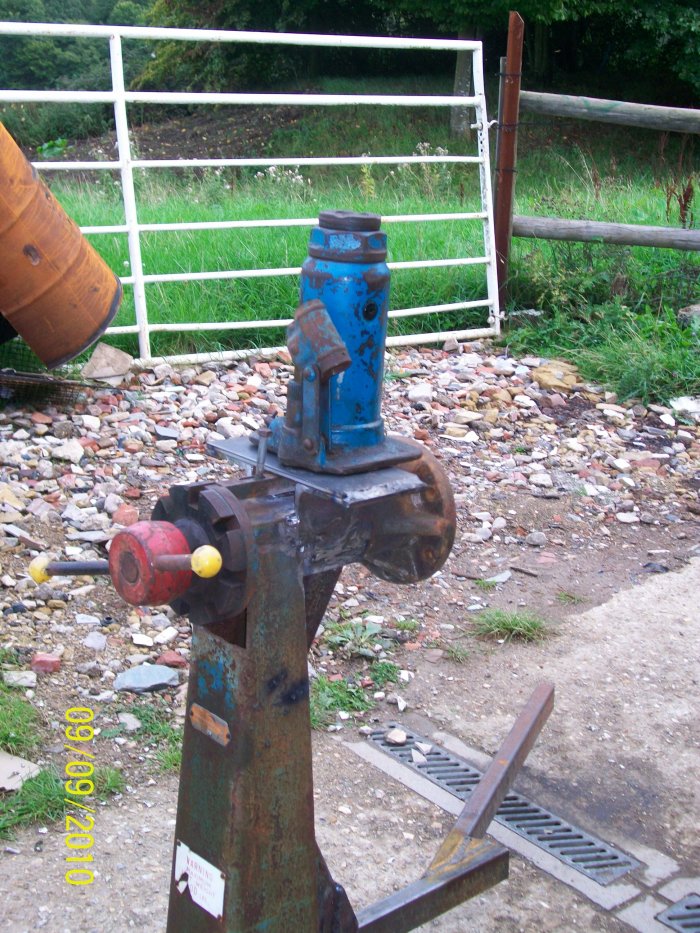

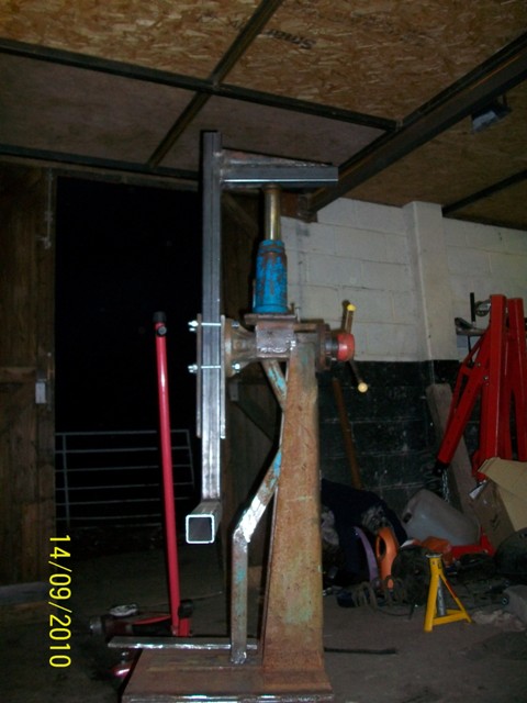

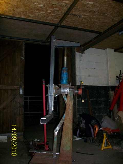

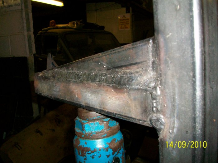

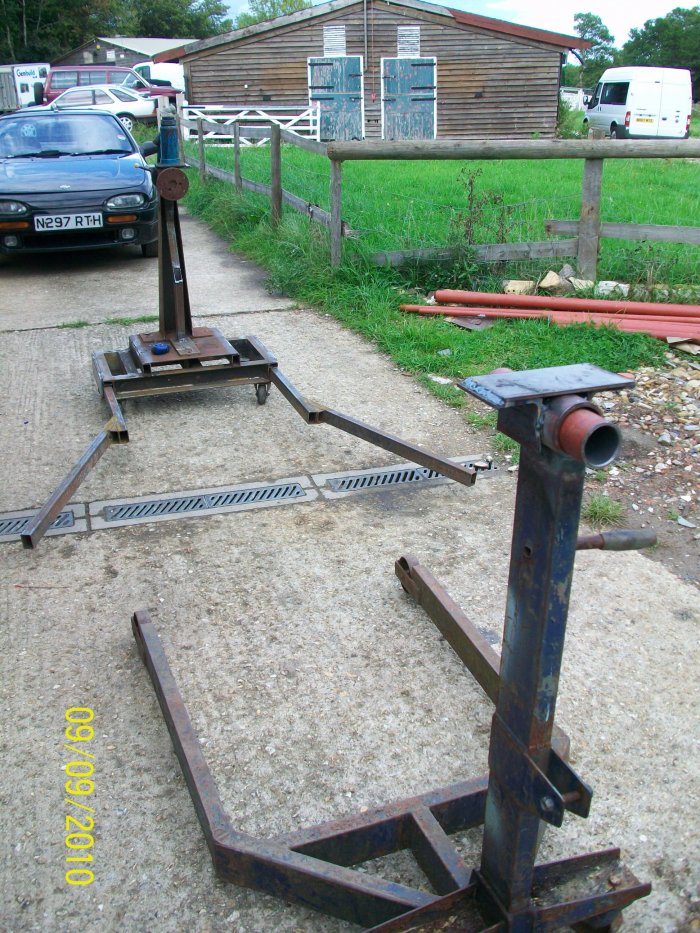

In the first picture you can see the engine stand that i have changed to suit my needs . I have raised the stand of its base and made some legs to help spread the weight of the car. i have also welded a plate on top where the bottle jack will be placed , this is how i will jack the car up to the desired hight.

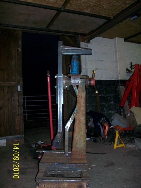

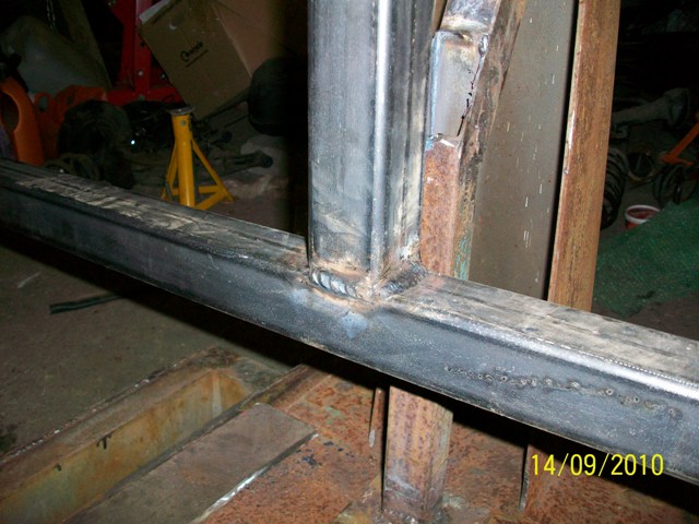

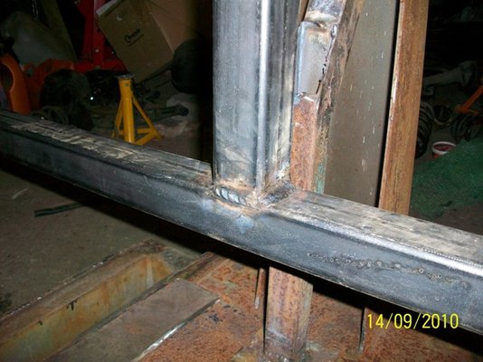

with the old engine hoist I choped of the top and welded in the pipe you can see, along with the plate on top . this will have a second bottle jack to raised to the car
