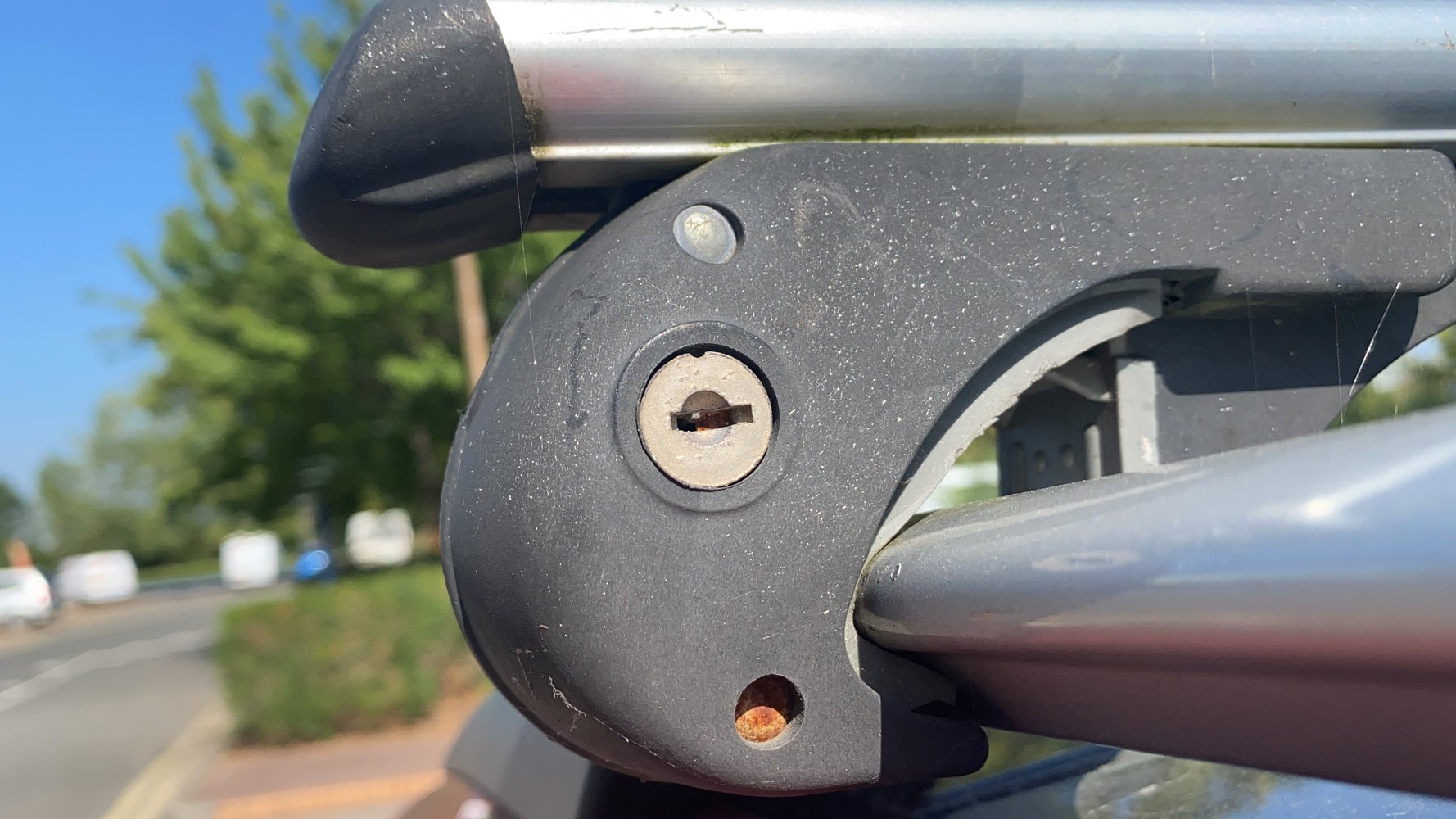

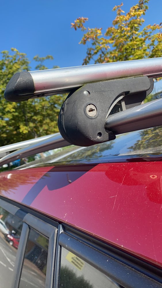

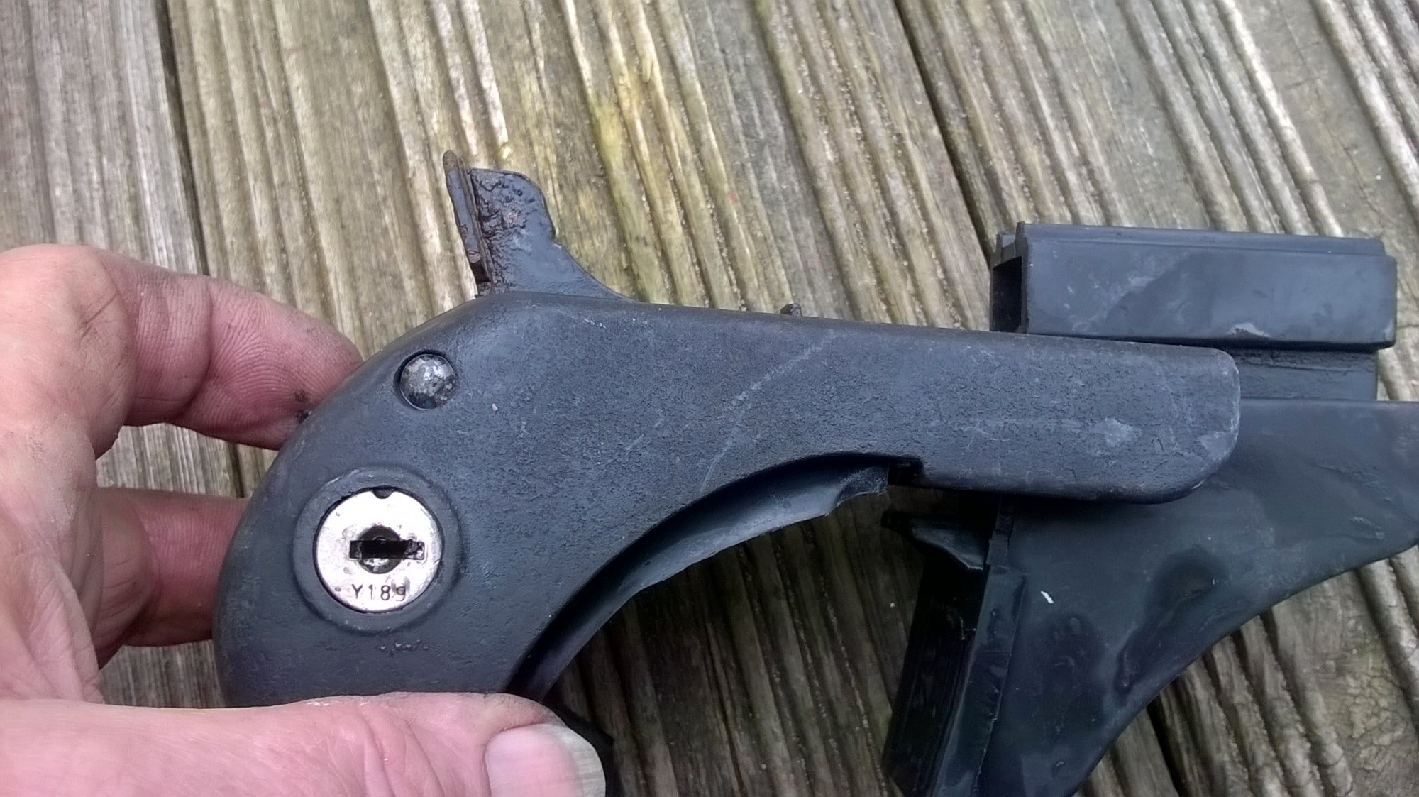

Might be worth a go, if I can get the barrels out I might be able to replace them.Dead easy to pick with a lock picking rake. Any locksmith could do it in seconds or you could pick up a set and follow instructions on Youtube.
Or use a small flat screwdriver and a paperclip...

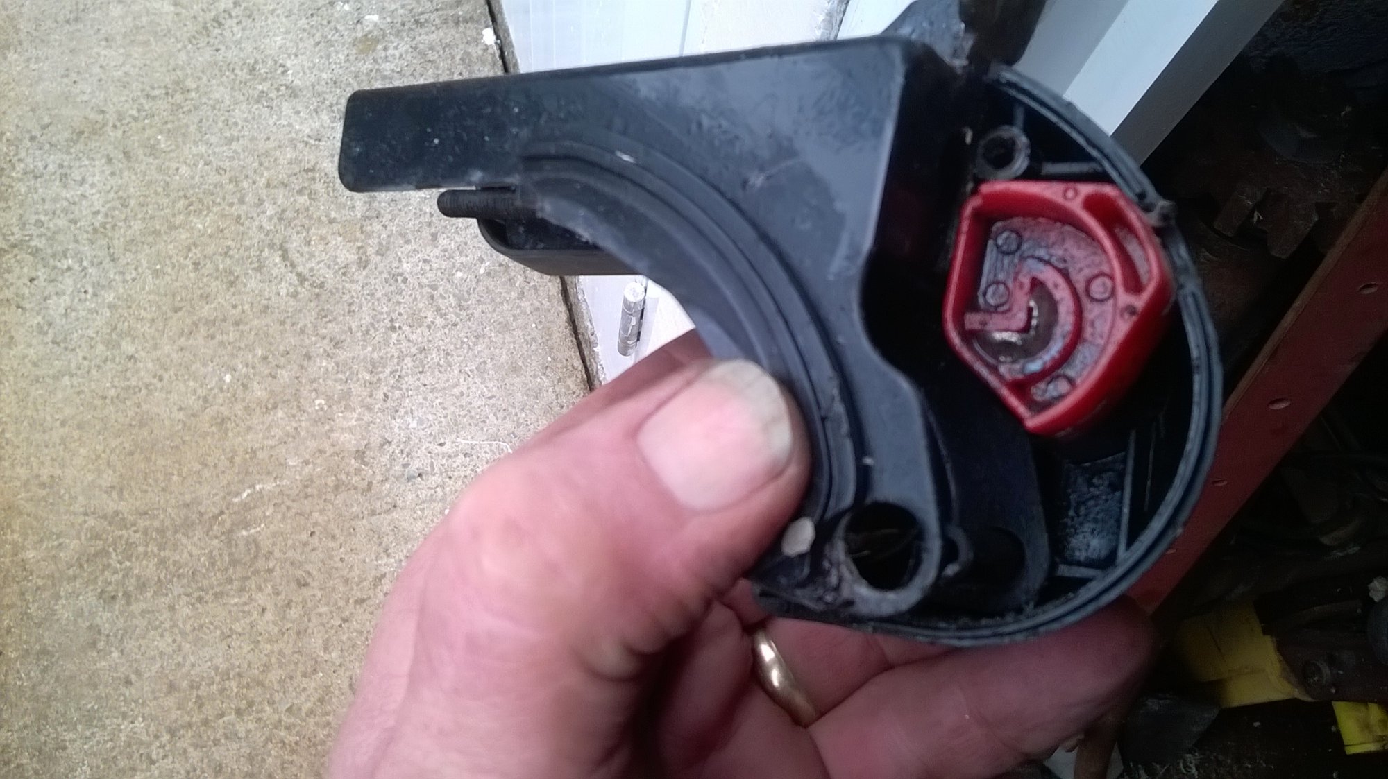

No brand marks or lock numbers sadly.what brand of roofbars? I ask as some only have one or 2 key options only....

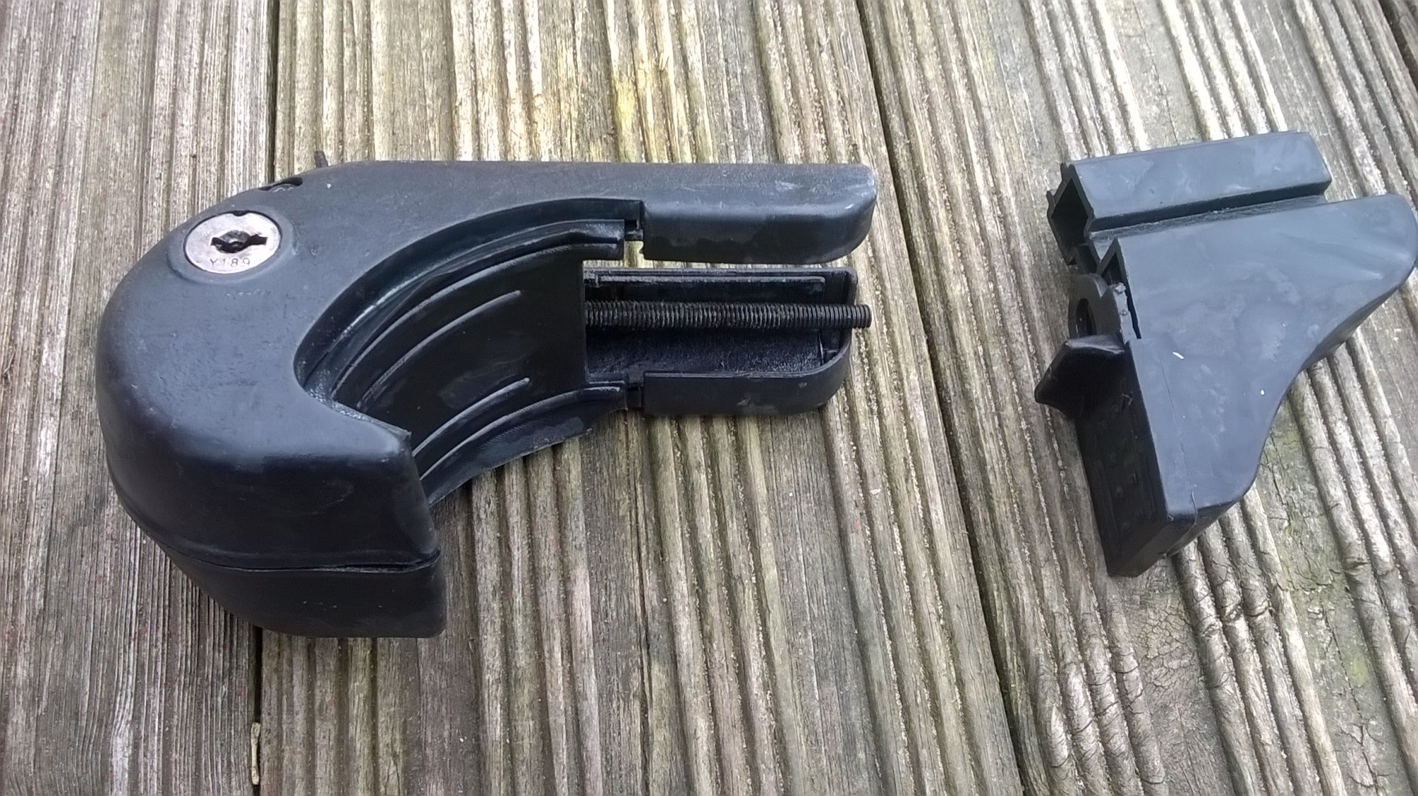

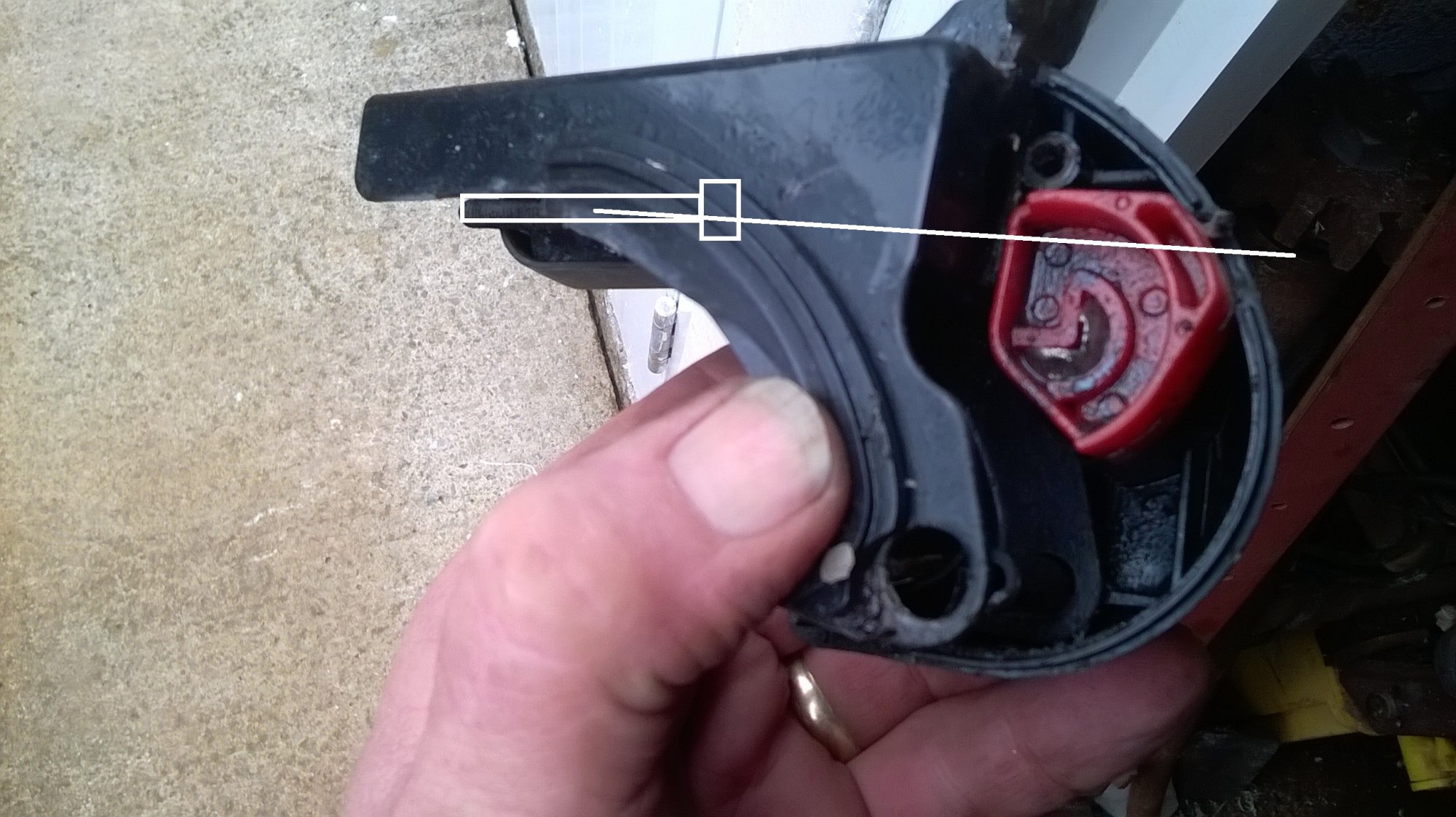

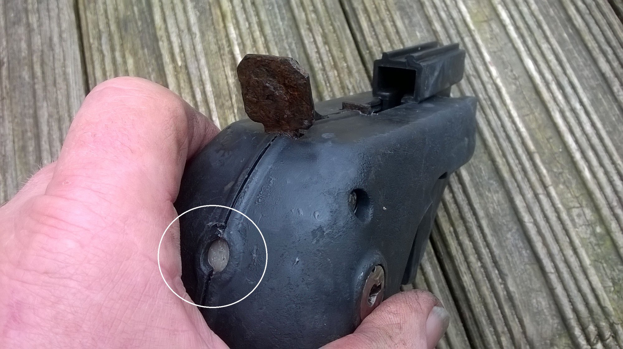

Thanks for that, the roof rack was exactly the same as the one you have, unfortunately I have already cut it off! The locks were corroded and locked shut.If you have not already wrecked the lock then it should be possible to remove them with out the key. The key simple uncovers a hole that a VERY long allen key goes through. You should be able to drill out a hole in the red cam and then insert allen key (the long key would have come with the bars !).am has bleached
Note the red cam has bleached white where the hole is !
