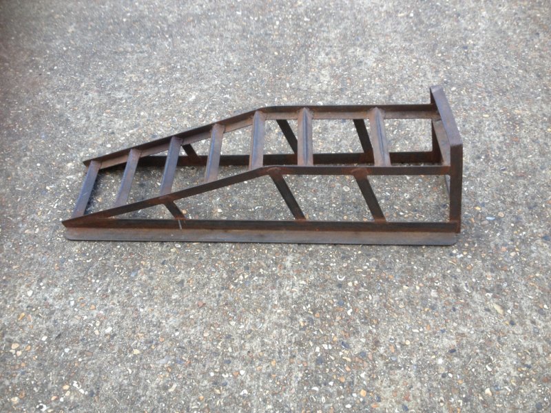

i made a thread ages ago about making a set of car ramps to my own specs, and was advised against this due to only having a 100 amp flux core mig.
now, i recently bought a set of ramps as axle stands just weren't enough. They arrived today and after looking at them, they are made from 20x20x2mm angle steel (looks pressed to me) and its all held together with tacks. Now i have put the car on them, with the front on the ramps, jacked the rear up and put on axle stands under the sill jacking points, and have had me and the not so small neighbour sit in the car with 100 kilos of weights in the boot (wanted to get as close to 2T as possible) and all is good, not even a creak from the ramps, no deformation of any kind.
so the question is, if i buy some 20x20x2 angle and seam weld all the joints i should have a set of ramps at least as strong as the ones i have bought, or am i missing something here?
obviously i now have a 160 amp inveter so am not worried about penetration but my little 100amp mig will blow holes in 2mm all day long too so in just wondering if i could have done it myself after all
