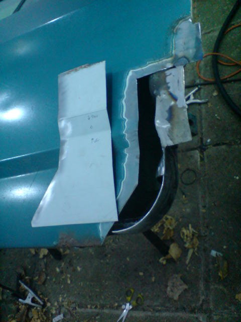

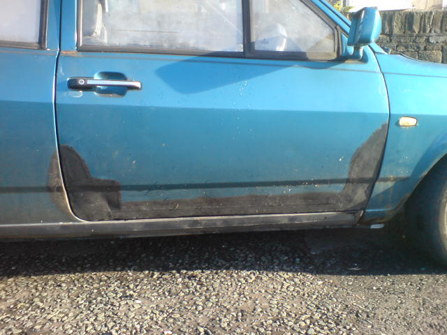

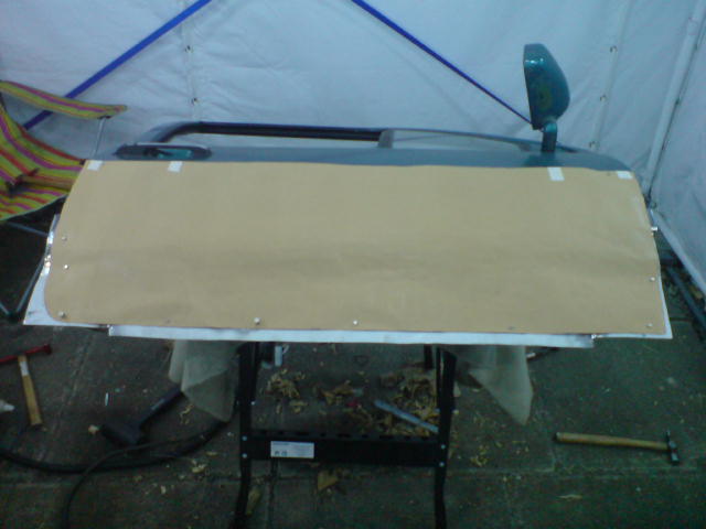

Ive got 4 car doors that are suffering from tinworm, and earlier this year I got round to repairing the bottom of the worst of them. on this one the inner and outer skins had separated and they were held togther with duck tape, With my cars, its easy to see the work thats been done on them as I dont fill or finish the repairs, I just paint them. With my cars the bottom of the doors isn't just outer skin folded over the inner skin, its got some complex shaping. there is no way I would try and copy that, so I though if I built the frame and then just mig weld the bottom of the outer skin to it it would be fine.
when I did this door I dis post this thread about how I try and keep distortion to a minimum

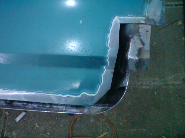

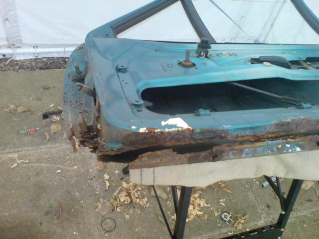

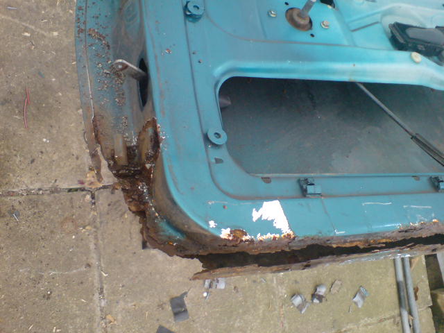

as you can see there it wasn't too healthy

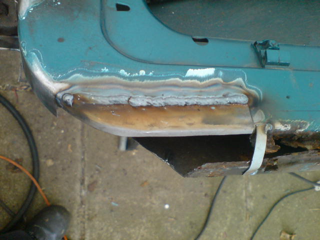

so bits were cut out and a few sections were formed to start rebuilding the frame

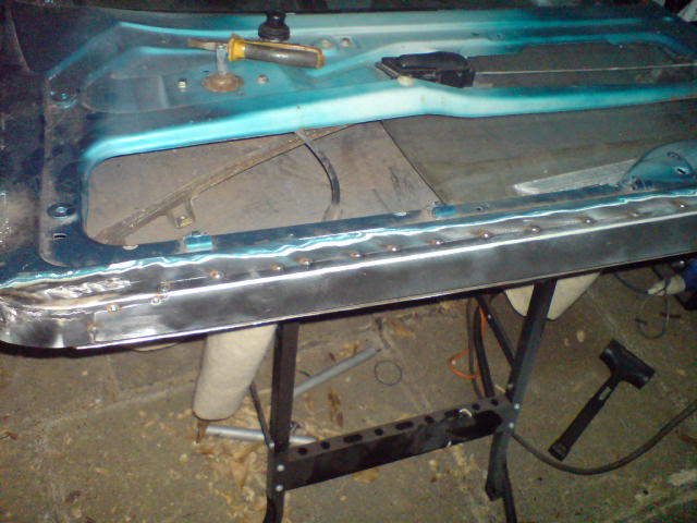

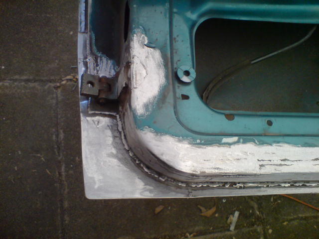

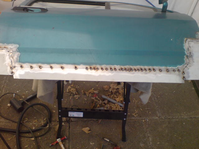

a new bottom edge held with intergrips before welding

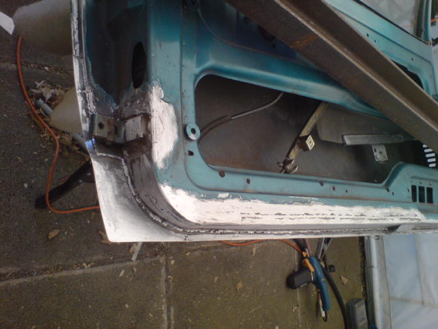

and then tacked in place

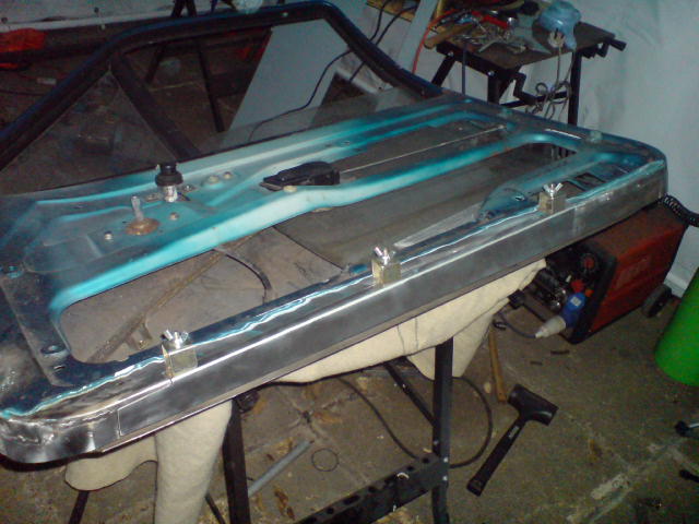

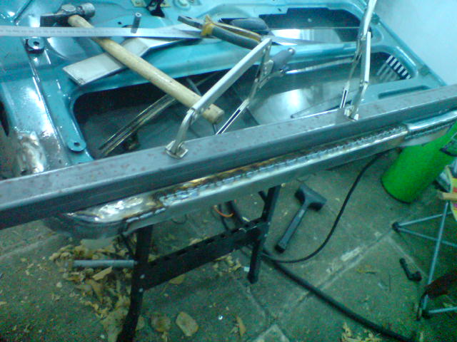

and using some square tube to try and keep the frame flat

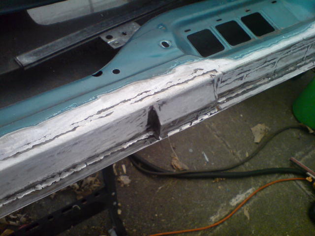

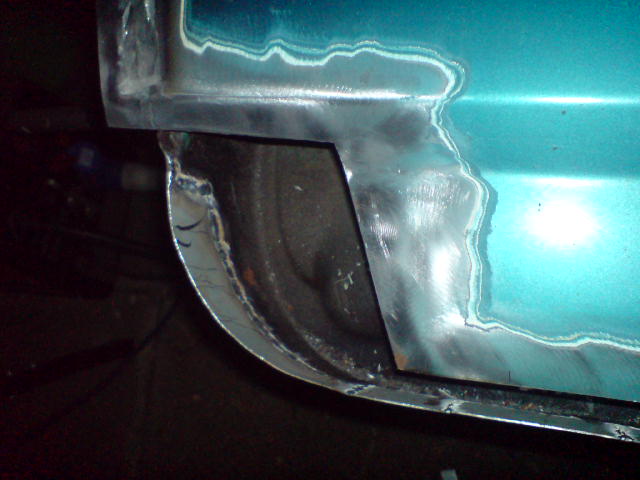

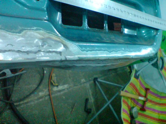

most of it was fine but this bet ended up being as bent as a £9 note. I think this was due to the heat from the welding releasing the stressed that where locked into the panel there when it was pressed due to the complex shaping, it was easily sorted by slitting it with an angle grinder and then welding it up again.

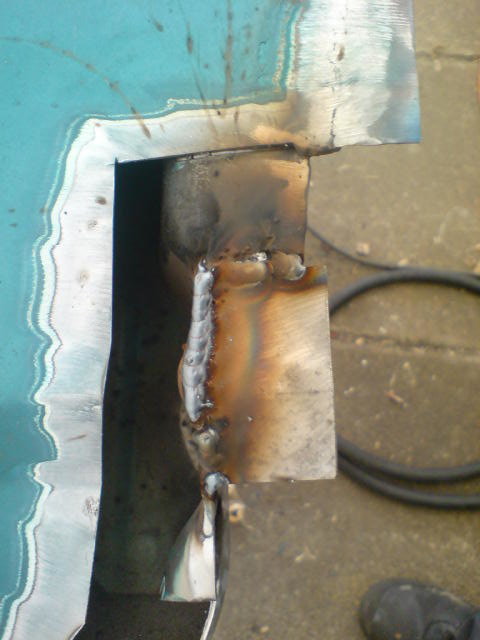

penetration in the inside looks good to me.
