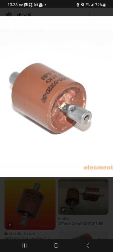

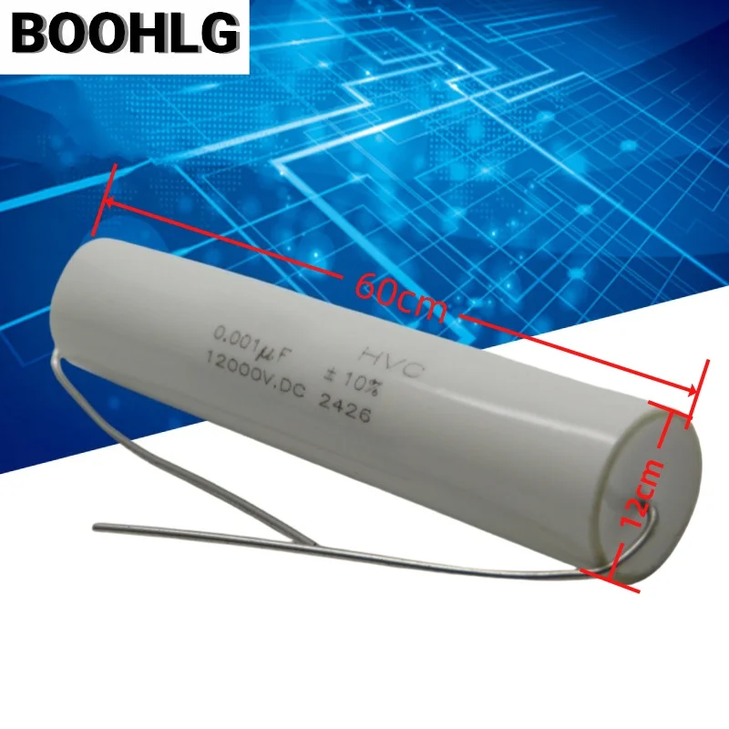

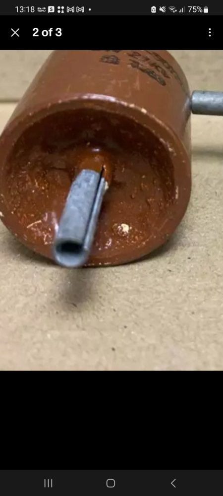

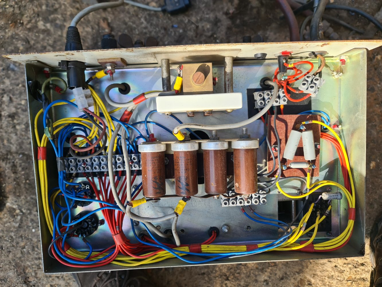

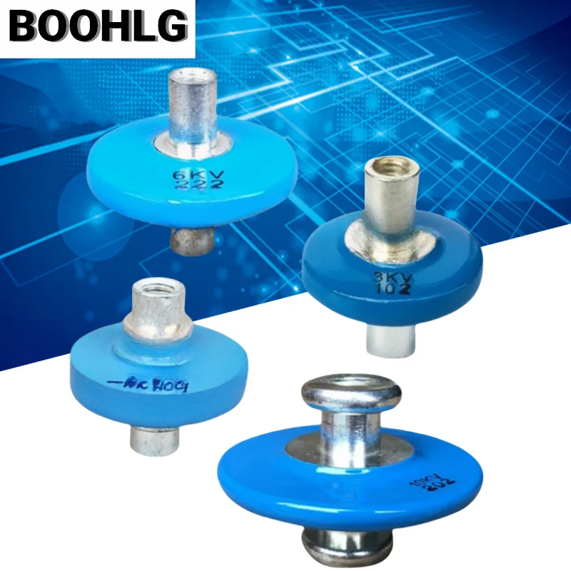

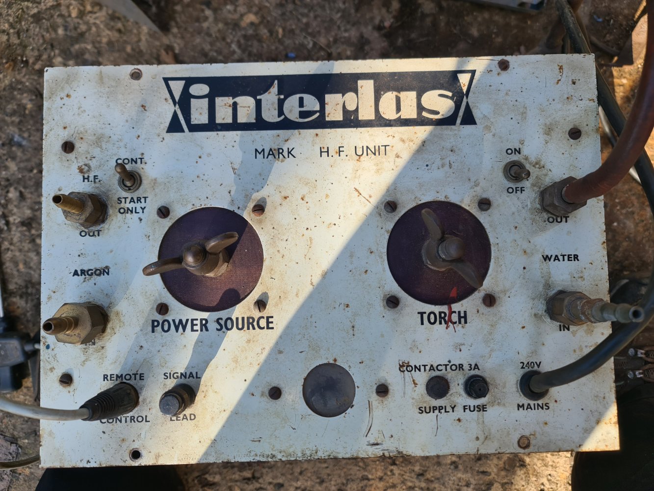

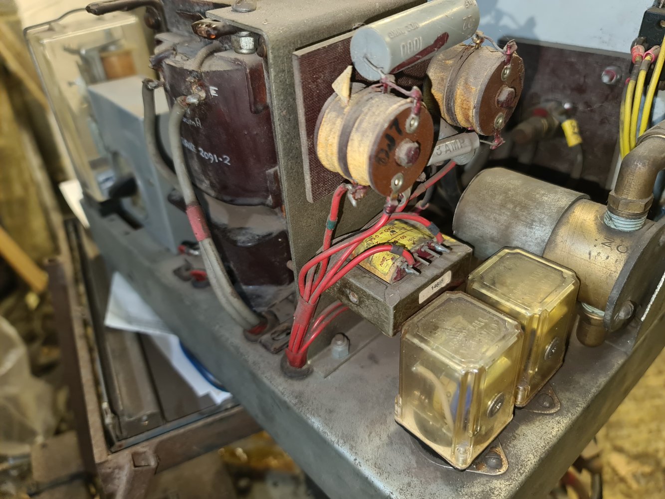

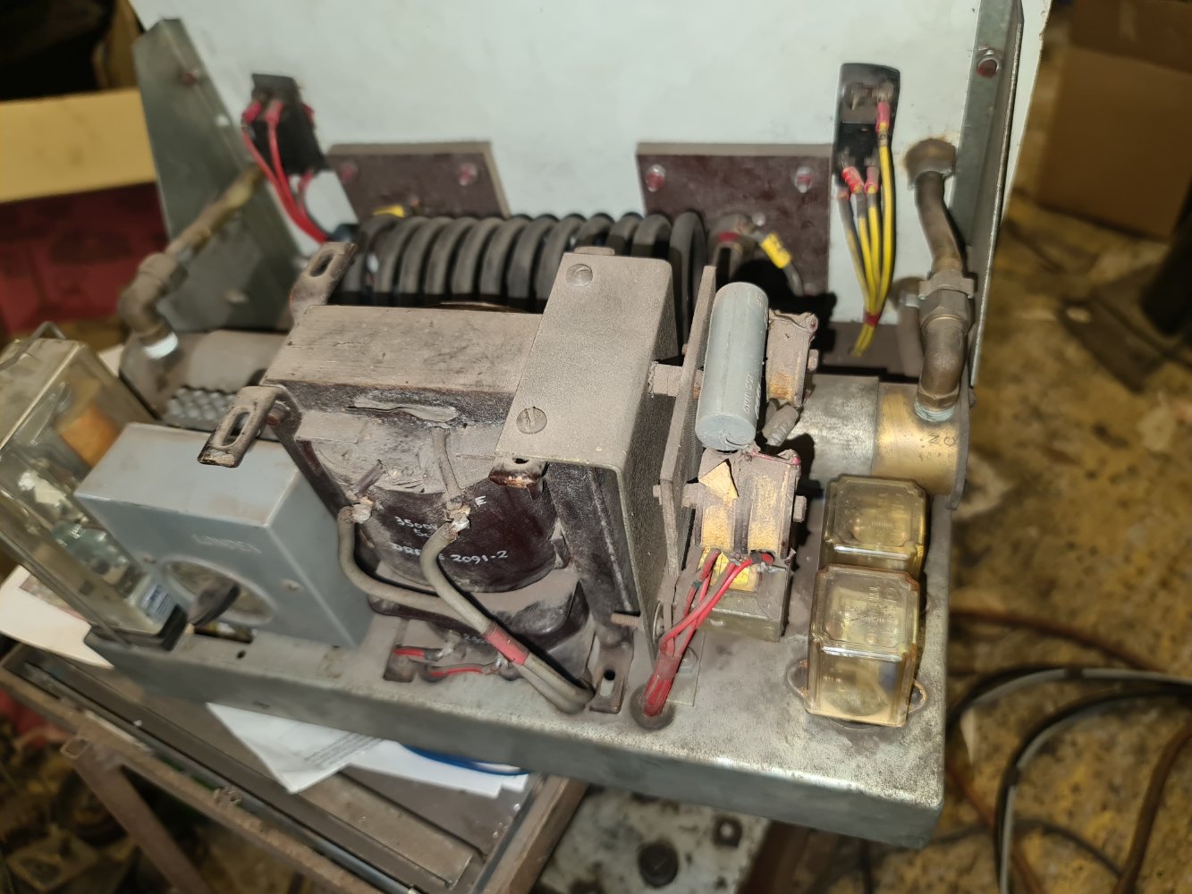

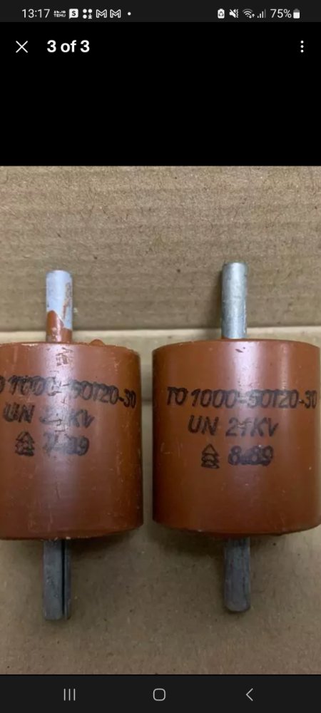

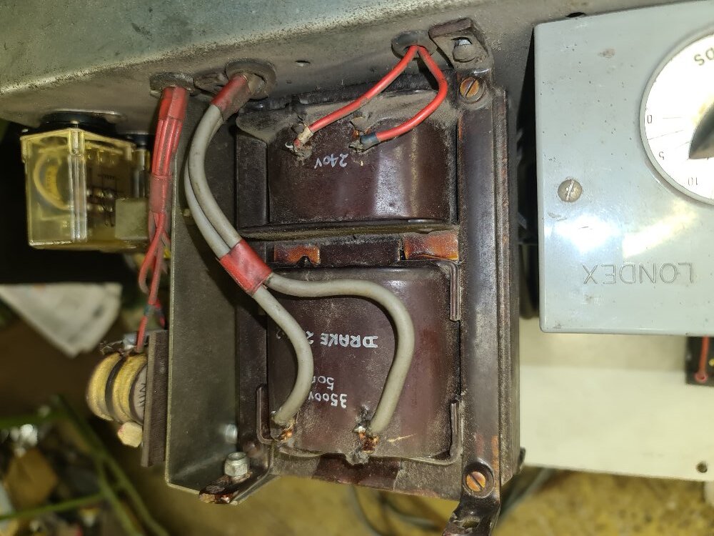

This has been lurking at the back of my garage for a while with leaking electrolytics ....there's a bank of 4 of them rated at 20kV and 1nF each. There don't seem to many options for electrolyrics looking around - at least not at any kind of sane price. I have seen ceramic disc caps of that spec available cheaply but I'm not sure how these would be combined in a replacement circuit - any ideas about how to do any of this ?

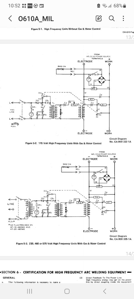

......The tig box was gifted as part of a workshop clearance so doesn't owe me anything....the HF does work but I've not run it for long with the caps in poor condition...... It's obviously had a life and is a simple thing really ...post gas flow is controlled by mechanical timer....the original gas solenoid has died and the gas is now controlled by the water solenoid (they're identical), triggered by a torch button.....Looking around it there is also an unused terminal for "signal lead" on the faceplate - don't know currently what this is for......
So really I thought I'd try to get the caps in a decent condition and then see if it welds ok....(Will I be disappointed haha...idk only have a need for AC Tig very occasionally...)
