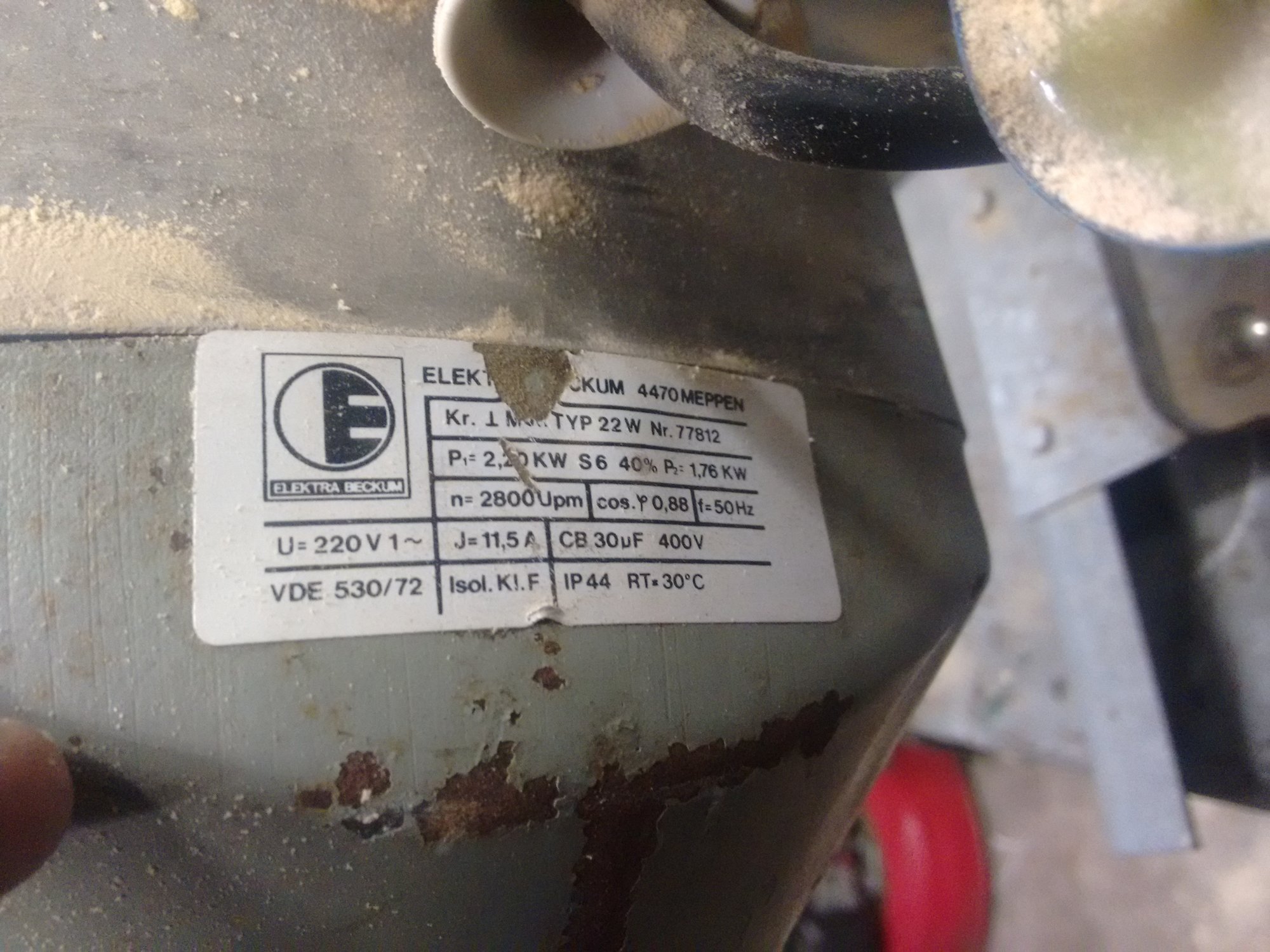

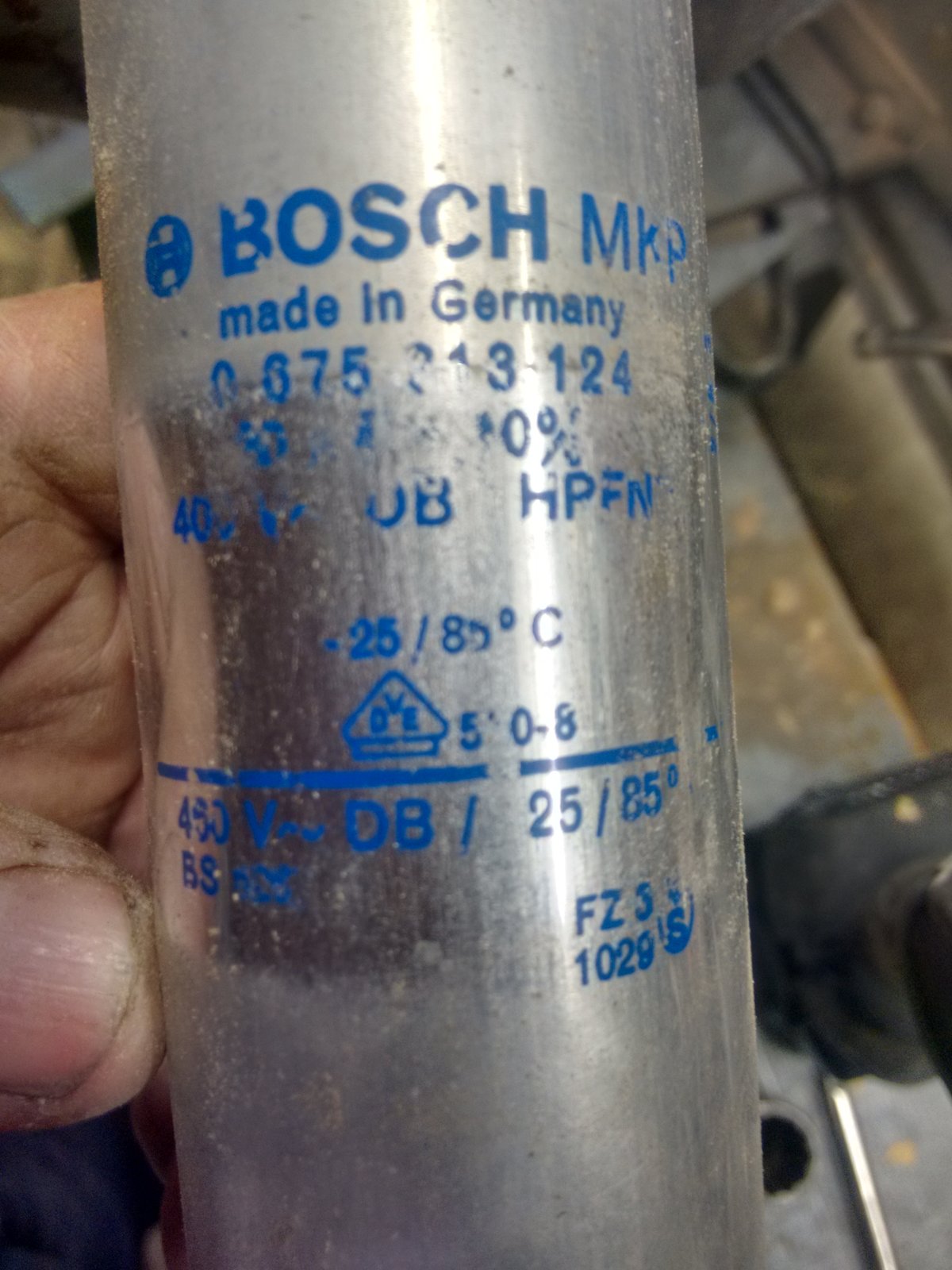

I would like to run this past people who know more about it than I do.
I have an old Elektra Beckum table saw that often blows the 13A fuse immediately it is turned on and I suspect the capacitor, the writing on the capacitor has partly rubbed off.
The motors data badge seems to say it needs a 30uf capacitor.
Searching for a 2.2kw @240v capacitor leads me to one at 80uf and one at 25uf but an online calculator I tried says Amps X 2652 ÷ by voltage eg 11.5A X 2652 ÷ 240 = 127uf
Can anyone confirm what I size I need please.
