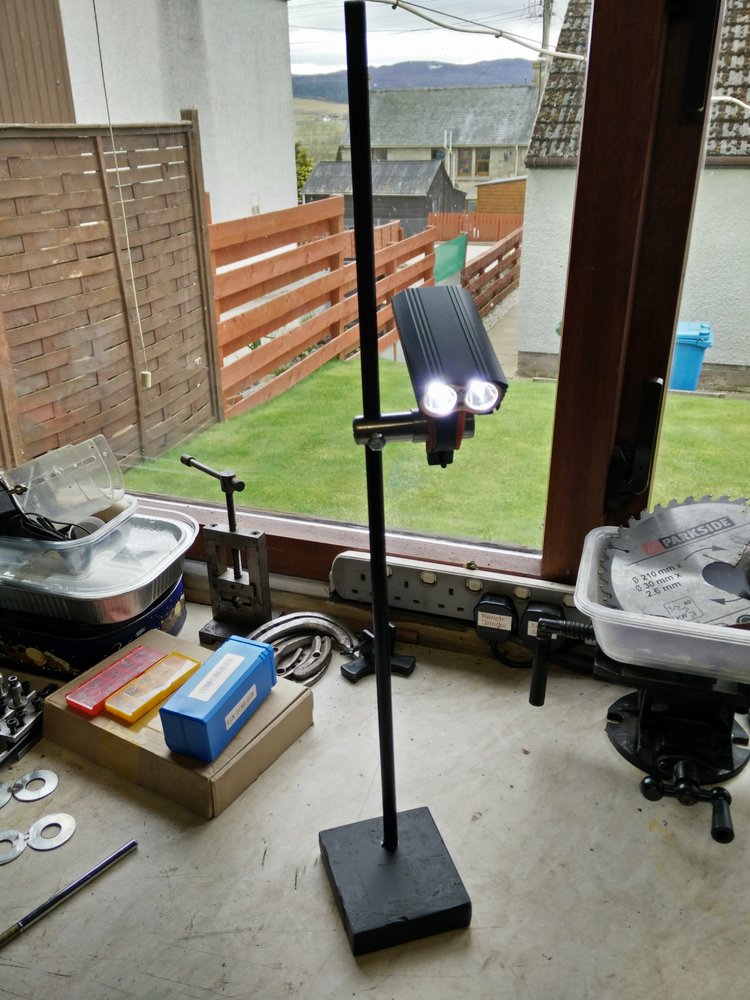

], fully adjustable and has different selectable levels of light output - works well also on other places in the shed e.g. drill, milling machine etc.
