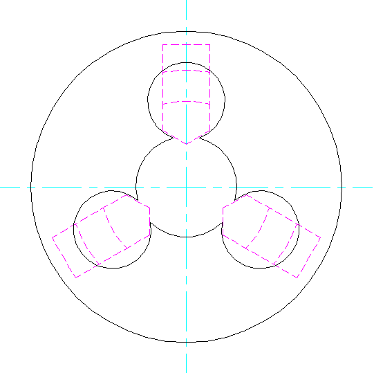

Sorry if I have confused you, not the intention at all.
The point is that you can turn a ring with an inner diameter large enough for your chosen grindstone to enter the jaws comfortably.
The die grinder, or whatever you are using, small router/trimmer, can have a mount machined, since the height, which is adjustable through your toolpost, and the Yaxis is adjustable through the lathe travel.
The two circumferences, inner diameter and grind stone diameter, will only touch in one place, so once both are spinning, the grind stone is moved in/out on the Yaxis until it touches the jaws. It does not really matter where the vertical component leaves the grind stone it will still produce the same end result, trued jaws.
Dead easy
