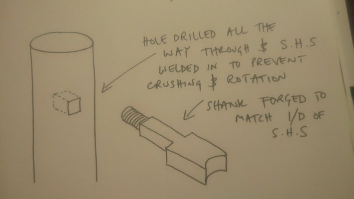

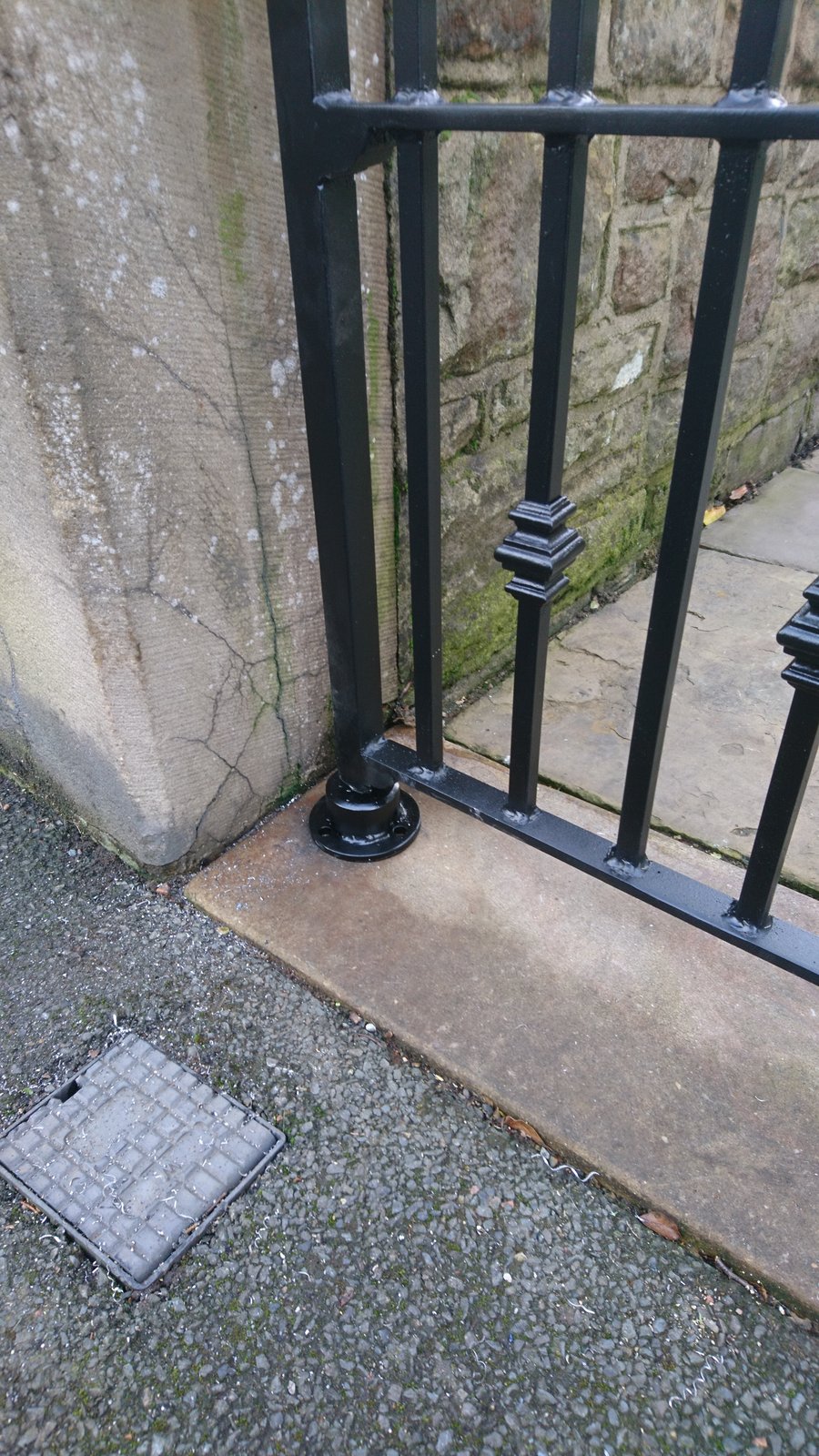

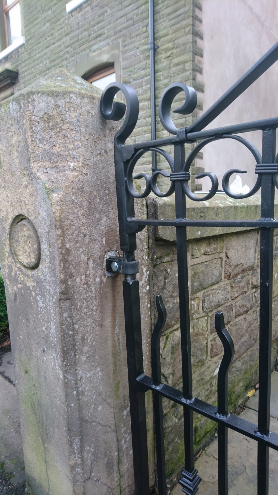

Hi all, I'm due to make some public wrought iron gates and I'm looking for some constructive input on the hinges I'm planning on forging/fabricating.

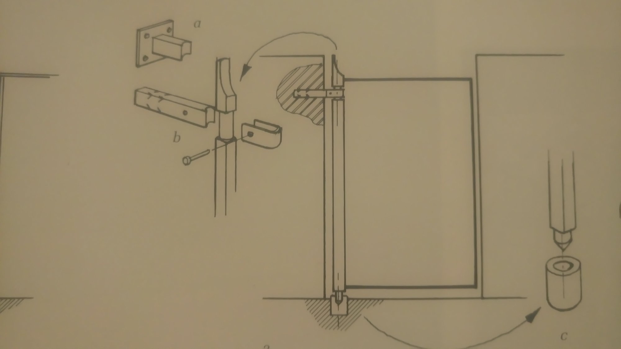

The gates are to be hung from 100mm round hollow tube & need to balance aesthetics with theft proofness. I've taken a picture of a diagram in Forged Architectural Metalwork by Peter Parkinson (great book) as I'm planning a variation on this hinge setup.

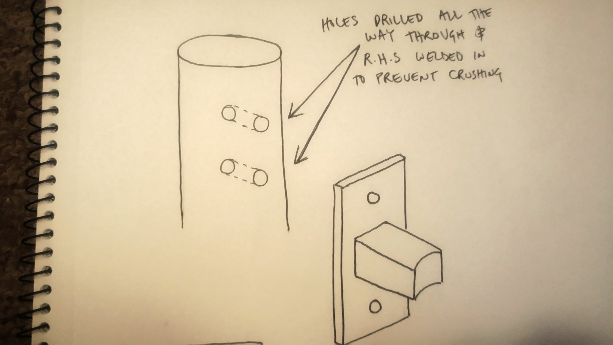

For aesthetic reasons I want the adjustibility to be on the hanging posts rather than the back stile.

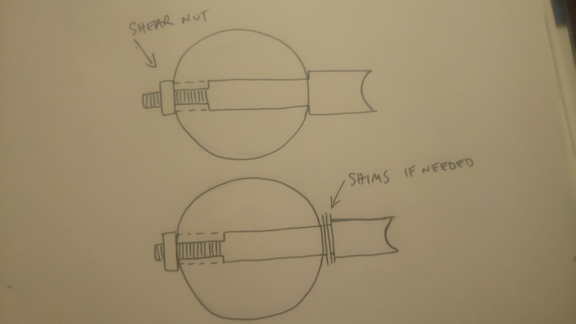

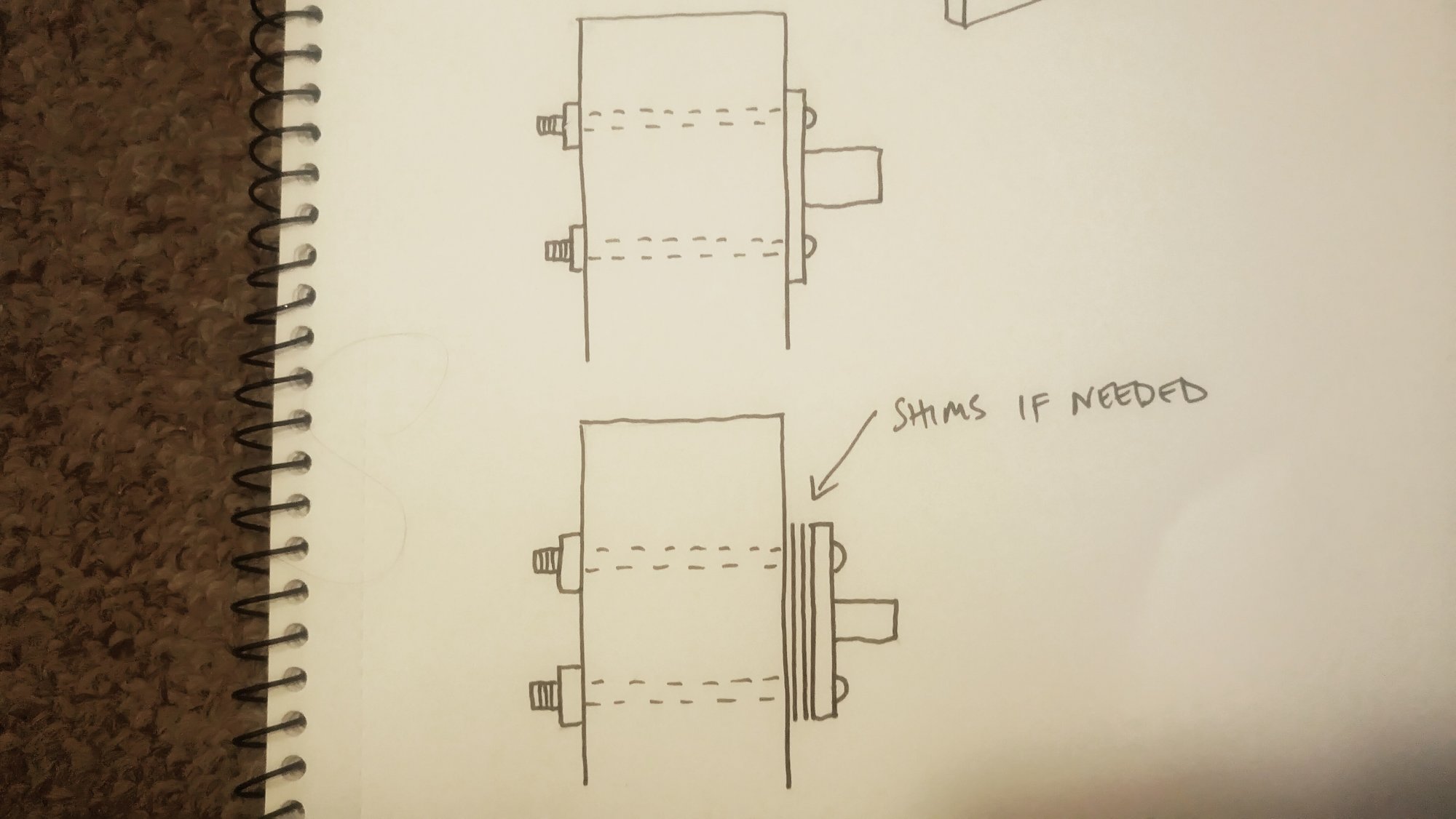

Hopefully my follow up sketches along with the anotations are self explanitory but the general idea is to allow myself adjustibility during installation with minimal aesthetic loss.
Shear nuts would also have to be used to secure the two halves of the hinge mechanism together. Shear nuts will be painted to colour match the gates. At ground level, instead of having the female part of the bottom hinge separate, I plan to weld it to the hanging post via a web.
Regarding the top hinge; the rounded up portion of the back stile would be longer than the wrap which goes around it so that if the gate(s) need to be shimmed up at ground level, I can lower the strap so it aligns with the other half that goes into the hanging post.
I'm probably forgetting something but that'll do for now anyway. Cheers
