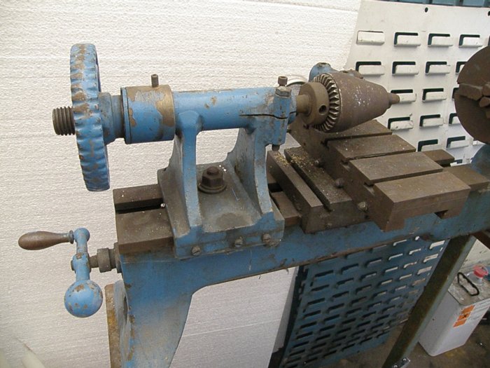

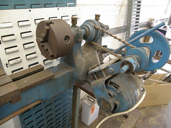

I had considered looking into making some tools for it, ill need to take a picture but my tool post is missing a T nut or something as the carriage with T nut slots is on the lathe but there isnt anything to locate the toolpost onto the carriage (probably not the right word).
Ill take some pics but any initial clues anyone?

Yes lots of clues! Many ancient type machines didn’t run a tool post as such, not in the sense as we know a tool post in the modern day. Often they would be a something like a riser block coming within x dimension of the centre height of the machine, then the tool was clamped to that’ tool post’. They used a swan neck type cutting tool to help eliminate chatter on the machine (as those bush type heads were notorious for creating chatter and are very weak machine tool design.
The above isn’t true of all machines of that type of age some varied a lot and did have a compound slide (see below)
The part you’re talking about where a tool post should be is the cross slide. (Where the T slots are.) The normal configuration as most will know it is:
Cross slide with a compound slide mounted on top.
Tool post mounted on top of the compound slide.
This in turn brings you up to a sensible centre height for the turning tools.
Its hard to say if that machine had a compound slide as original (not all did back then), unless you can identify the make and find some pics of it. The best bet is to take a close look at the cross slide face and see if there is any whiteness marks on it that resemble a shape of some form. If you can identify any it will give a clue to the machines original configuration.
You could attempt to purchase a compound slide off a broken machine and adapt it to fit the cross slide of your machine. You will have to keep a close eye on the height available to ensure you can get the centre height you need if you go down this route.
