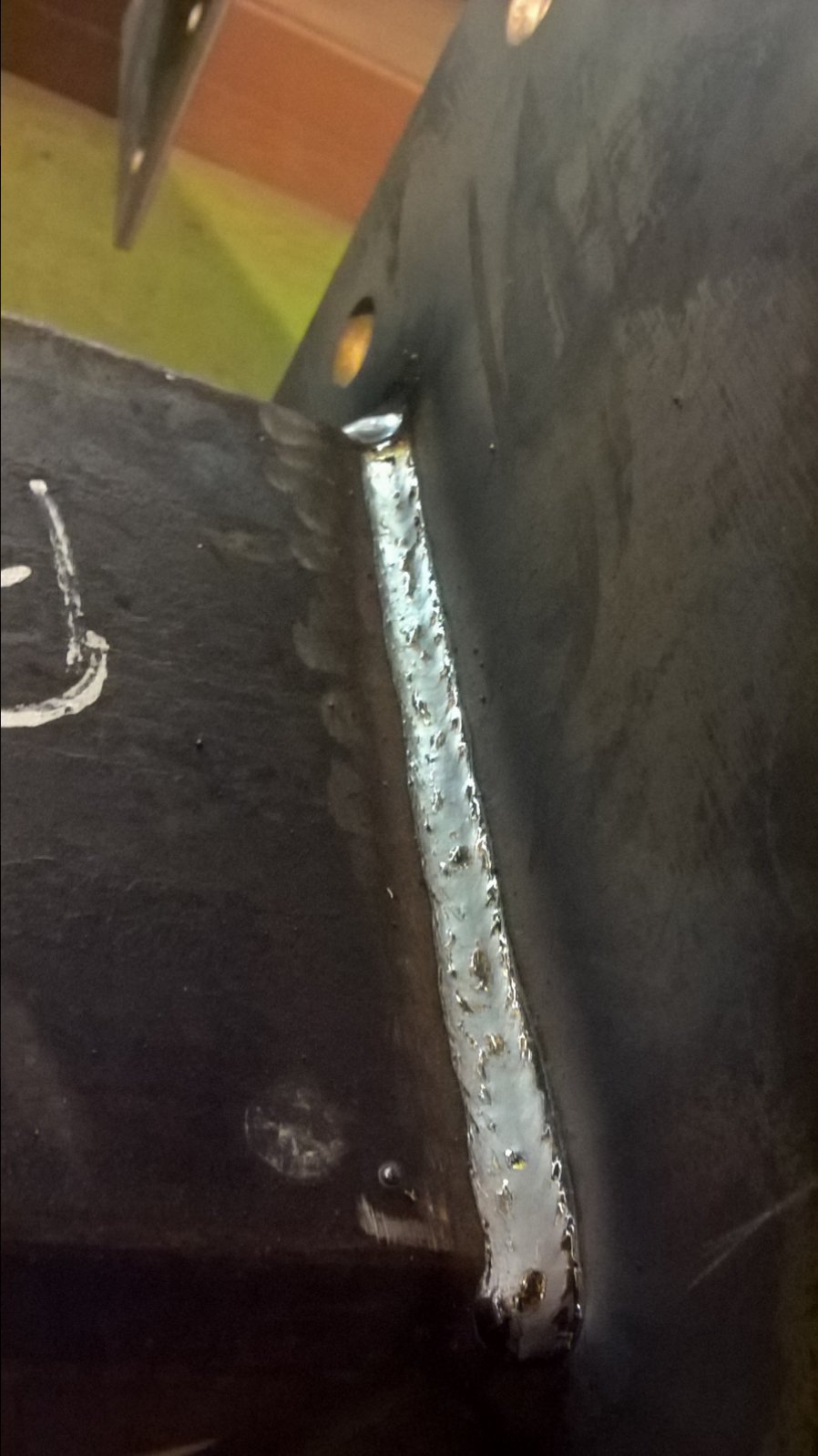

last weld of the day and it felt off like it was to hot I was in the wps spec of 30 volts 285 amps travel speed was a little slower then reg but its a 6 flw on 12 mm box and 10 mm plate. Dropping the voltage gives me shed loads of spatter and turning up the wire speed does the same
