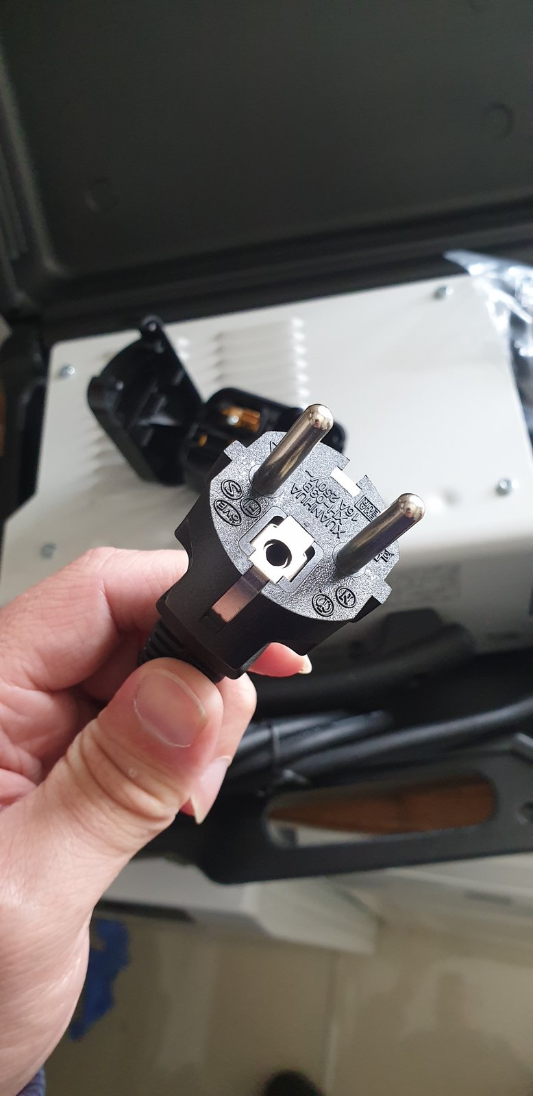

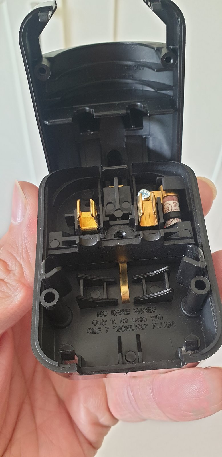

This is the plug on my new arc welder. For now I want to run it on 13amp. Does the plug fit into this uk adaptor either way?
If so is that not dangerous? If she blew the fuse due to a fault could the machine not still be sitting live due to the neutral pin being at the fuse?
