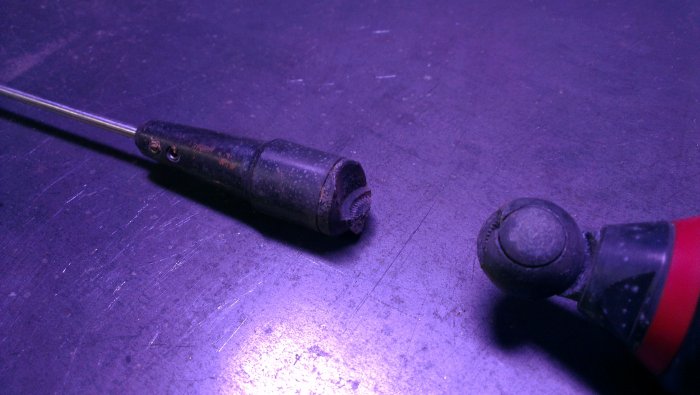

Wouldn't be too difficult to remake 'a' mount. Get some close fitting tube over the bottom of the aerial, slot it out, and crimp it on with jubilee clips. Then do whatever works best with the other end.
Its defo not a dv27 but it may adapt to fit.

chances are there is a coil inside that base and the insulation on it will be destroyed when you weld it, so even if the weld is successful I doubt it will work again
