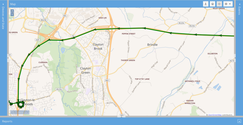

At present I am planning to use it by sending a SMS message to it, it responds by SMS back to my own phone with a web link giving it's location. I can open the web link in Google maps and it shows me on the resulting map where the device is.
