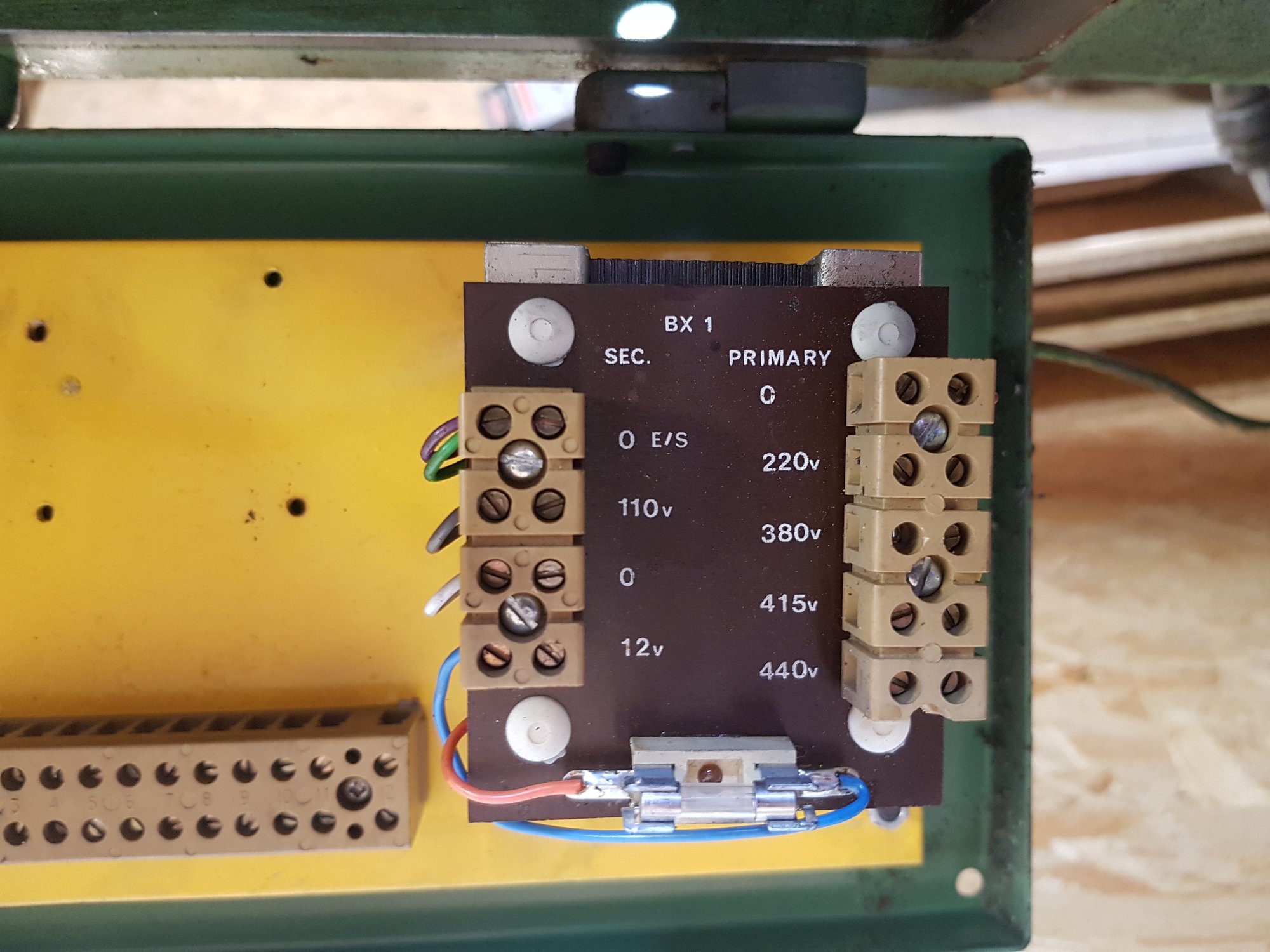

This small transformer is located within the electrical cabinet on the back of my Boxford vm30 mill. I have stripped out all the wiring from the transformer as I will be powering the motor by an inverter.
The work lamp is 12v and I'd like to keep it and have it operational. So, the question is can I have a 240v input on this transformer and get 12v out?
