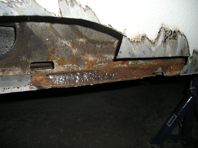

Following on from the 'Patching a sill on a Pork' thread, here is what I found when I canned it open:-

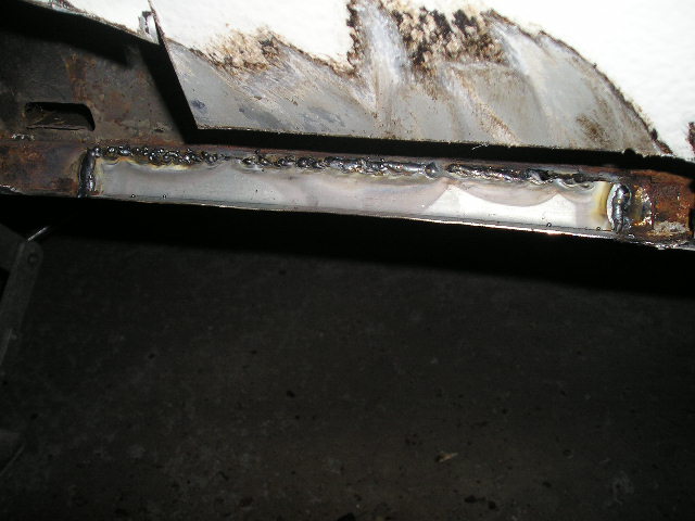

What will happen if I try to weld to the semi-shiny stuff in the centre. If I cut any further back, how do I make up the patch; it's a strange double curve as shown here from below:-

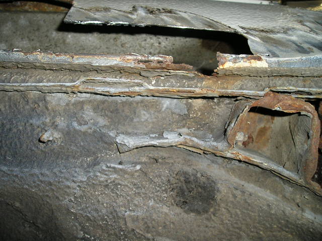

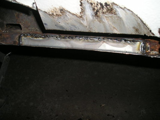

I bet this one's been done to death but when I started cutting I found evidence that someone's been there before. How do you guys stop (or slow down) the rust once you've patched? The reason I ask is that if I cut it all out, I'll end up on the other side of the car......
