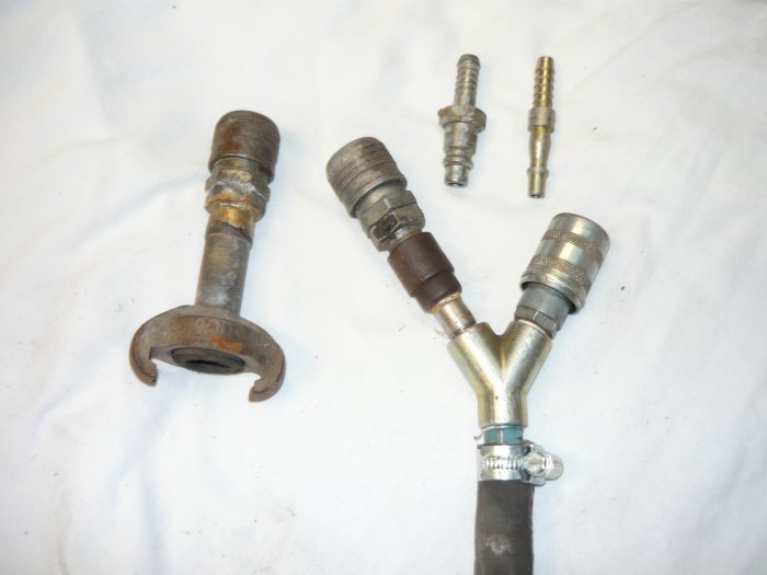

3. After the filter stages I have to run the air across the back of the house to the garage - about 10m. I can't use fixed pipes, but will have to go with flexible tube and quick release fittings. What would be the best size and material to use for the tube? Which type of quick release will give the least restriction to the flow?
