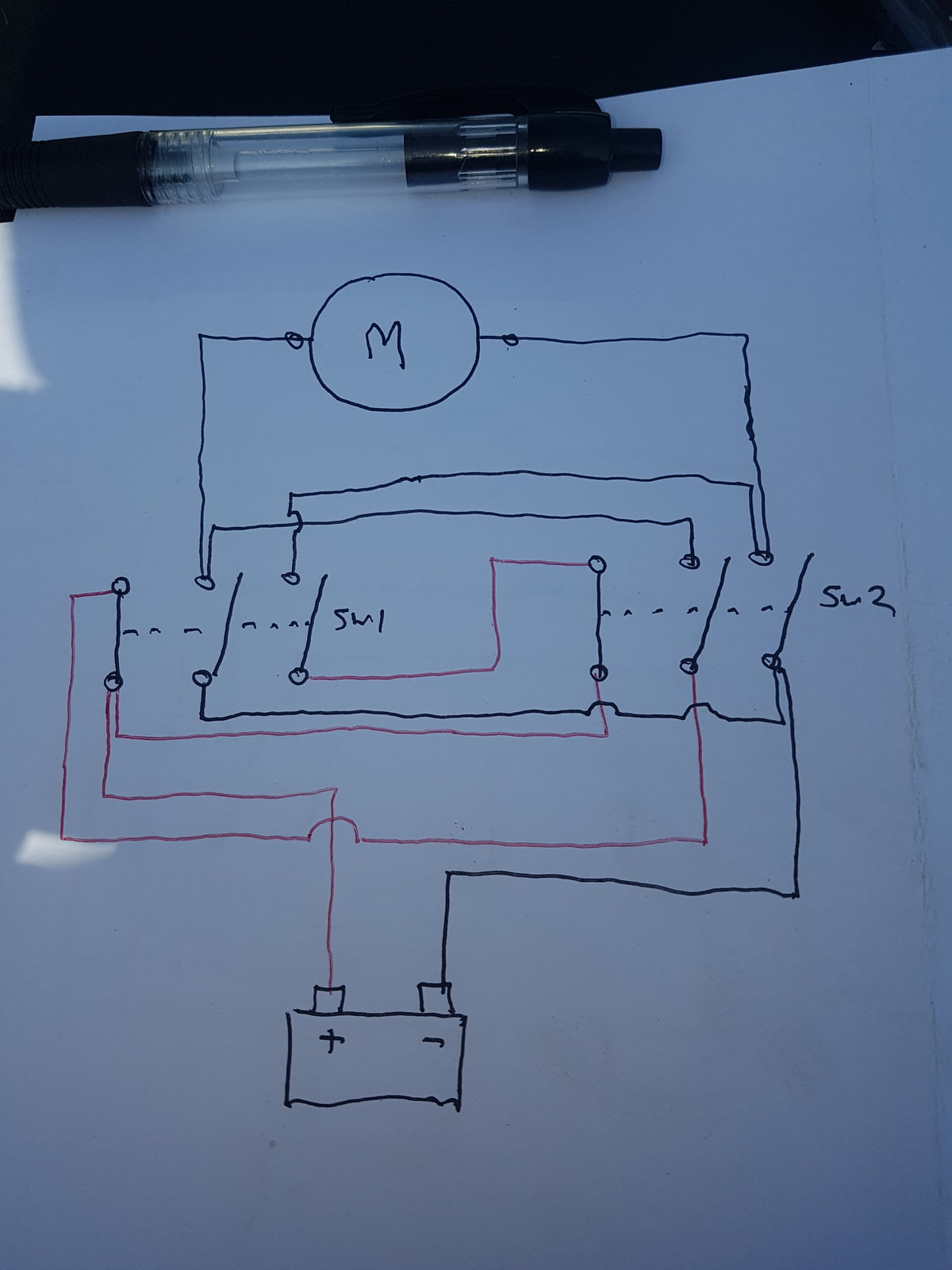

So I need to run a DC motor in both directions.
I will be using a pair of momentay push switches. These both have 1xNC contact and 2xNO contacts (they are modular switches so i could change the contacts if necessary)
The NC contacts are just in there to prevent a short if both buttons are pressed at the same time.
Basically pressing one switch makes the motor run, press the other and it runs in the other direction.
I think I have the wiring figured out but just thought a second pair of eyes might see a simpler/better way of wiring it up than what I have come up with!
