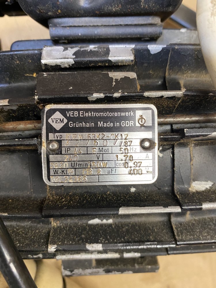

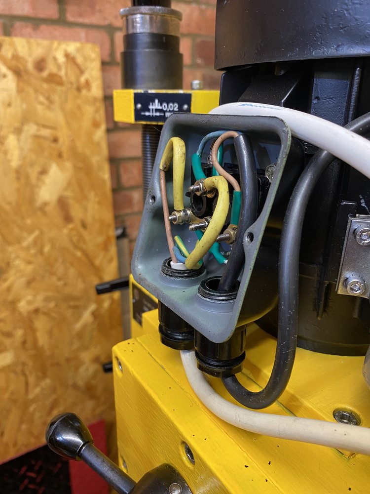

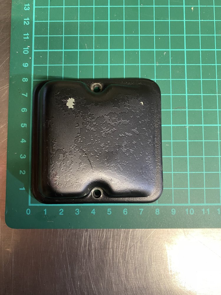

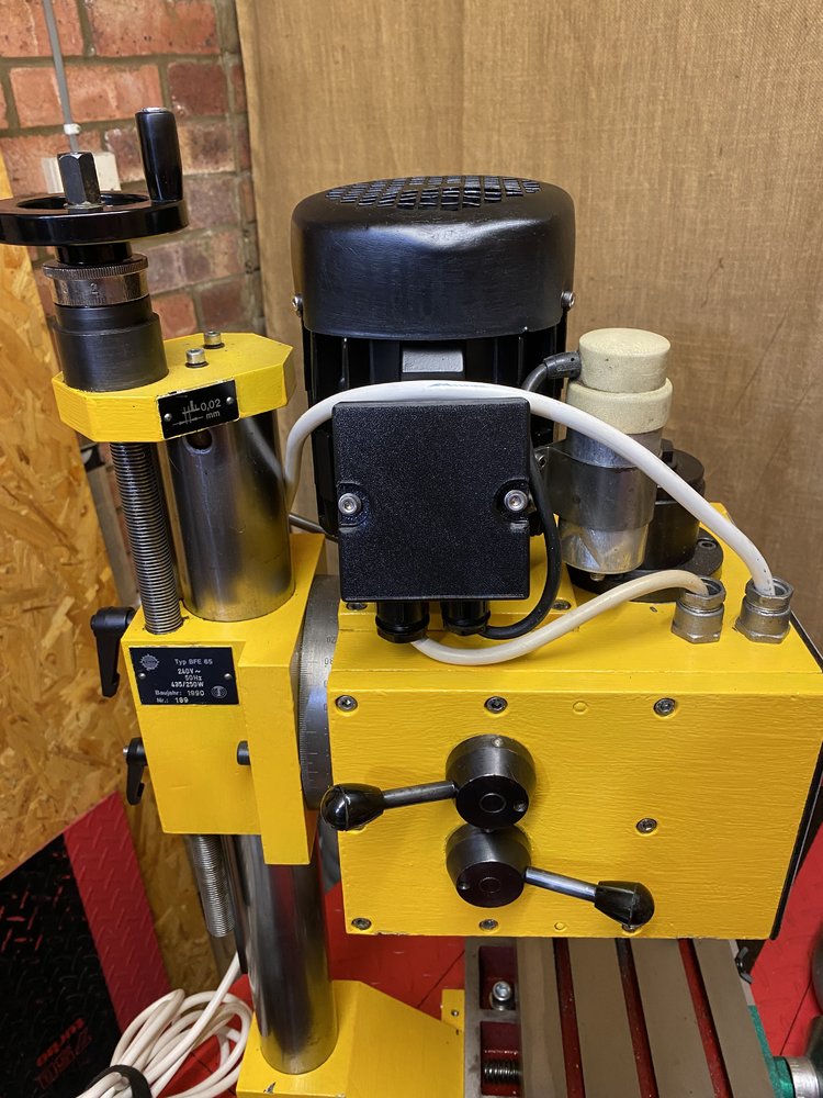

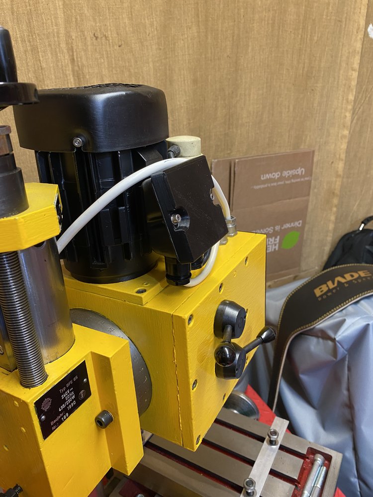

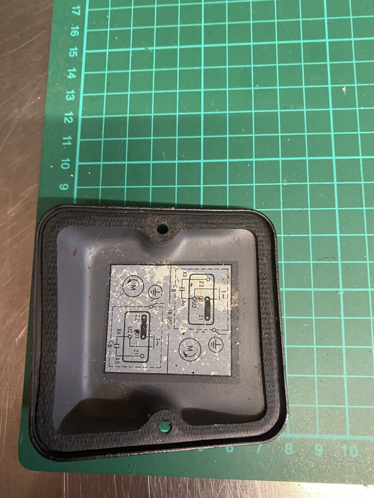

ID base is 75mm x 78mm, slopes up OD from about 5mm to 25mmPost the measurements up... i may have a proper one at work... what make is the motor?

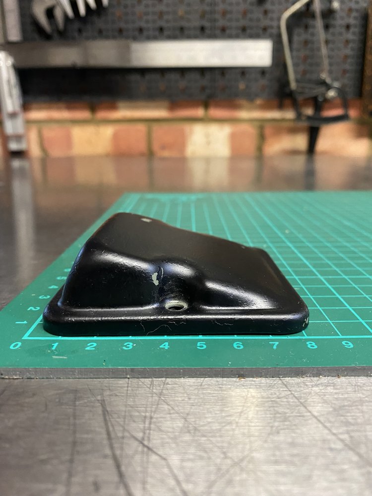

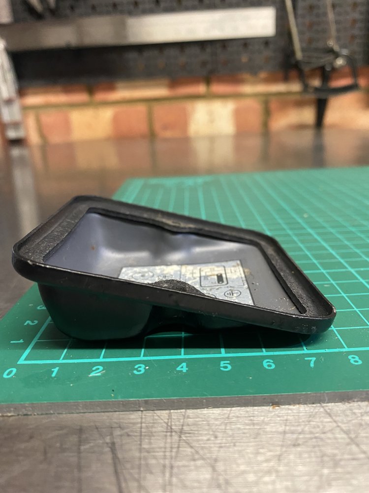

Would you want it to be a "perfect" replica? Could the curves be squared off?

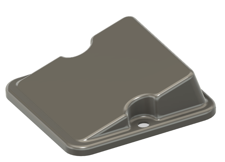

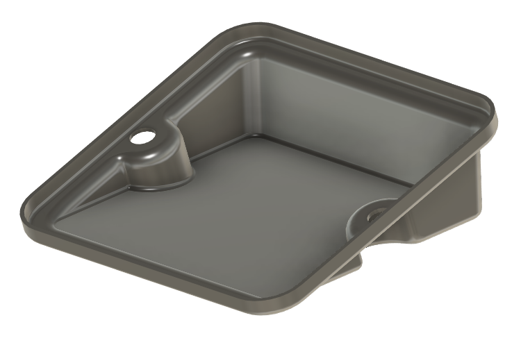

As much as I dislike the idea of a 3D printed wiring cover, it looked like a challenge to model, so I had a go:
It was looking forward to bashing Sketchup and saying there's no need to square it off in a "proper" CAD program, but it was actually a lot of faff to get the chamfers to behave properly.![]()

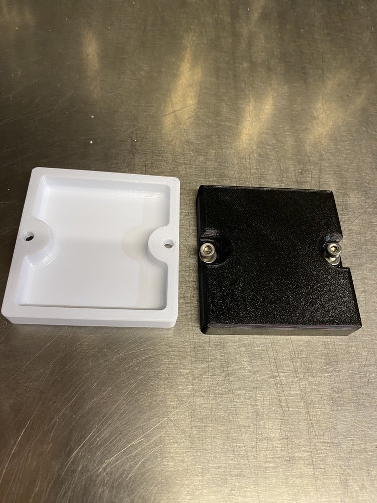

Fair enough, I didn't know it would be so hard to print an exact copy (I've only ever had very simple blocky parts made), but the strength and surface finish issues are exactly why I don't like (FDM) 3D printing.
The images I posted look so neat because I turned the lines off before taking a screenshot.They always look so neat and clean but for sketching out ideas quickly, the enormous power of the program just makes speed an issue.
No rush mate, if you could have a nose when you're there would be appreciated in case you have something similar.Got diverted to an emergency job today, so never had time to have a rummage under the bench
Wont be back there till tuesday
The detail in that looks great and so smoothAs much as I dislike the idea of a 3D printed wiring cover, it looked like a challenge to model, so I had a go:
I don't have a problem with plastic parts, just 3D printed parts. If you wanted to 3D print a former and vacuum form a plastic cover I'd be all for it.Not sure why you wouldn't like a well made plastic cover on a wiring box, given the GDR 60's pointy out metal connectors I would prefer it.
