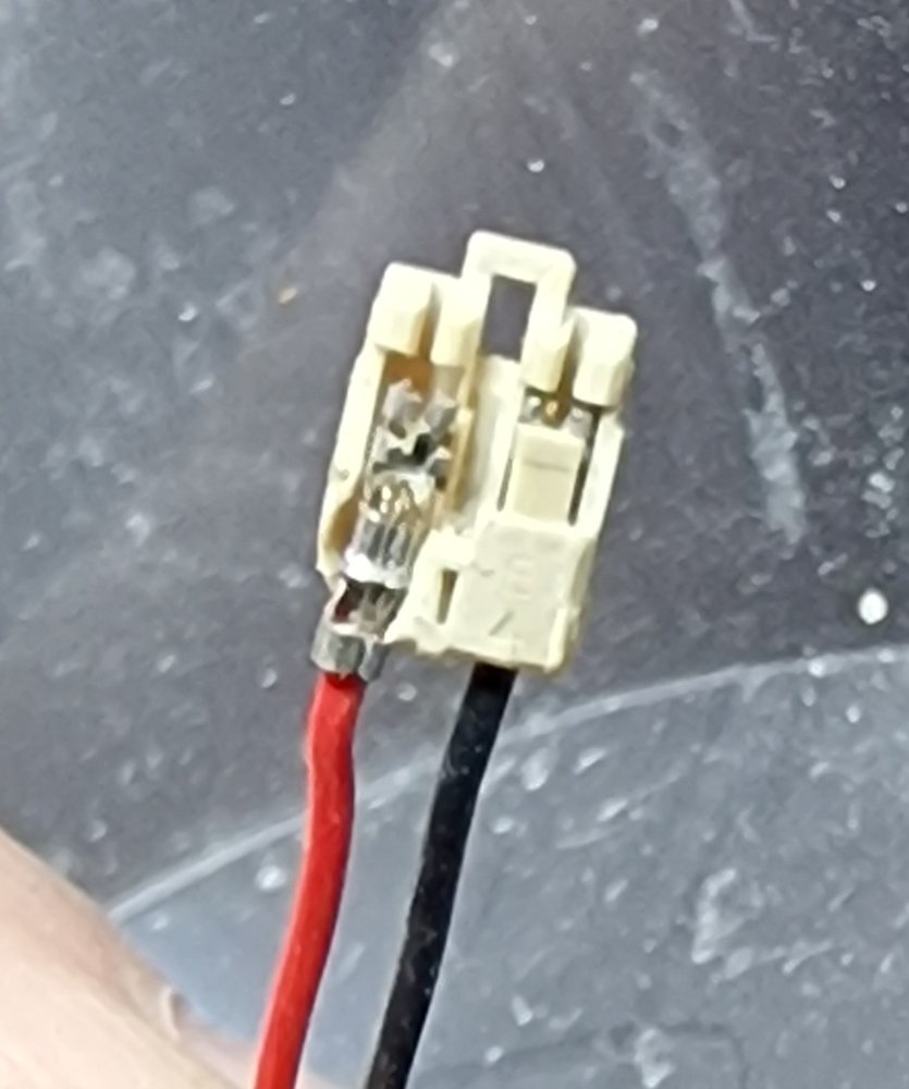

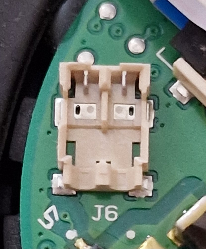

Seadog Save the planet. It's the only one with rum! Messages 12,874 Location NE London - UK Mar 5, 2024 #1 I've had no success in trying to identify this connector. Does anyone here have a clue? Used on a Dyson V10/11 pcb.
Seadog Save the planet. It's the only one with rum! Messages 12,874 Location NE London - UK Mar 5, 2024 #2 Yes, I can It's a Hirose DF61. @sako243 have you placed your mouser order yet?
