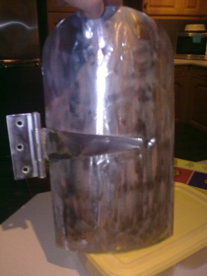

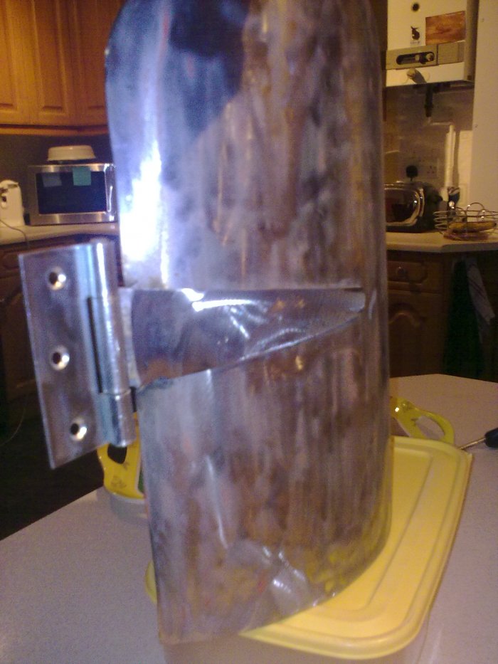

pedrobedro Man at Matalan Messages 13,116 Location CX near Chesterfield Nov 3, 2009 #22 Or as my wife remembers it, lefty loosey, righty tighty A good tip I read is to cut out one side of your door then weld the hinge on before you cut out the other half so you know it will line up with minimal gap.
