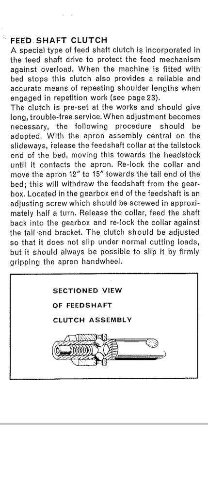

Hi folks,
Anyone know why the power feed on my Triumph keeps dropping out even under light load. In the manual there is mention of a ball bearing clutch/overload protection to prevent damage in the event of a carriage crash but I can't find it!
If you keep steady pressure on the handwheel it is usually fine, not had any problems with the power cross feed though, just the carriage.
As usual, any help much appreciated.
Cheers, Dan
