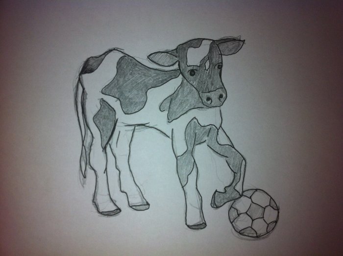

I have been commisioned to make a sculpture of a calf playing with a football as a memorial to a young guy.
I get the interesting jobs.
I have been given a drawing to work from
A huge help, saves me trying to draw and gives me loads of pointers as to where I am heading.
Oh and thanks for advice regards how big these things are.
Any ways I made a start today.

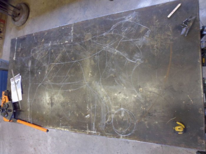

First up I drew a full sized outline on the workbench in chalk.
Very vague, two head positions and vampire teeth.

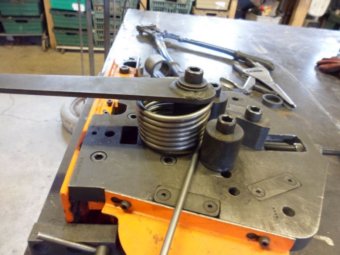

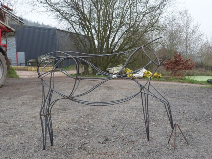

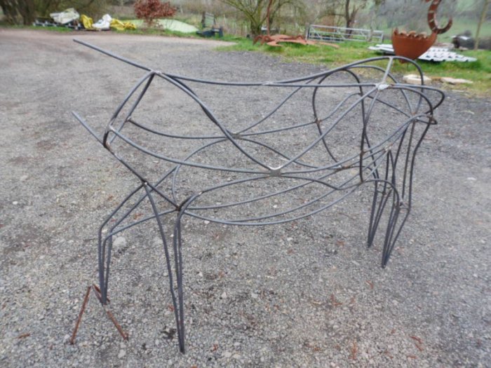

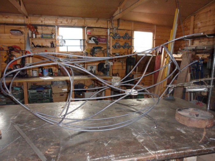

so I set to work bending up 10mm black finish mild steel bar, not used this stuff before, nice stuff to work with. Forgot to photograph the process, but finished the torso today. Ok so not to calf like, but look at the butchers and think of the headless limbless carcasses.
So far I think I a doing fine, what I am after is a almost a cartoon of the subject.
Next up are the legs. .....
