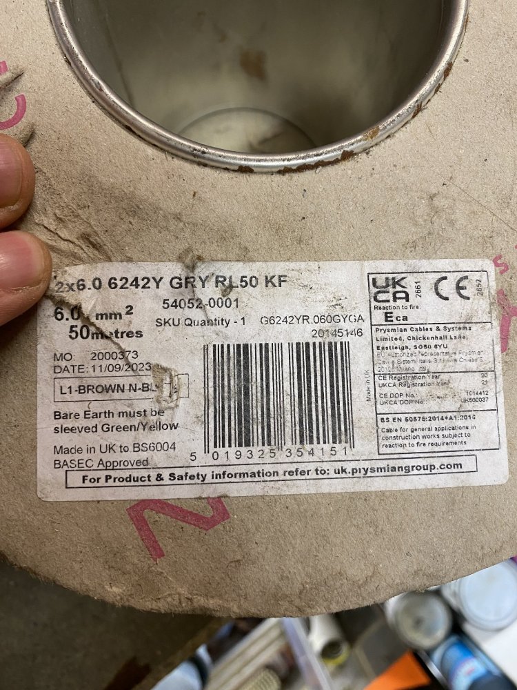

Looks like the range cooker is going to have to be replaced as despite recent fixes it is on the blink again. Currently it’s a gas only but when I rewired the kitchen decades ago it had an electric oven so I ripped out the old and dangerous electrics and replaced with new but I can’t remember what with.

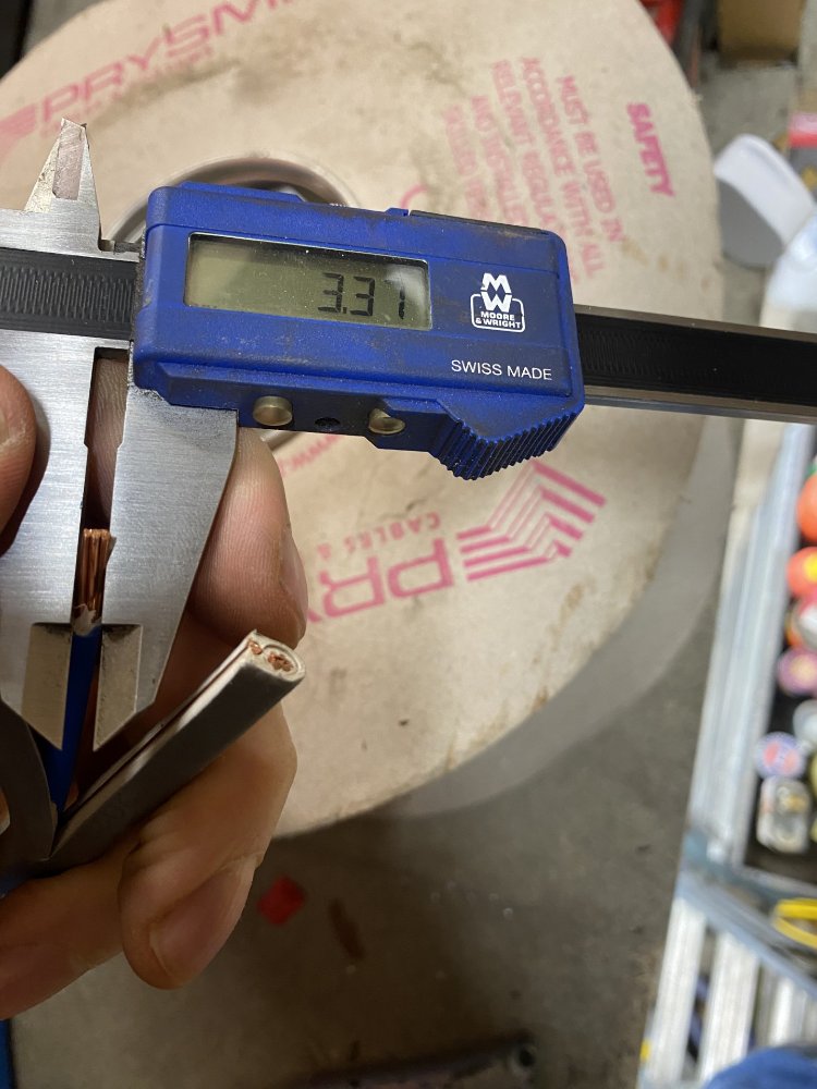

Consumer unit has a 32a breaker for the oven and the cables are buried to the isolator switch and again to the connector. I'm not prepared to start pulling plaster off just so I can read the cable so removing the isolator switch I can see the cables are the older black and red, the conductor (multi strand) diameter on them is 3.45mm so would this be 6mm or 10mm twin & earth?
Reason I need to know is the wife wants all electric with conductor hob. I’m happy to stay with gas or at a push go to dual fuel. Advised that 10mm for all electric and 6mm for dual fuel.
