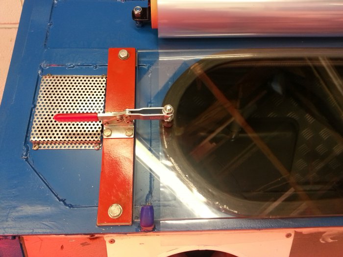

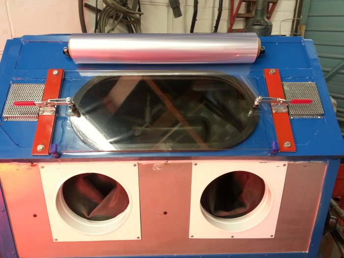

For ages now i've been thinking of a better way of protecting the glass on my blast cabinet. i could get plastic sheet from work that they threw away but that's finnished now. i bought a roll of clear plastic and cut it into pieces to fit under the glass but i got a better idea now all i do is open the two clamps to loosen the glass pull the plastic through to give me a new clear piece of sheet then clamp the glass back down and cut the bad bit off. changing the sheet now takes about 30 seconds. hard to see but the plastic is under the glass. the mesh under the clamps are vents to let air in there are gauze under the mesh to let air in but not let the media out
