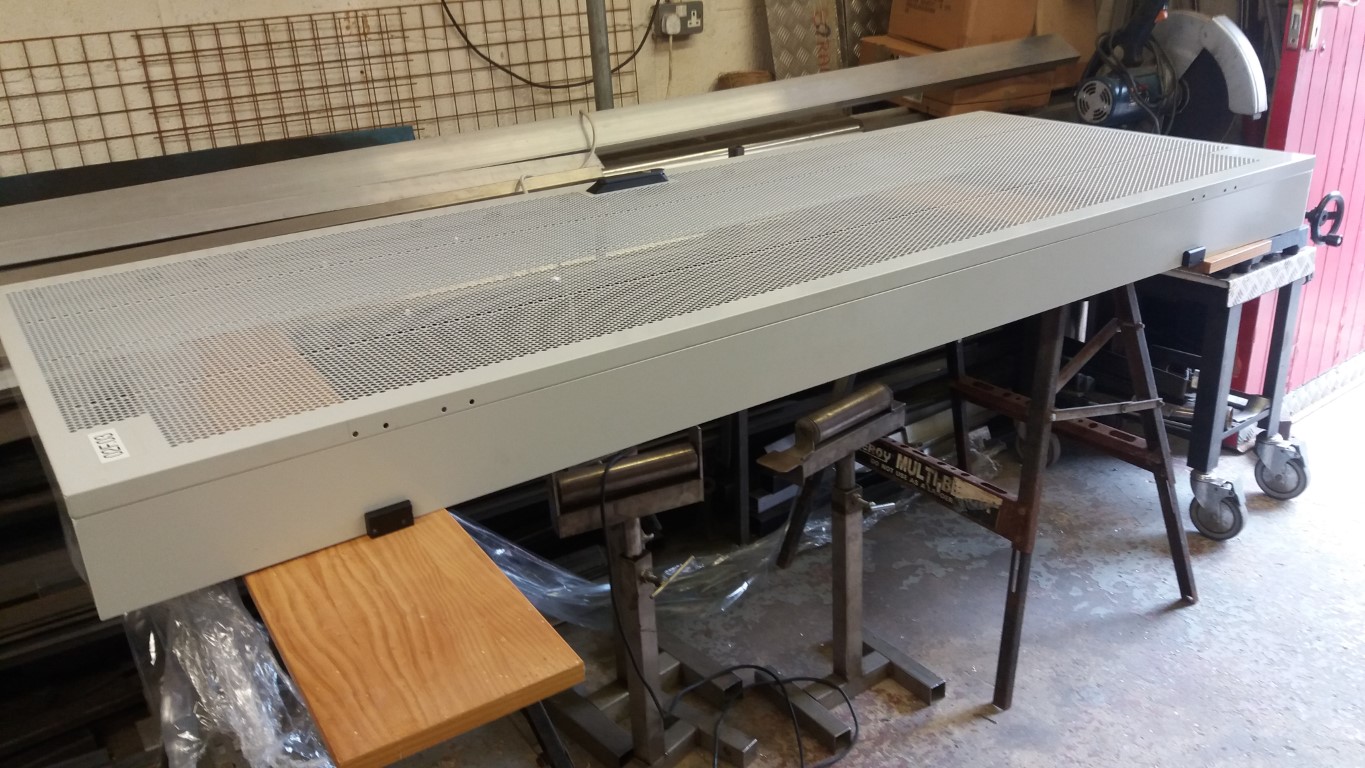

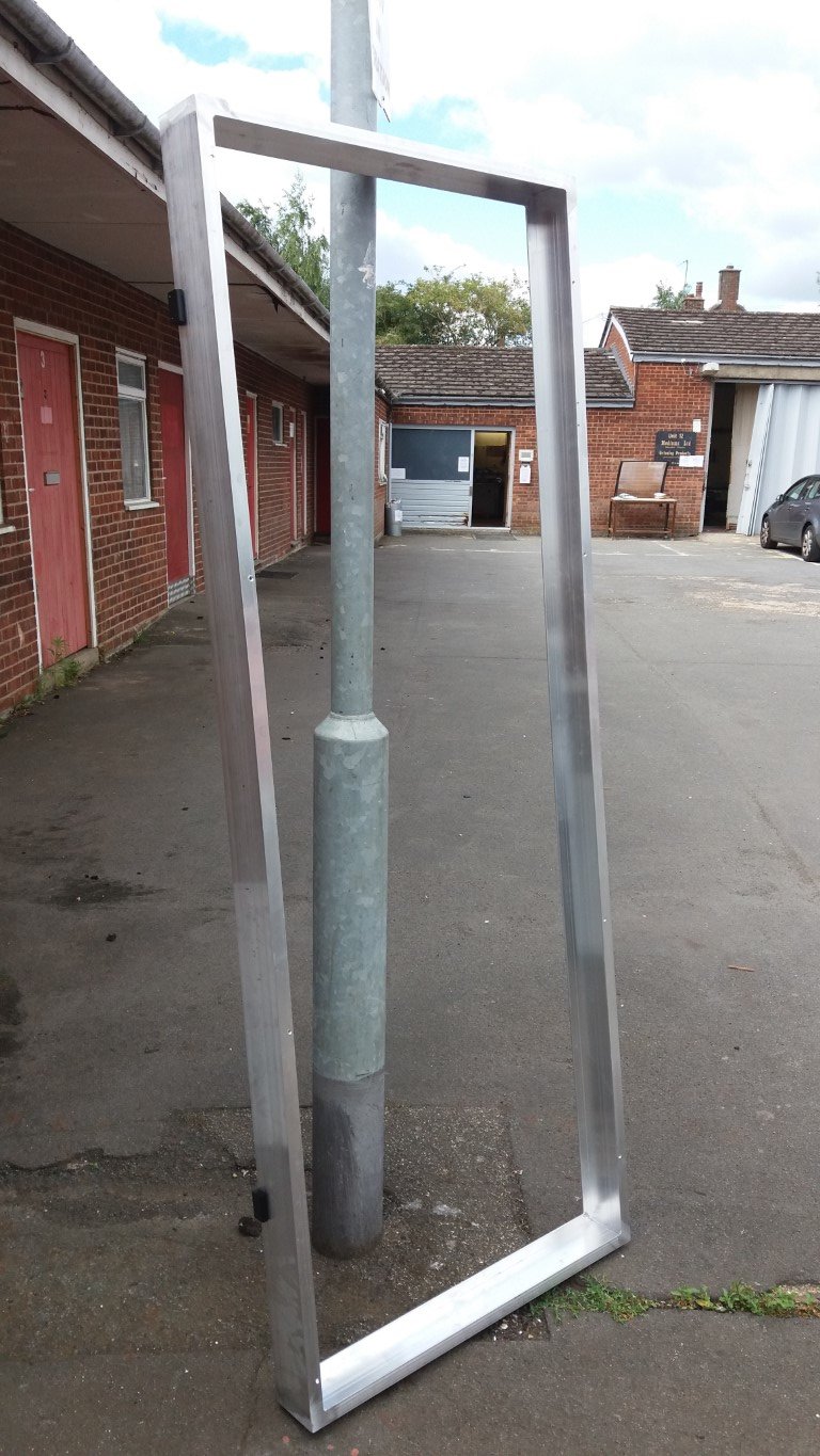

Little job finished today, this is a door from one of those cable networking cabinet thingies, trouble is the gear in the cabinet is standing proud and the door don't shut,

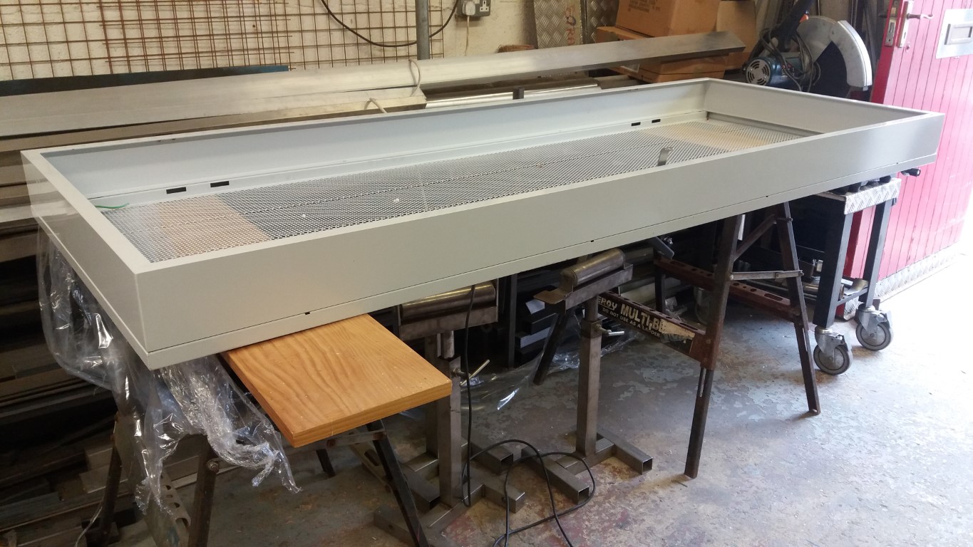

So I was asked to extend the door by 4", so knocked up a frame from 4" x 1" aluminium channel

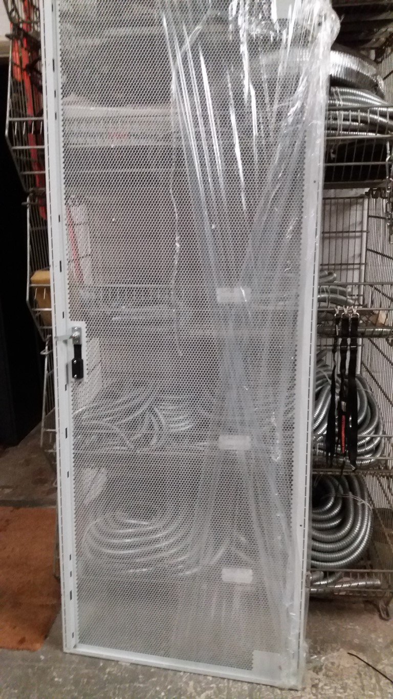

Test fitting,

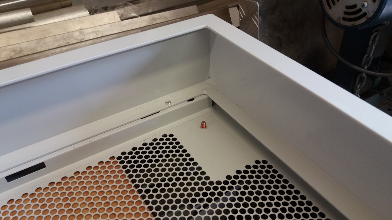

Then after a trip to the powder coaters it looks a lot better, had to make an extended door latch too, you can just see it peeping over the edge here.

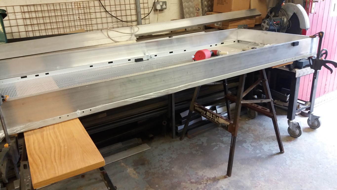

Just held on with ally pop rivets
And a view from the front,
