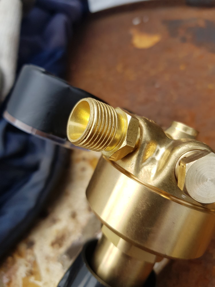

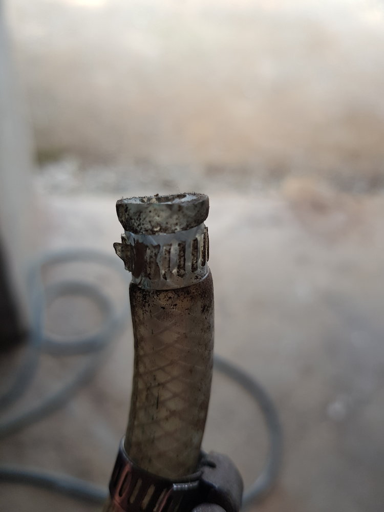

Hello all. Been using c02 for ages and yesterday bought ardonshield from hobbyweld. Can go for 2 months and do nothing so thought hobbyweld was best option.
Can I use the c02 regulator and what rate should it be set at.

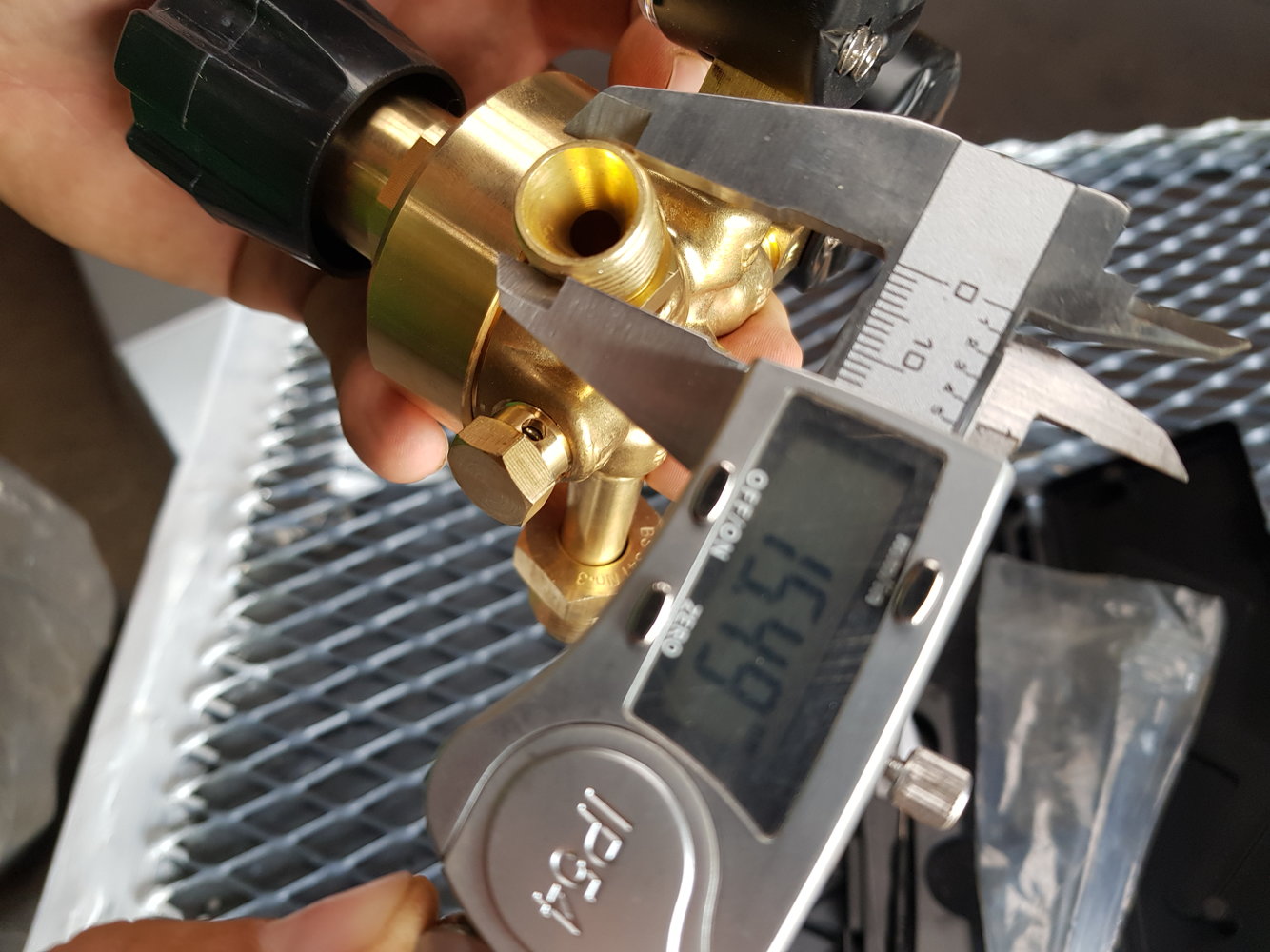

You could use the C02 regulator, but the fitting to the argon-mix bottle is different. Instead of a female loose nut, you need a male bullnose fitting. Adapters are available:
Check the max working pressure of the regulator to make sure it is suitable for the higher pressure in your argoshield cylinder. I would not have thought you could use it
If your caliper tips are showing 15.49mm in the threads, then the OD of the threads could be 16.66mm, which would make the fitting 3/8" BSP. In that case, you would need a female 3/8" nut and a cone swivel 1/4 inch ( 6.5mm ) hose tail, price £3.79:
Brass Hosetails. 60o Cone male End with Swivel Nut x Hose Tail. BSP THREAD DATA. Female BSPP To Hosetail. a more versatile hosetail allowing the tail to spin if needed. high quality Fittings. Ideal fitting for any application especially pneumatic but can be used with water etc.
